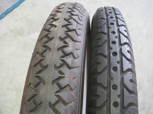

Old Samson tire (on right) in true 30 x 3 1/2" compared to what you have today :(
IMG_1114 (500x375).jpg (87.67 KiB) Viewed 5799 times

Dunlop Cord chevron tread 30 x 3.5 tires are true, thirty inch tires. If you've ever seen them on a Model T, they look great.
Unfortunately, Dunlop quit producing antique car tires a few years ago but the molds were purchased by another company who produces tires under the Ensign brand name.
I don't know if Ensign brand 30 x 3.5 tires have yet to be produced, but it may be worth looking into. They are currently producing other sizes of clincher tires with the chevron tread that are identical to their Dunlop predecessors. Otherwise, you might be able to locate an NOS set of Dunlops.
The Universal ribbed 30 x 3.5 tires are slightly over 30 inches. You may also want to look into getting a set of those.
I posted a photo of oversize next to true 30 inch tires a while back. See this post which also mentions the Universal ribbed tires:
http://www.mtfca.com/discus/messages/50 ... 1439427044
