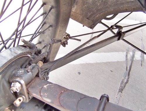

The levers on the backing plate were upright from 1908 to 1927, don't matter what kind of wheel was installed. Without backup evidence such as letters or photographs from Ford production line from the 1926/27 era, that opinion only serves to confuse the issue and question?

directing the levers down on wire wheels will do a good job if your aim is to have brake rods/cables criss-crossing parking brake rods and hang low enough to snag weeds and stray cats
Photo courtesy of Dan Treace:

It sure is nice to see someone with outside brakes using the correct cable set up!
