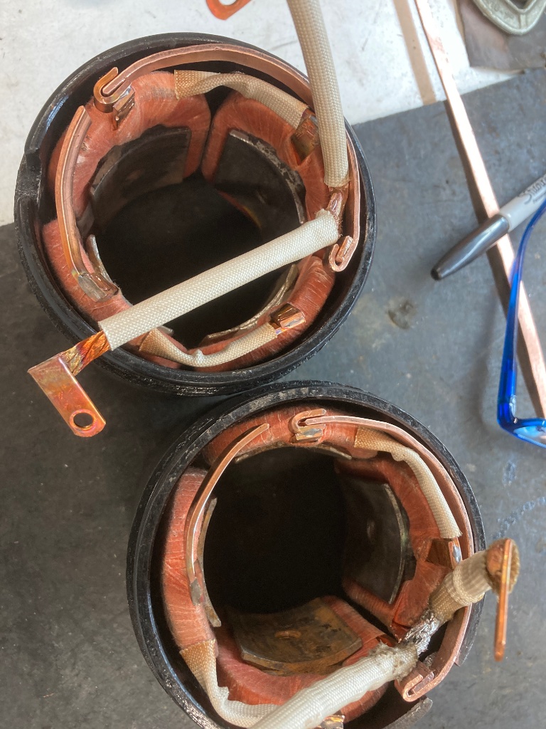

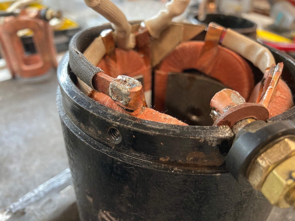

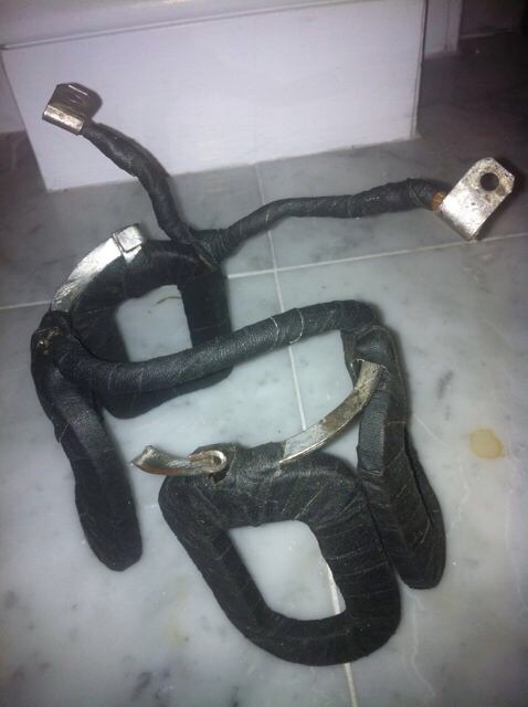

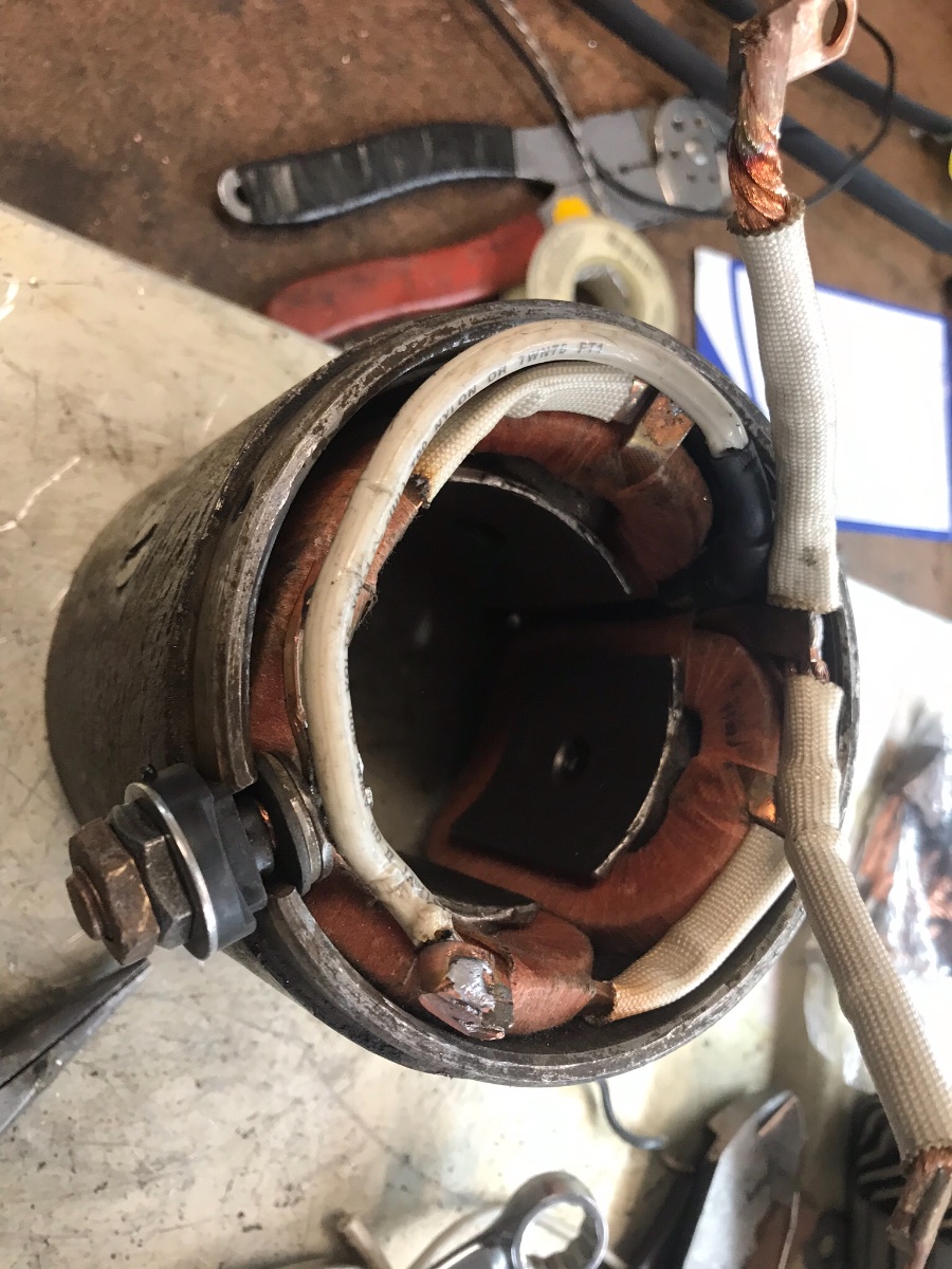

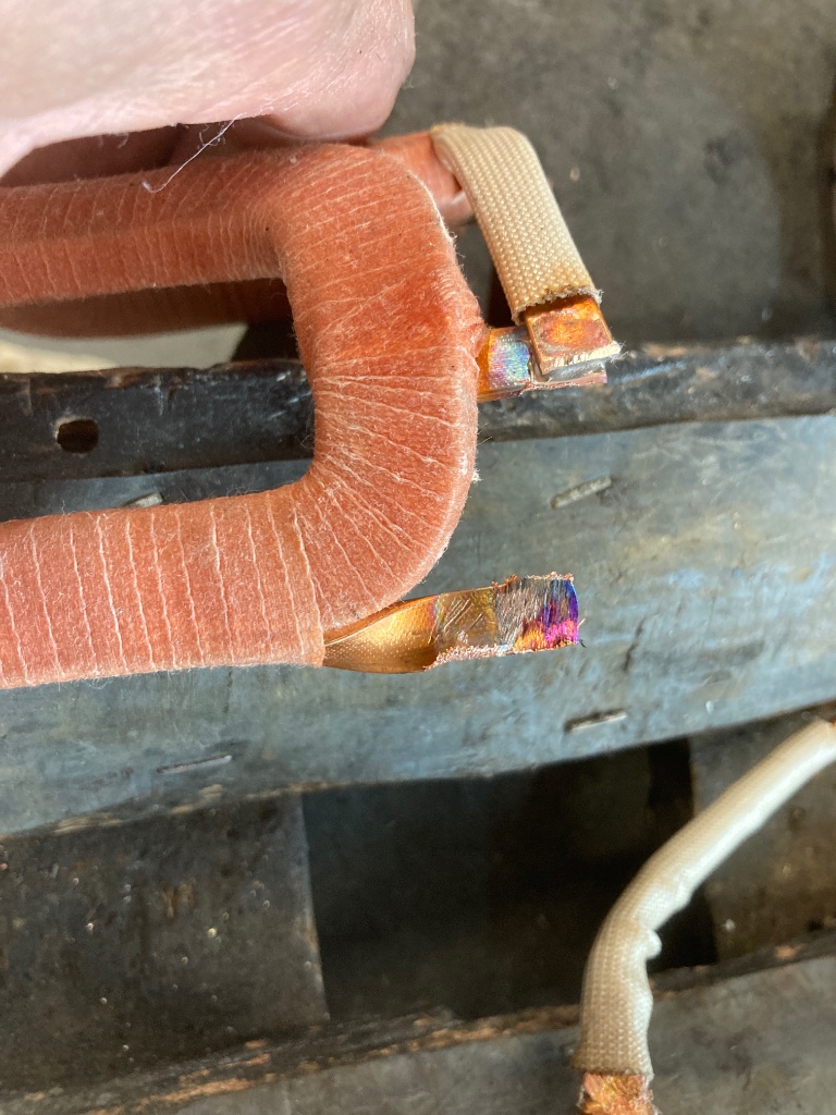

Sure. First off, the stock T generator, properly rebuilt and adjusted with a fun projects (or equivalent) 12v regulator will charge a 12v battery. It puts out plenty of voltage and current for the job.
The starter is another story. Put 12v on it and it slams the bendix into the ring gear with a lot of extra force. While plenty of folks have made the case that "I've run my T that way with no issues for years", luck has clearly been on their side. Simple physics and electronics math (V=IR, and P=VI) tells you this this is a recipe for electrical and mechanical disaster over time. It not only puts a lot more stress on the bendix, it puts twice the current through the brushes, armature, wires, field coils, etc. The big losers being the armature commutator and brushes. The field coils can take it, the other components not so much. Sure it'll work for a while, but all additional stress on the listed components will shorten their service life significantly.
So, the solution is to rewire the starter field coils. Stock they are wired in parallel. The 12v conversion wires them in series. Using the equation P=VI,(power equals volts times current) you get half the current when you do that. Thus, when wired in series you essentially get the same stress on all components as if running 6v. This sounds easy, but as I've discovered doing a few of these conversions now, it's a royal pain in the a$$. A LARGE soldering iron, big wire, good insulators, silver based solder and oodles of patience are all necessary to do it right. You also have to get the polarity/magnetism of the poles right on each field coil or nothing works.
I've included a few shots below. The old, used, rewrapped coils ultimately shorted against the housing, but they proved to be a good training and learning ground as this conversion has been attempted by many folks. Some successful, others not so much. After doing this conversion several times now, I've since decided I won't do it unless I start with a new set of field coils. Even when rewrapping the old ones, there's just too much at stake with respect to shorts, so New field coils is the only way to go.
Steve Tomaso just got my last 12v conversation and I don't think he'd mind my quoting him "Starter rolled in yesterday - nice job, my friend ! Very nice job on the brass snout bushing - fits a Bendix drive like a high end leather glove !"

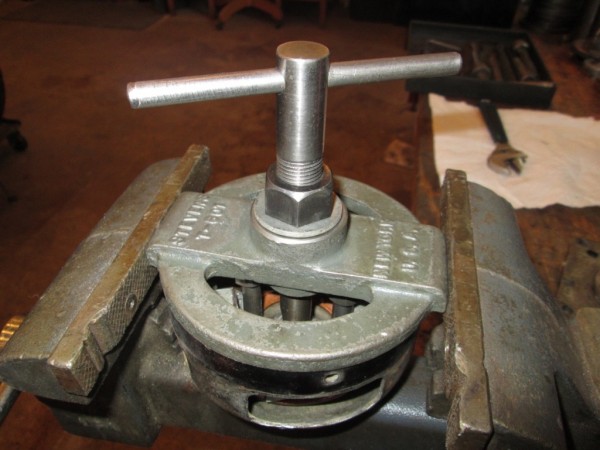

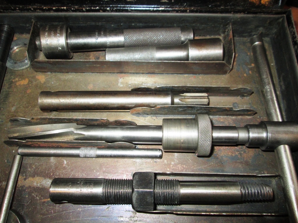

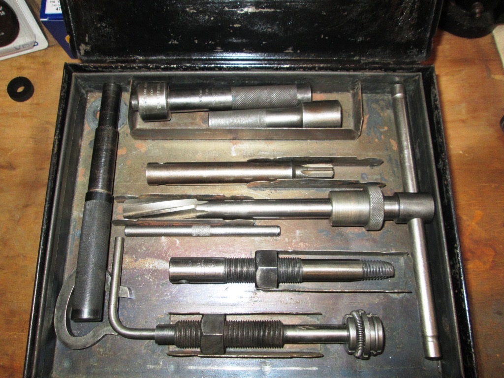

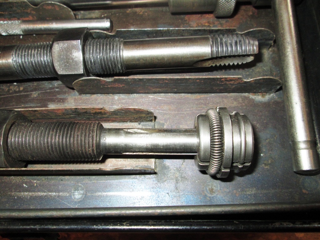

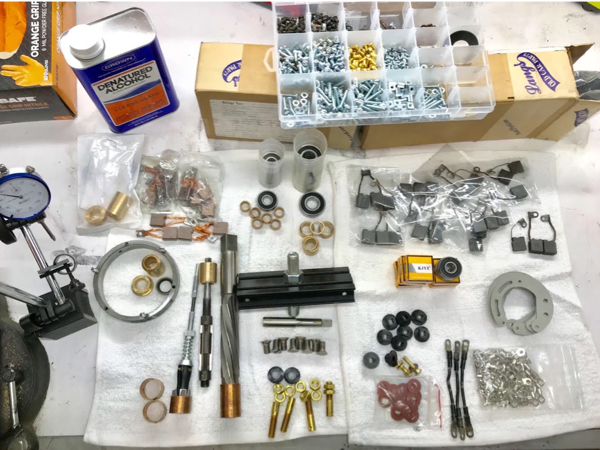

Thanks Hank! Starters are tricky! Lots of things can bite you, especially when doing all the bushings.

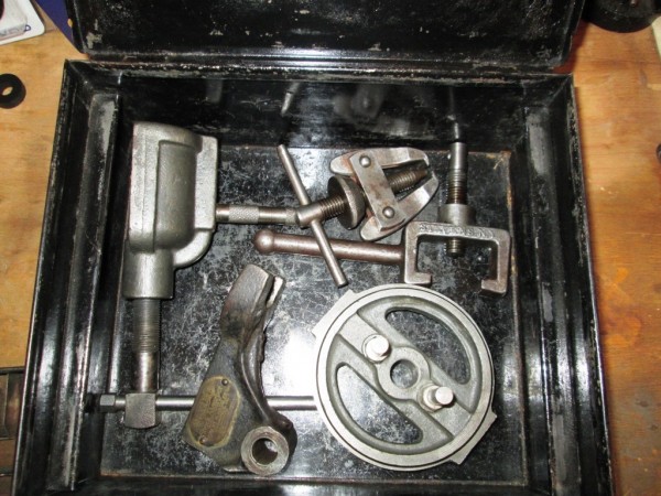

Here’s all my tooling I’ve come up with. I’m not fortunate like Steve Tomaso to have the complete Stevens starter & Generator rebuild kit. Trial and error and lots of reading/studying landed me here.
Tomaso sent me pics of his Stevens kit. I drool over this every day... I think I’ll break this thread off into the general forum. Lots to unpack here...

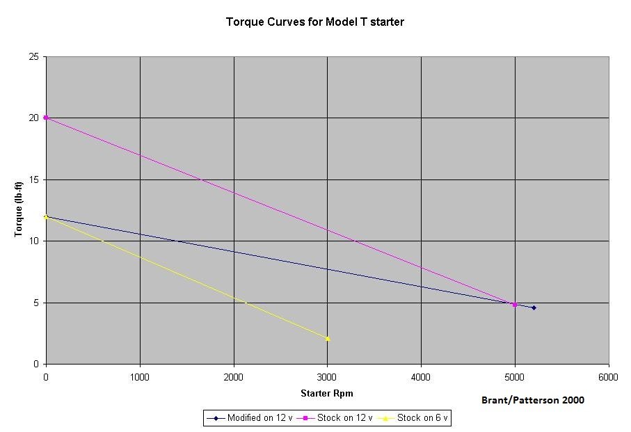

Many years ago Chuck Brant and I conducted some instrumented tests to ascertain the operational characteristics of 1.) original Model T starters operating on six volts, 2.) six volt starters running on twelve volts and a six volt starter with the field windings rewired from series/parallel to full series.
Here is a chart depicting the results of those tests for of all three starters.

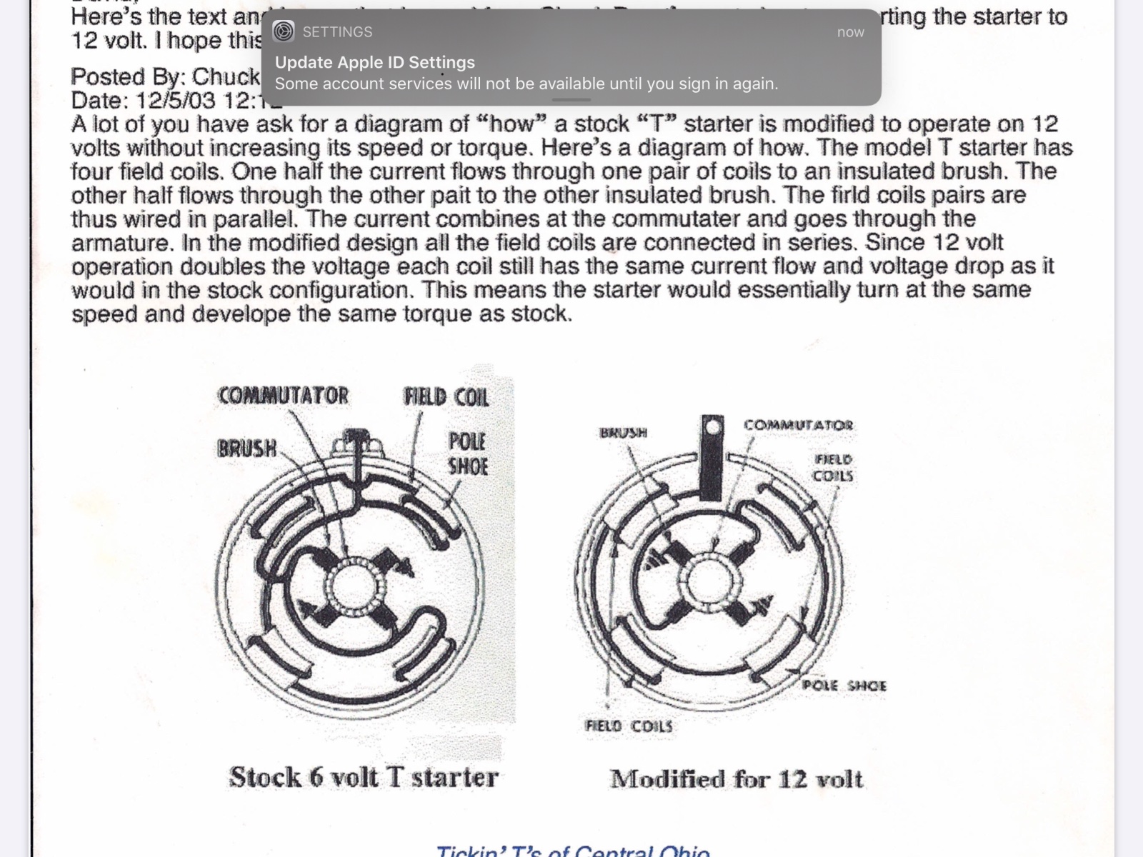

There are four coils in a Model T starter. If we assume each is 0.1 ohm and wired as two in series and then the pair in parallel, the resistance is surprise —- 0.1 ohm.
Now if we wire all four in series the resistance is 0.4 ohm Everyone following so far?
Ok if we supply nominal 6 volts to 0.1 ohm the resulting current is 60 amps and the power 360 watts
So let’s apply 12 volts to 0.4 ohm, the current is now only 30 amps yet the power is still 360watts
So the current is halved, any resulting power drops to get there are halved yet we have twice the starting voltage. Much more reliable operation with exactly the same power
I leave to the student to apply 12 volts to a six volt starter and why it’s not recommended.....

Ron, absolutely Awesome, you are the renowned "expert" here for sure! You also just saved me from building a starter Dyno! And those are the approx results I would have expected, although it's really interesting how the graph diverges on rpm VS torque on the 12v series wired conversion graph. It explains why the 12v conversions spin so fast when powered up.
I'm really curious, What instrument/method did you use to measure the torque on the starters?

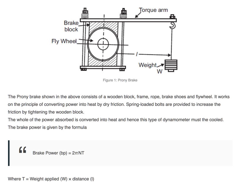

Chuck made a simple instrumented Prony Brake to take the starter measurements on the chart i posted.
But my wife demands to use her hair dryer, and she has long flowing hair... oh well..
More GREAT info Ron, now memorialized here for all to learn from.
I was introduced to Prony Brakes in my one required Mechanical Engineering class when I got my EE degree. Too bad I had a major hangover that day and slept through it... I did go to Chico State afterall...

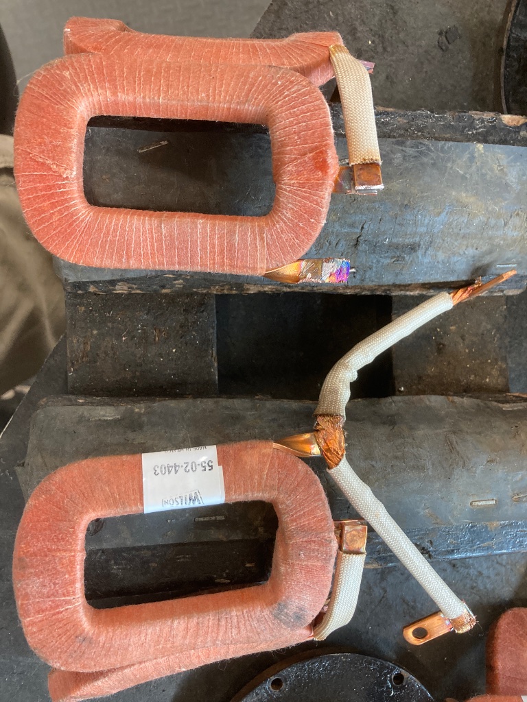

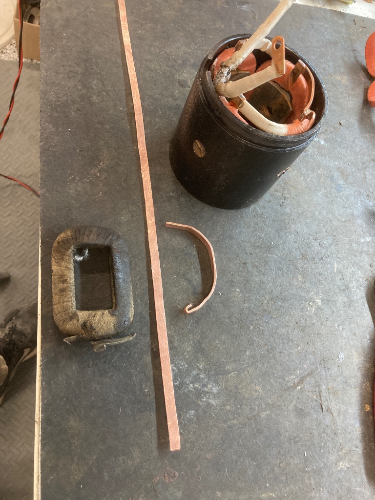

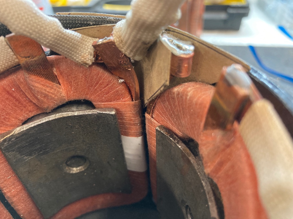

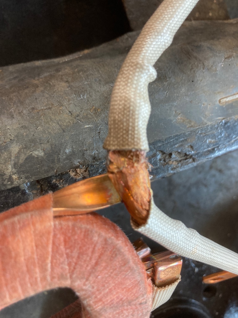

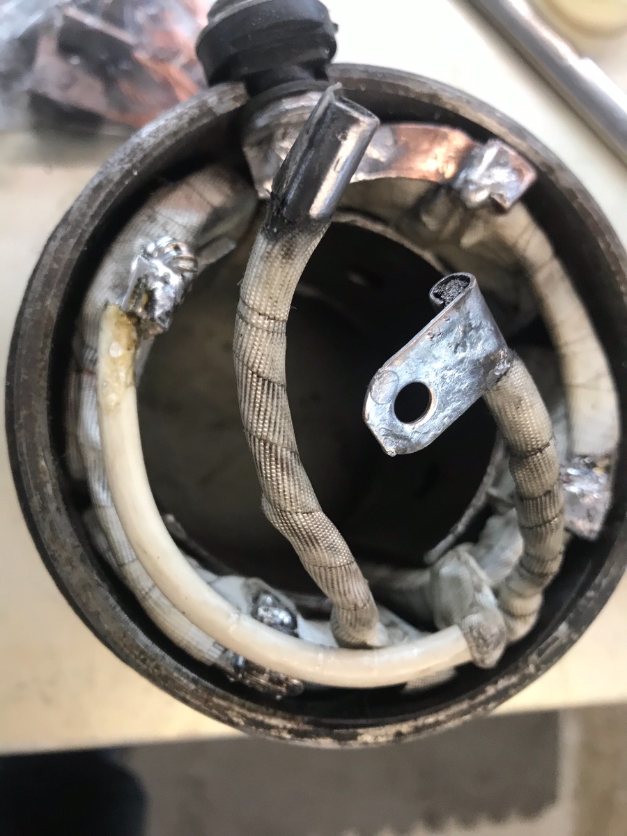

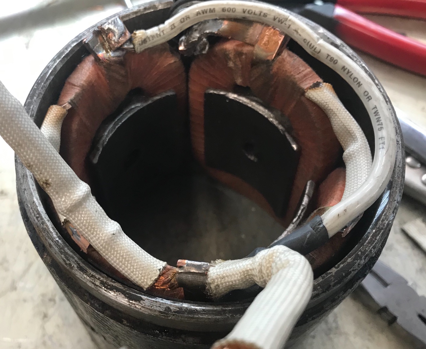

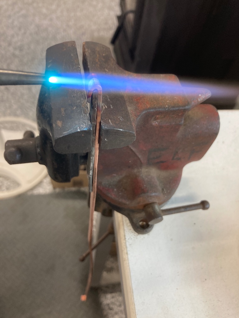

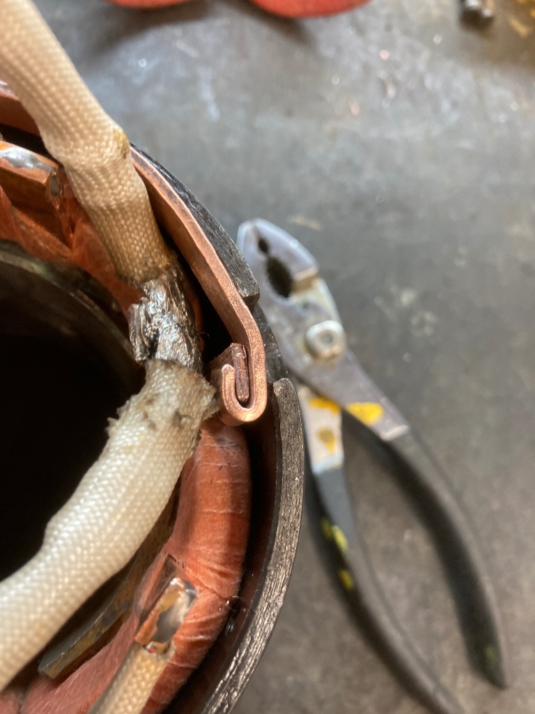

Updated 12v conversion process.

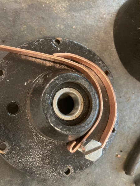

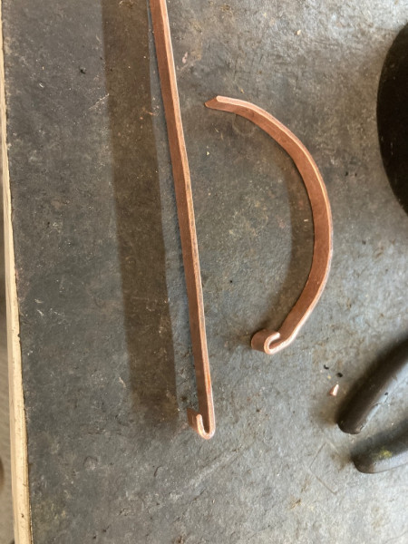

I recently got a tip from Another forum member on 12v starter conversions. Instead of large gauge wire making the jumper between coils, he used the copper from a old starter coil. I've done several conversions using this technique and can report it is by far the best method I've used, bar none.
A couple of tricks make this a solid solution. I ALWAYS use new field coils when rebuilding starters. It's about the harshest environment you can imagine and old field coils just don't cut it as I offer a 1 year warranty on my starters and I don't like fixing broke. Use old field coils at your own risk.
Separate the new field coils at the middle. Carefully remove the field wires from one of the coil halves. This is not easy and takes some finesse. I use 2 good quality needle nose vice grips and harsh language. The harsher the language, the better the results.
It matters which one keeps the wires... look closely.
Unwrap and clean enough copper from an old coil. 6-8" is good. It needs to be completely straightened, and then polished clean.
Bend one of the ends using heat and another piece of copper as a template gauge.
Bend the copper into the general circle form. I use a generator end housing.
Fit the piece to the starter coils.
That's the hardest part, and takes the most time. It's tedious, and you have to be patient when fitting the copper.
Next, I use some fiberglass wire heat shield and cover the exposed copper with it.
Then I silver solder both ends in place.
The final piece is to use fiberglass impregnated gasket material to insulate the conductors so the6 don't short out. You could probably get away with wrapping it with fiberglass cloth tape as well. NOT electrical tape. Starters see oil. Electrical tape disintegrates when exposed to oil.
And that's it! Countless hours went into perfecting this process, but I feel that if folks want to attempt it on their own, have at it... we have to pass on the knowledge. This adds several hours to an already tedious starter rebuild process, but done correctly, it should last as long as rebuilt 6v starters.
If you don't want to attempt this yourself, I have one left!
viewtopic.php?f=5&t=19794
Jeff

Six volts will turn the motor over but it won't spin it like 12 volts. But no need to with a engine designed to be hand cranked in the first place.
With six volts there is NO margin for error with loose. poor or corroded connections and terminal lugs. Wires must be heavy duty of the proper gauge and no longer than need be. every inch of excessive cable length robs starter power. "Bigger is better" some times power cables in our hand me down cars have been replaced with lighter gauge 12 volt cables which have excessive voltage drop causing the starter to turn slower with less power. good. cheap 6 volt led headlight and tail lights bulbs are available. But like Steve said 12 volt Leds are plentiful and the supply won't dry up.
Posts: 8667
Re: 6v to 12v model T starter conversion
Post by TXGOAT2 » Tue Aug 09, 2022 1:11 pm
As pointed out, wattage (volts X amps) is power to do work, such as cranking an engine. A T generator can produce about 100 watts continuously. A 6 volt T starter in good conditon can consume about 1500 to 1800 watts for 15 seconds or so. A 12 volt starter doing the same work would consume about the same wattage. A 6 volt system, all else being equal, will require heavier gauge conductors throughout than a 12 volt system designed to perform the same work. Most 6 volt systems had the battery located under the floorboard near the starter, probably to limit the cable length.

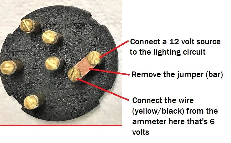

You can have your 6volts and run 12 volt LED's too, by simply removing the jumper on the back of the ignition switch that connects the BAT power to the coil and the BAT to the lighting circuits. Using a deep charging motorcycle/lawn care/sport battery as a 12 volt source with about enough Ah for your needs. So if you LED light draw 3 amps and you have a 30Ah battery that's about just under 10hours of use (30/3) - 9Ah (9/3 - 3hrs). These batteries are very small. Deep charging batteries can be recharge many times - just get a battery tender or solar charger when on tour.
If you don't have a starter you can leave the jumper in, the buzz coils will run on 12 volts too but distributor coils need to match their voltage

Thanks for sharing all of the details and tricks for the converting from 6 v to 12 v. I thought about converting to 12 volts until I cleaned all connections, switch, and the starter. The starter was saturated with engine oil. This happened because I thought more engine oil is better. Now I keep the level at the recommended level.
The wire diagram as shown above must be closely followed in order to provide the proper coil magnet polarity. The wiring looks fairly easy but I don't think is. I have no reason to find out.
Art Mirtes
Yes, extremely important or failure is in your future.
