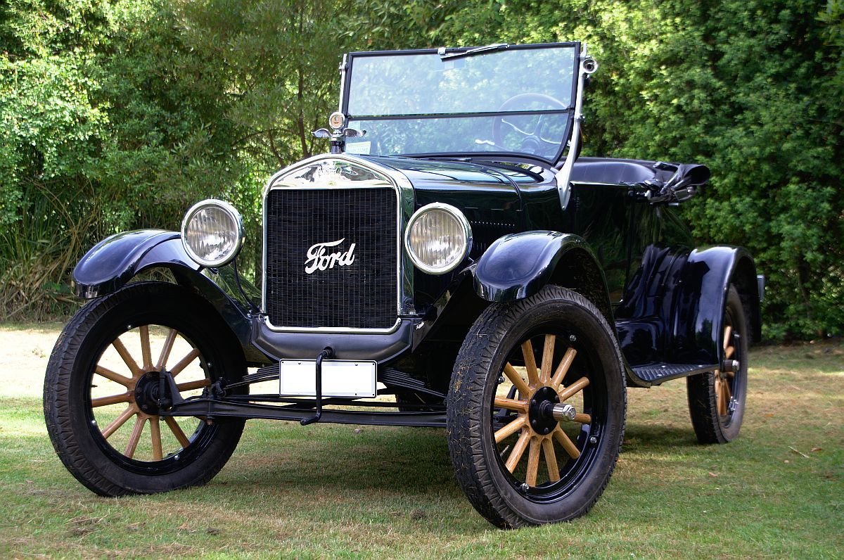

I have '26 (well, maybe it's a '26) 'New Beauty' runabout. It was imported into this country from Douglas County, GA, somewhere between 2011-2013.
Having looked it up I see the motor was manufactured somewhere in March/April 1925. Unfortunately I'm unable to find any chassis number to assist with dating the car itself, but from the info in Scott's thread I take it to be an early one because it doesn't have the headlamp cross bar etc.
While I'm aware that in the intervening 94 or so years the motor, and even chassis, could have been changed out I'd still like to know as much about the origin of the vehicle as possible. I'd asked previously to no avail but just in case there's anyone in or around Douglas County that could perhaps make a couple of enquiries for me I'd really appreciate hearing from you. Being many thousands of miles distant makes things a bit difficult - I do have the name of the previous US owner if that helps.
Anyway, back to where I was heading; if this is a '1926', what could be the earliest possible actual date of manufacture? Is there any way it could have had the present motor in it from new?

Your photo shows a 1926-27 Improved model. I can see the 26-27 style fenders and windshield frame in the photo. The Improved models start August 1925. Your engine date will be an "early" 1926 model. There was no serial numbers on the frames till Dec 12, 1925. There are several details that are unique to the "early" models.
Some of the early details are, headlights with no bar, aluminum step plates, small holes on inside of doors. Aluminum grommet on side curtain rod hole in top of door, 4 small rivets in firewall for gas tank pad. These are just some of the early details.

A question - Are the brighy plated windshield posts accurate? I don't remember seeing those on a later Model T.

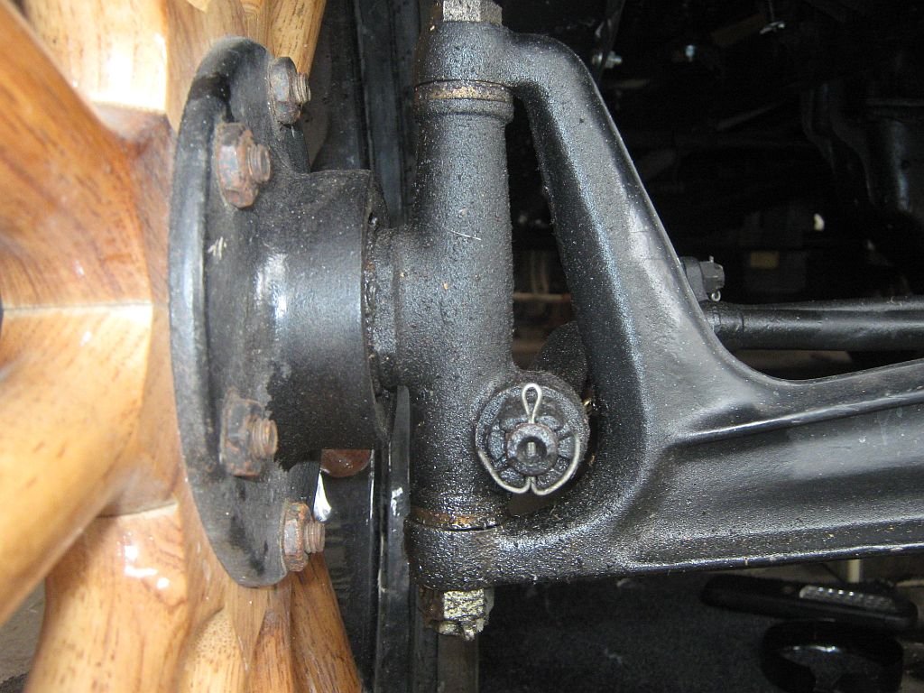

Luke, It would appear that your car does not have the later front spindles, I've heard that the very early improved cars came that way. In the picture the gray one is the improved lowered one. Jim

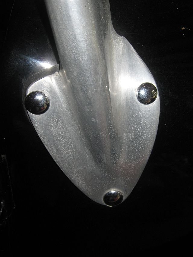

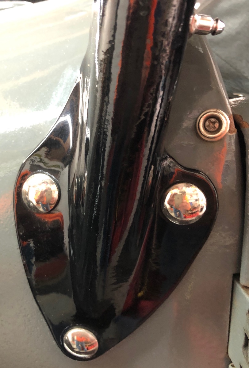

given the stalk headlights, which were an early '26 feature, you may ultimately find that the windshield stantions are completely unique. They were changed for the '26 year (in late '25) and then were quickly abandoned for even heavier versions which carried through the '26 year and on through '27.
If you compare yours to another improved car and find that the base of your stantions where attached to the body, appears slightly different though stylistically similar, that is the reason.

Gosh, thanks everyone for your help - it's certainly given me a bit to go on!
Dan & Larry, I'll attach a couple of photos below, from your information it seems to me that the motor may not be original as it doesn't appear to have the boss, also it doesn't have the wider brake band so I guess it means the trans is not likely to be original either?

Jim, here's a closeup of the RHS spindle. Guess you're right.
John C & Scott, I'm not certain that the windscreen stanchions are original. They appear to me to be in remarkable condition, not sure if anyone produces repro items but it's possible they could be new. Unfortunately there's no other U.S. produced model here that I'm aware of - they're generally all Canadian, being RHD, so not sure if I can compare directly?

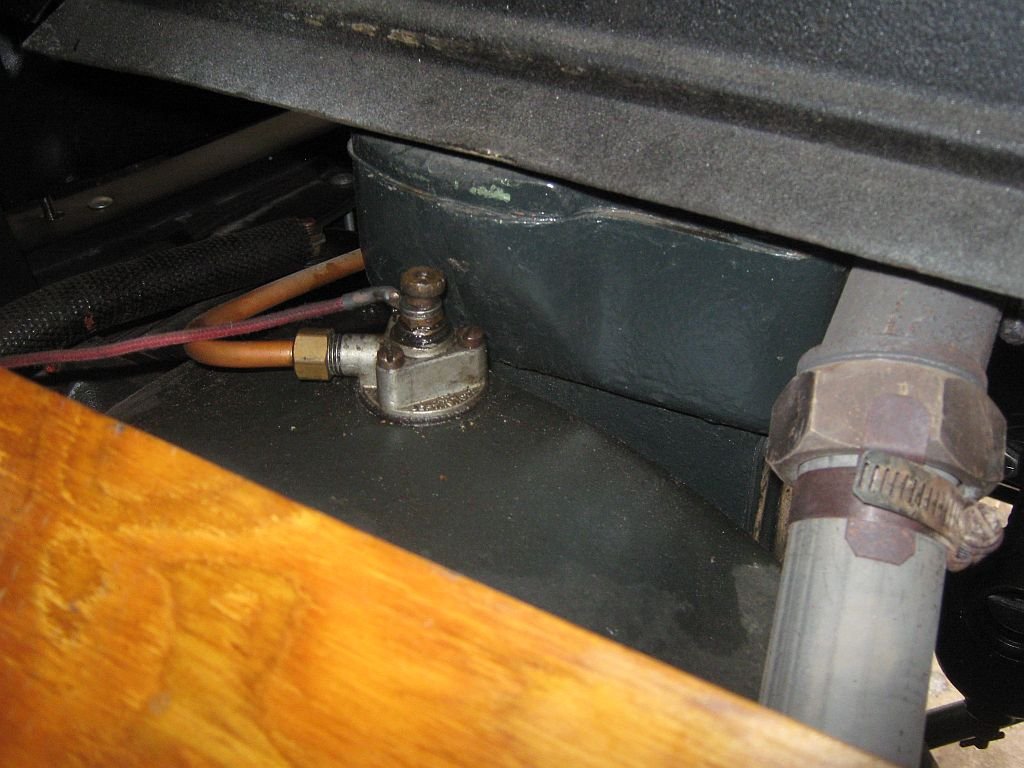

I have a friend who has a very early improved 1926 Tudor. His firewall has the holes for a firewall mounted coil box with very old and hard rubber plugs in them. His actual coil box is in the correct location.

Stanchions are made reproduction, but not in the early 26 style as photo shows.

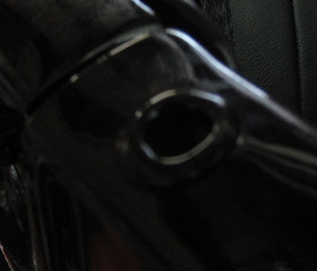

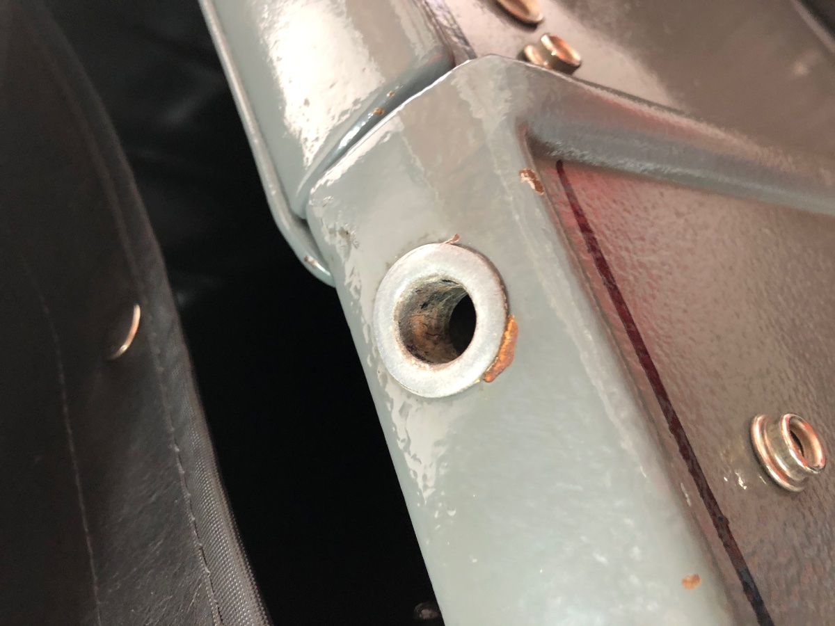

Early 26 has these grommets if zinc around the curtain rod holed on the upper door frame.

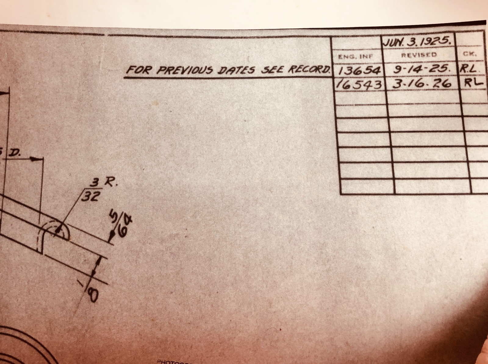

Dan, my matching numbers Roadster has the manufacturing date of late July 1926 and was titled in 27. It has the zinc around the curtain rod hole. I’m guess since it’s a very early 27 production the zinc is correct.

Could be, don’t have the obsolete date on drawing, but likely were gone at start of the 1927 model year. Doors varied on the Improved open cars, several types of inner panels and fasteners and latches.
The print on T-45122X only gives start date and a rev date. The Parts and Body listing says 26-27. so maybe only the later ‘27 when the door panel with raised molding for the rim of the curtain holes were used at assembly plants. Henry doing away with little pieces to keep the Ford America’s lowest price car

I apologise for the quality of the door photo below, but I don't expect it matters much. It looks to me to be similar to yours except my grommet has been painted.

FWIW I had a look at my firewall but it's fairly pristine, so perhaps it's a little later than your friend's car.

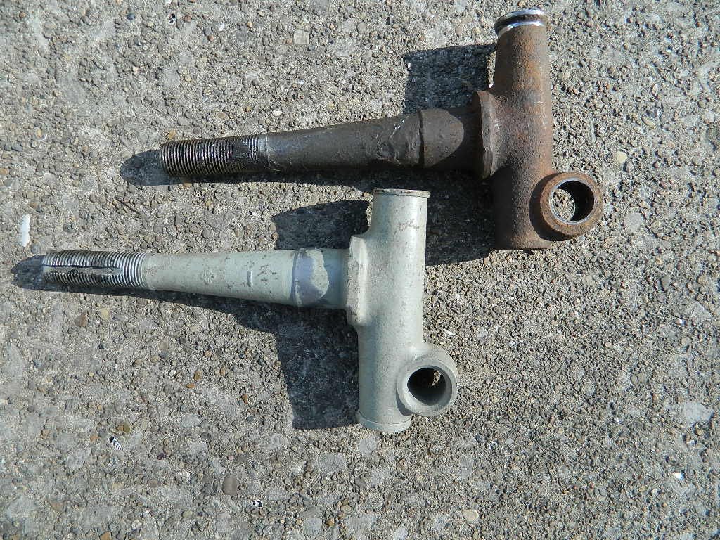

If your front axle doesn't match the model, don't be surprised. My 26 Tudor (early December 1925 build) had an earlier axle too. No, it wasn't factory. After crawling underneath and wiping the grime from the ball socket on the pan, it was pretty obvious at some point in its existence by the amount of brazing on the pan, that the car hit something. With the relative interchangeability of T parts and wide availability of the those parts, it was an easy job to slap a new axle (or engine, or rear end, etc) in a car and keep driving it. Might not be a mix and max "restoration" job at all. Best to determine its year by body style anyways. That's how mine is registered and titled here in WI.
