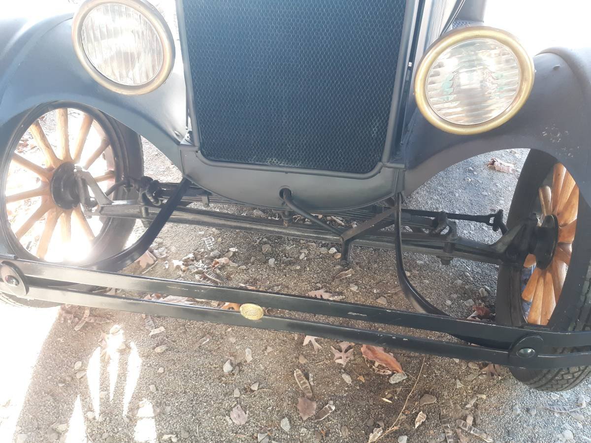

im going to look at some wheels that have new spokes. they were done prior to the current owner. what should i look for
to tell if they are hickory
