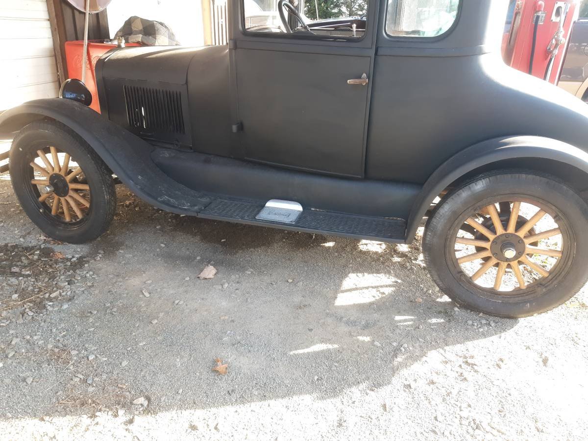

i am looking at some wheels that have have new spokes. the owner is cutting the car up and making a hot rod
sad but hey i need the wheels. anyway the owner before him did the spokes what should i look for to tell if they
are hickory. philip

Would need a close up photo of the spokes to try to identify the wood. meantime, without knowing what wood they are, get a price as if the spokes were no good, because if they are oak, or some softwood, they are NO GOOD no matter how nice they look.

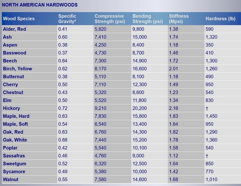

Some data about wood "strength" Hickory, Yellow Birch, Hard Maple, White Oak then Ash
Compressive strength tells you how much of a load a wood species can withstand parallel to the grain. How much weight will the legs of a table support before they buckle? It is measure by loading a block of wood parallel to the grain until it breaks.
Bending strength (also known as the modulus of rupture) shows the load the wood can withstand perpendicular to the grain. How much weight can you hang on a peg? It is measure by loading a block of wood perpendicular to the grain.
Stiffness or modulus of elasticity indicates how much the wood will deflect when a load is applied perpendicular to the grain. How far will those shelves sag? It is determined by applying a load to a beam of wood until it deflects a certain amount.
Hardness reveals how resistant the surface of the wood is to scratches, dents, and other abuse. It is determined by driving a metal ball halfway into the wood’s surface. The force used is recorded in pounds (lb); the higher the number, the stronger the wood.

From the table, Red oak and White oak have 71% and 75% the bending strength, respectively, of Hickory. Bending is the limiting strength in the kind of failure altair describes. Not a guarantee that Hickory would take that abuse but it would handle 25-29% more than Oak. jb
