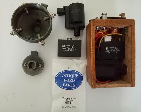

I have been experimenting with Model T ignition systems, and am currently trialling coil boxes of my own making.
I have used Australian Silky Oak for the timber boxes.
I have used modern components except for the capacitor on the internals. The ignition coil is from an Australian Ford Falcon BA series. The letters and numbers for it are VDO A2C59513771 3618M.
The coil capacitor letters and numbers are SH-CAP 10uF 400V 50/60Hz
The points capacitor is one supplied by Snyders.
The magnetic post is one I have wound myself.
So far I have probably driven approx. 150 miles. I am doing a longer run with the vehicle at the end of the month and so that should give me a fairer indication of its reliability. So far they have been trouble free, on both battery and magneto ignition.
The timer shown in the picture is one I made a few years ago, as a copy of an original Teisch timer.

UPDATE
On 7 February I posted information and image of coils I built with modern components, and I indicated then that I would report back once they had been tested.
This month we completed a 1700 mile trip (2750 km) in 10 days and I happily report that they never missed a beat. They will continue to be used, and our two other T's now run the same coils.

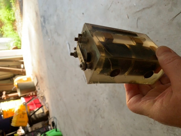

What about this plastic coil?

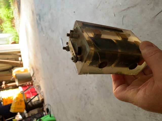

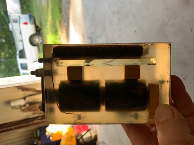

Re: Plastic vs. Wood Coils
Any one know story of this coil? I have had it a long time. Do not know the history. School science? Looks too well done to be a homemade. Thanks Dan
