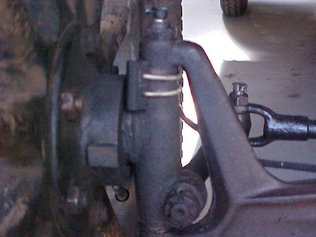

Tried it. I used magnet that is used for a security system. They a meant to attach under a window sash and close circuit until the sash is raised and therefore opening the circuit and setting the alarm. These magnets a very strong and very small so attaching to the wheel spoke was easy. The speedo worked sometimes but not very accurate. I believe the mag interfered and caused the reading to be unreliable. Gave up and use GPS when needed.

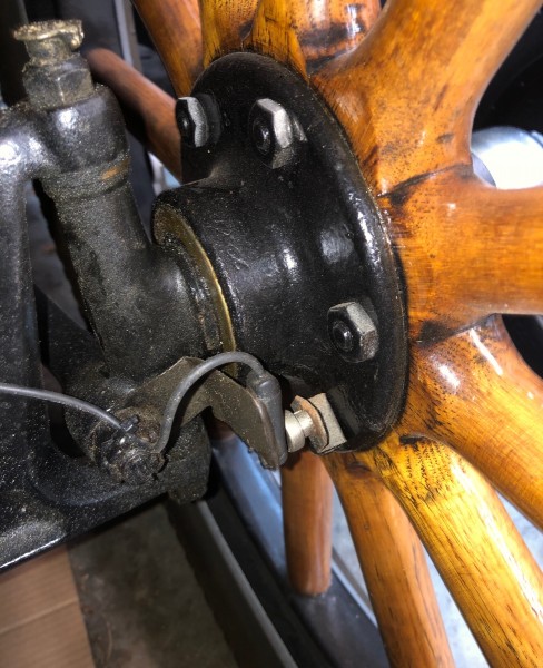

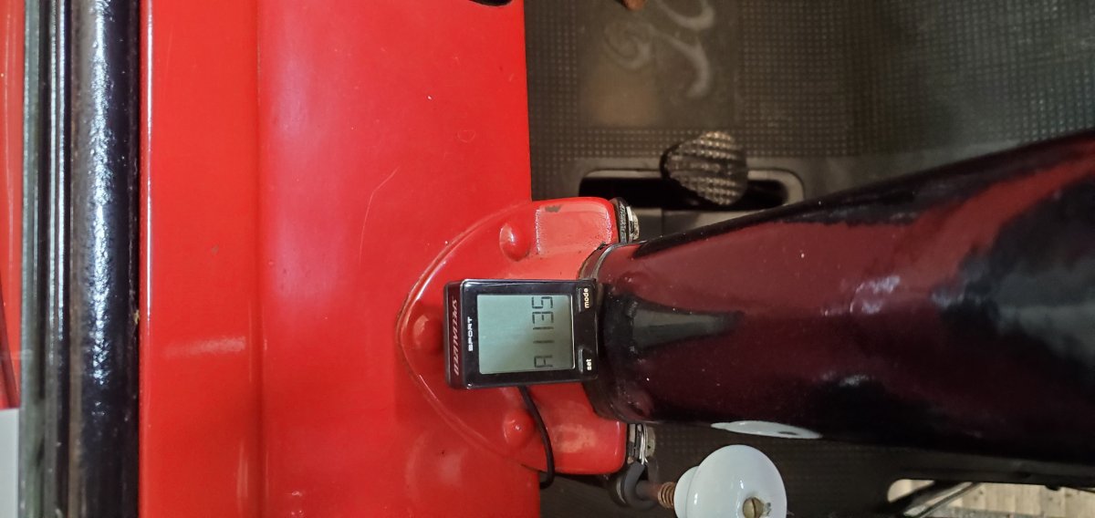

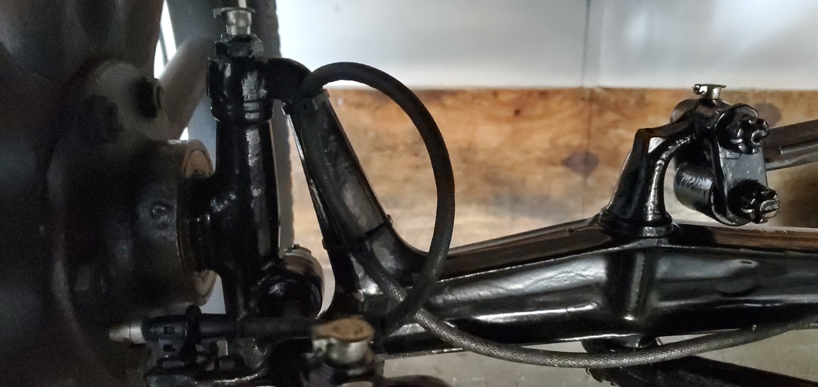

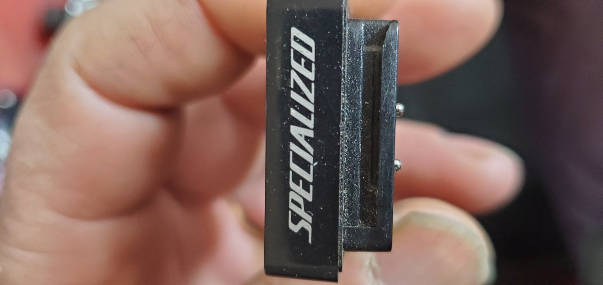

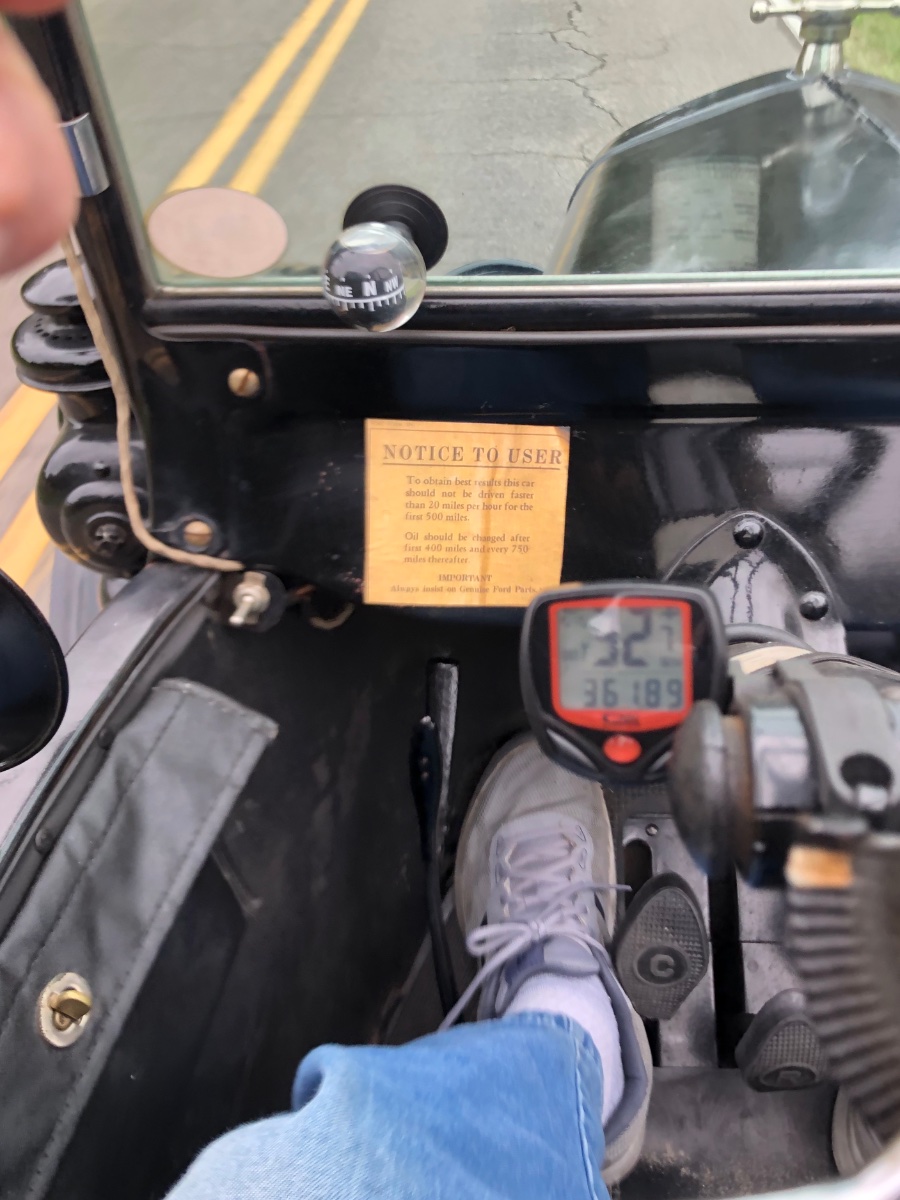

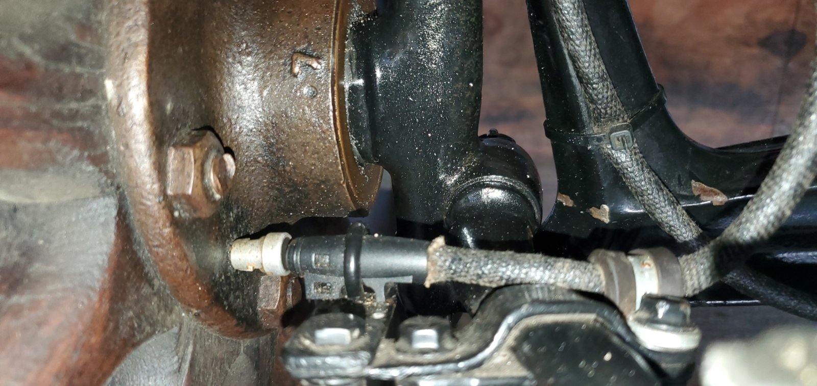

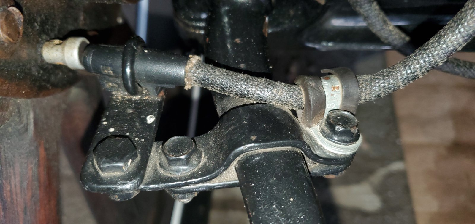

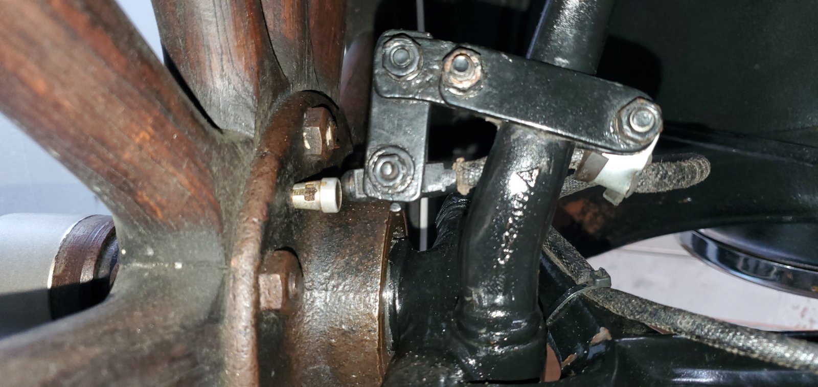

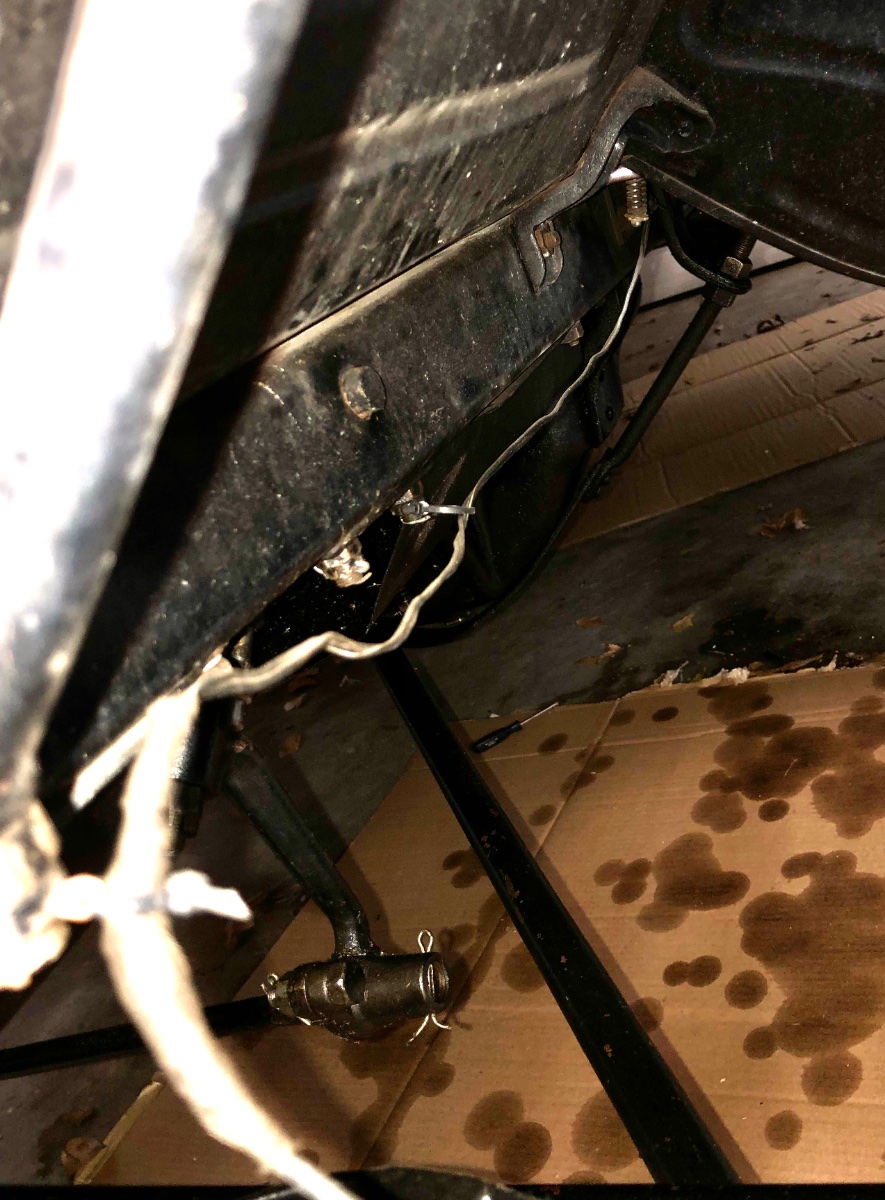

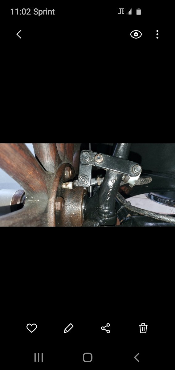

Here are a few pictures of my Install hope it may help someone
Another shop from the top
Here's a shot from the bottom
Here is one from the top
Use black tarred wire loom to protect the wires and sort of make it look like a belongs there
The unit mounted on the steering column
L.I. Tom
Posts: 63
Joined: Thu Jan 10, 2019 10:20 am
First Name: Thomas
Last Name: Pilz
* REQUIRED* Type and Year of Model Ts owned: 1921 roadster, 1923 roadster pickup
Location: Manorville, NewYork
Re: bicycle speedometer
Post by L.I. Tom » Sun Feb 09, 2020 11:24 am
The magnet mounts on a small stud either number 8 or number 10 Idon't recall just drilled and tapped a small hole into the hub and use loctite to attach the magnet and the stud small hole will not hurt the hub just grind it off paint it would never look like it's been there
The brand name and model not sure if they're still available

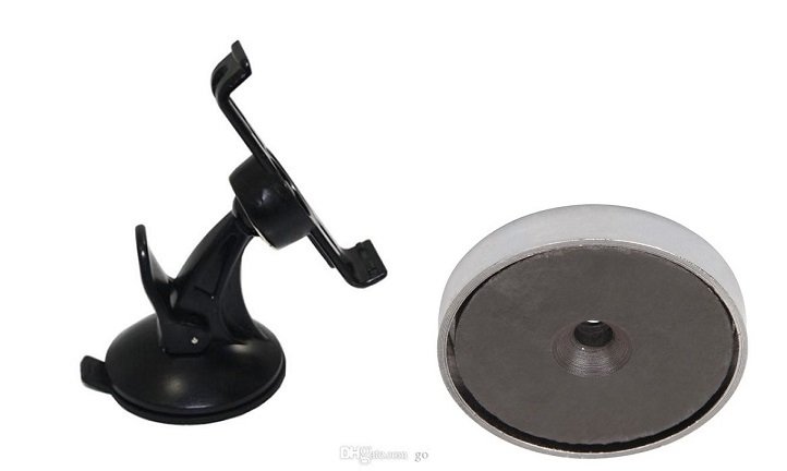

How about something like a universal GPS/phone mount with the suction cup removed and a disk magnet glued to the bottom (piece of felt or something on the bottom to prevent marring the dash). Stick it on the dash. There are many variations of the GPS/phone mount that would accommodate a magnet (round or rectangular).
Posts: 7411
Post by Steve Jelf » Mon Feb 10, 2020 1:16 am
I'm on the road and don't have a picture with me, but I was given a Garmin and simply made a holder for it that mounts with one of the dash bolts on my 1915. You don't have to buy some factory made geegaw. I agree that a suction cup is likely to drop your device on the floor.

With Steve Jelf's inspiration I mounted the sensor in the back as per this discussion and easy instructions: http://www.mtfca.com/discus/messages/70 ... 1498439804
It has worked for a few years now without problems.
-- IV

Had the speedometer die on an old motorcycle and found an early model hand held GPS unit at a garage sale for $15.00. Made a mount to attach it to the handlebars and hard wired it for power and it worked great for a speedometer. With the new style GPS units fabbing a mount would be easy and you get the added bonus of being able to find your way as well.
tdump
Posts: 1430
First Name: Mack
Last Name: Cole
Location: North Carolina
Post by tdump » Tue Feb 11, 2020 9:14 am
Okdoky, I will make or get a mount for the gps. less money! :D And more functions. :)
