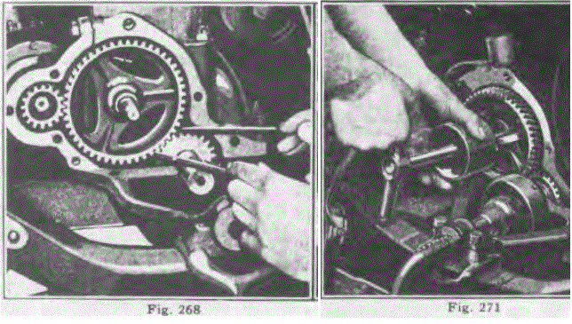

I decided to check, and if need be, clean my oil distribution tube. I’m taking the opportunity to do this while my radiator is out and I wait for my new one. The service manual shows the use of a gear puller to remove the timing gear from the cam. It engages into slots in the gear. I have not taken my timing cover off yet so I don’t know if my gear has slots for a puller.
The gears that are currently sold by the vendors don’t have slots. If I have one of those, how do I remove the gear? Would I need to remove the cam to pull the gear? There isn’t much space around the engine block to hook a puller behind the teeth.

The gear is NOT a press fit on the camshaft, no heat is needed or even should be considered to ever use to do so. Drop your generator out and as slowly rotating the crank, with a hammer, tap the gear from the generator hole.

Not a tuff job, and yes it can be done with the engine in the car...I just replaced one for my buddy and in my Roadster a few months ago.

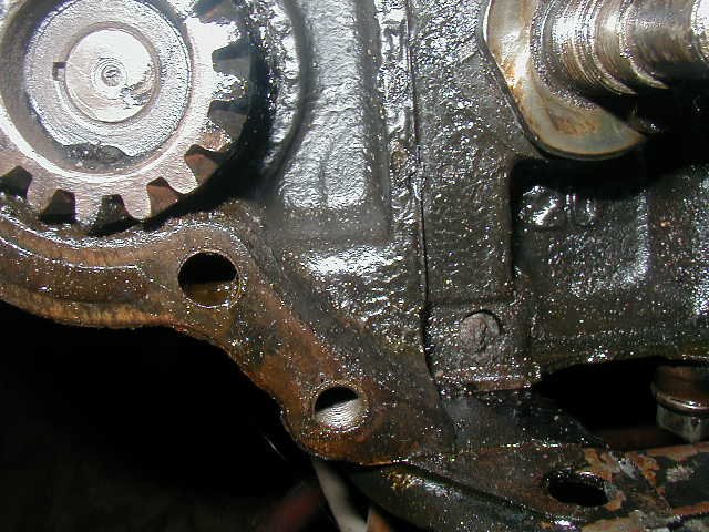

Don't be a bit afraid of wiggling that cam gear off for an oil tube check.
For a cam gear nut wrench, I use an old Indestro 1, 1-1/16 or 1-1/8 wrench that has had the open end offset a bit for a specific job dad had on a building somewhere yet it works great for the cam gear nut.
I believe the suppliers offer us a specific socket or some-such for that nut.
Summer of '16 I sat on a chair after the rad was off (waiting for correct rad & shell mounting parts), pulled the gear cover, gear and found this:
Pulled the muck out, reached in. did it again and then put the air to it. Bloop! It went! I cannot spell the sound the air made thru the oil tube! Cuuhuuhuuhuuhuu? Slur the H's?
Hopefully the new screen caught what came out the other end.
Perhaps a "thing to do, every few" for some engines that are not CLEAN inside.

I use a similar old wrench that has an offset to remove the timing gear. Nothing special but it works. Usually a slight tap going back and forth across the gear will help break it loose. It’s made to have a snug slip fit and not a press fit. The crankshaft gear is a press fit and it’s really tight. Just my take on how to remove the large gear.
