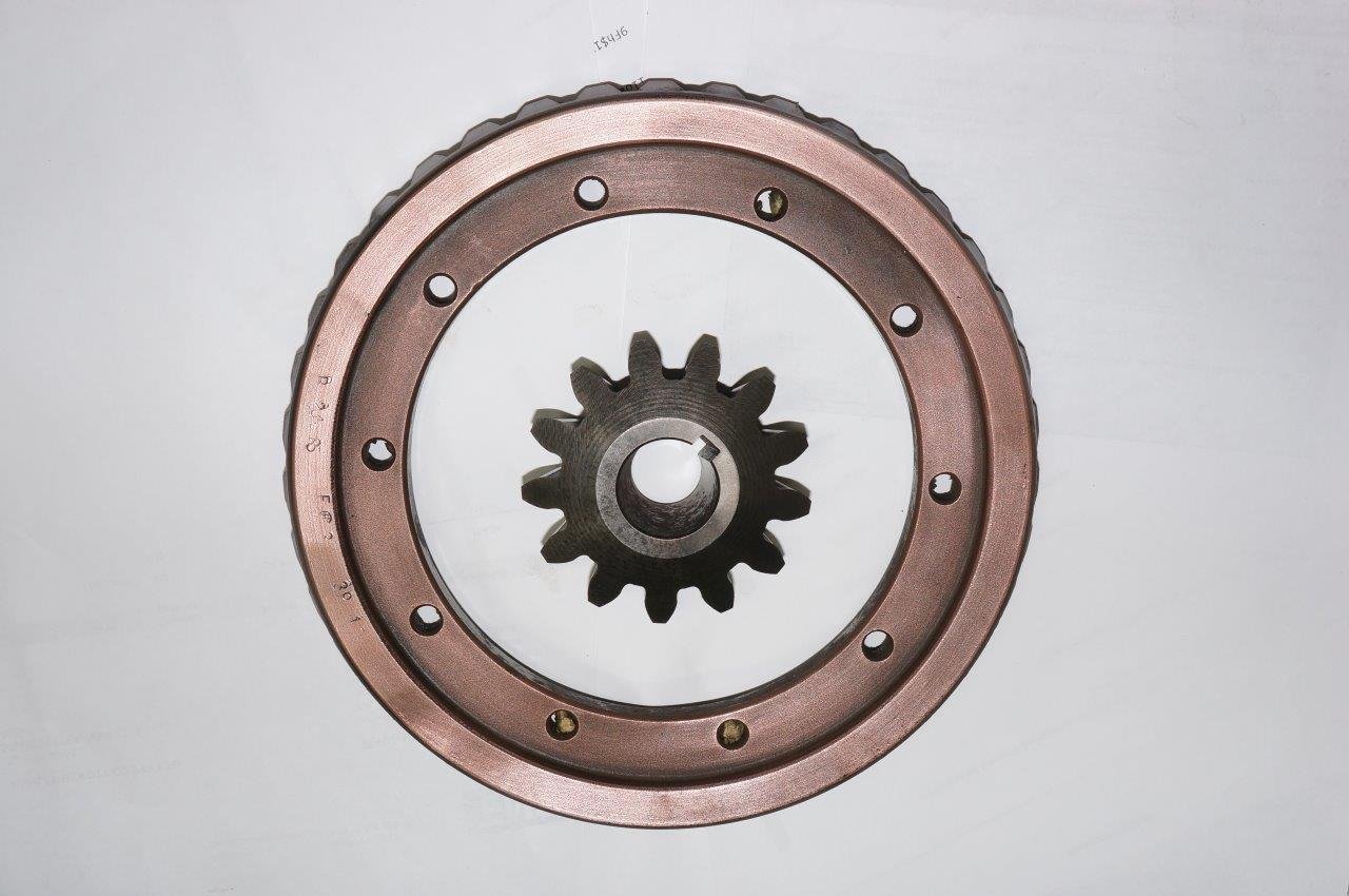

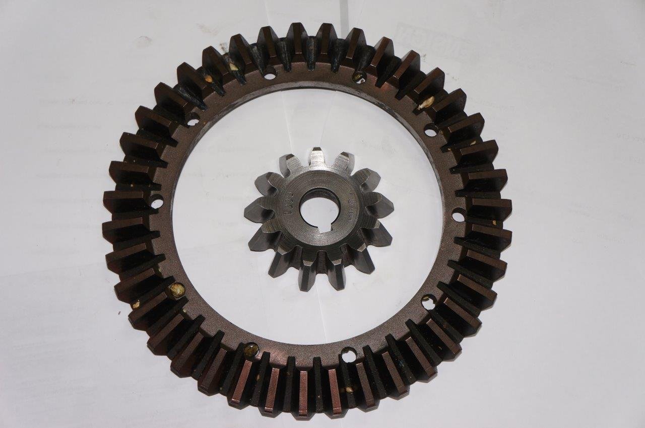

I'm rebuilding the Ruckstell on my 1924 Tudor at the moment.
I have a new 39T/13T crownwheel and pinion that I picked up a few years ago off a guy who was getting out of the hobby.
The crownwheel has a copper colour to it. Has anyone come across this before? The item is magnetic.

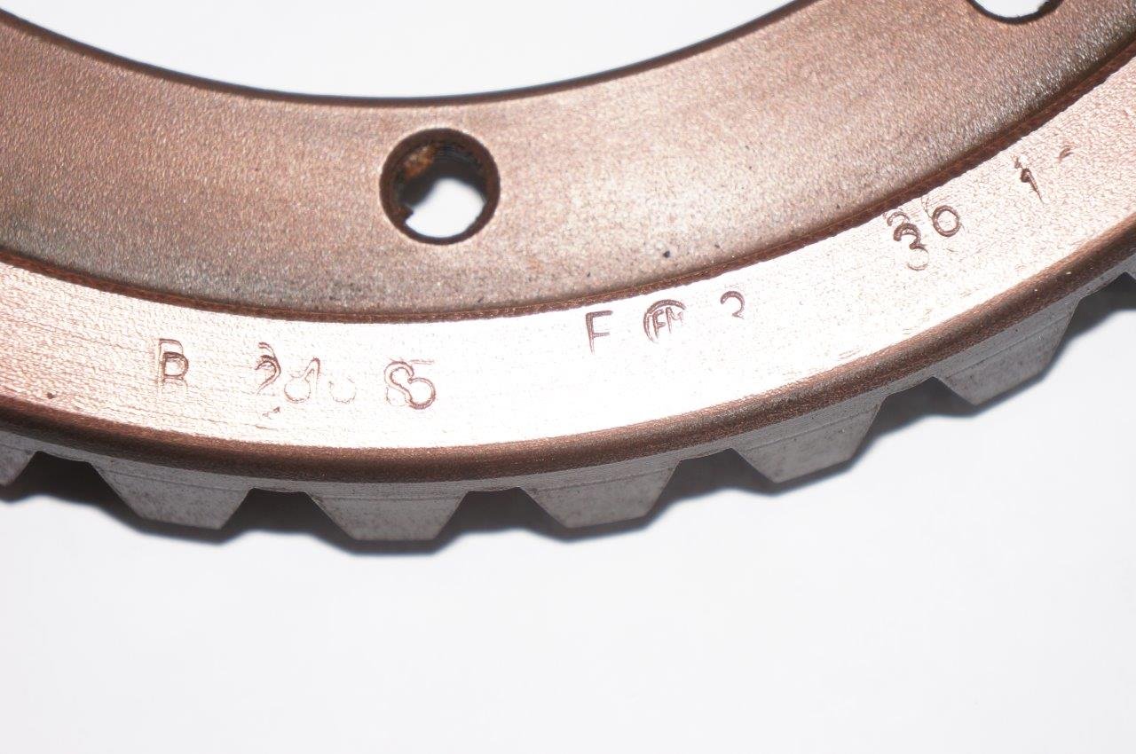

Both items are stamped with FM in a circle, which I think is the manufacturers mark.
I heard there was a bad batch of these that came out of Argentina but I assume they would have been stamped Industria Argentina (Made in Argentina).
Dan McEachern
- Posts: 1459
- First Name: DAN
- Last Name: MCEACHERN
- Location: ALAMEDA,CA,USA
Re: New 39T/13T Ruckstell Crownwheel and Pinion
That's not a Ruckstell ring and pinion- those were a 13 tooth pinion running against a 40 tooth ring gear. What you have is a 3:1 ring and pinion manufactured for and sold by Mark Auto. Most T parts dealers had these available in their calalogs, but they came from Mark Auto. The FM/circle mark indicates they were actualy made by Fairfield Manufacturing in Indiana. Fairfield is a well known manufacturer of bevel gear sets and have been in business for many years and was recently acquired by Dana Corporation.

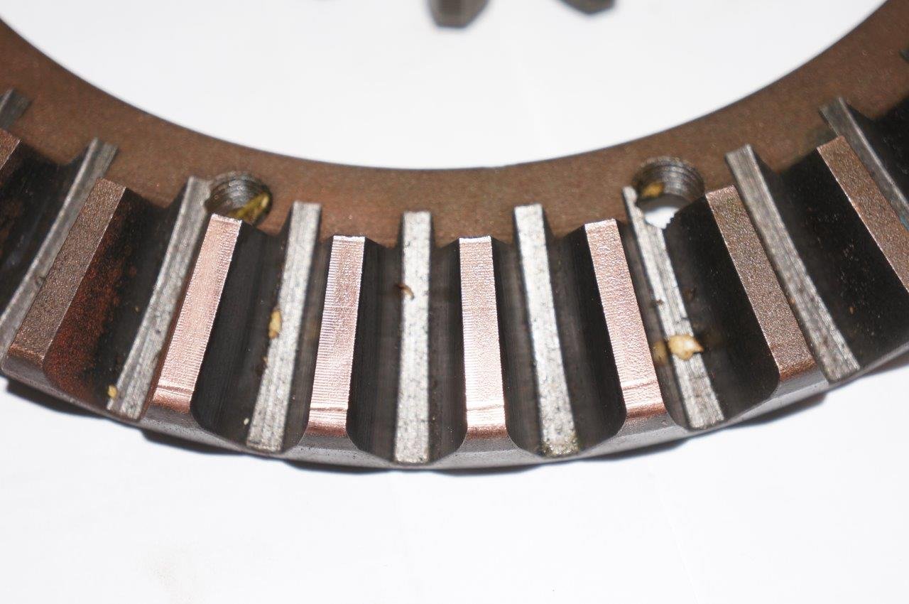

The copper plating on your gear set is part of the heat treating process that prevents case hardening of the gear body while allowing the teeth to be carburized and hardened and tempered.
Last edited by Dan McEachern on Sun Feb 09, 2020 11:26 am, edited 1 time in total.

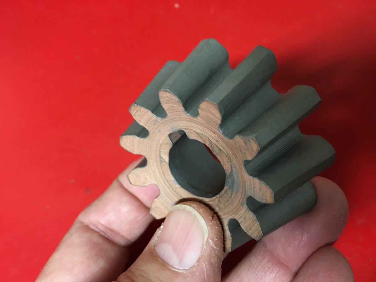

I have some Ford pinion gears that have that same copper sheen on them after coming out of the bead blaster.
