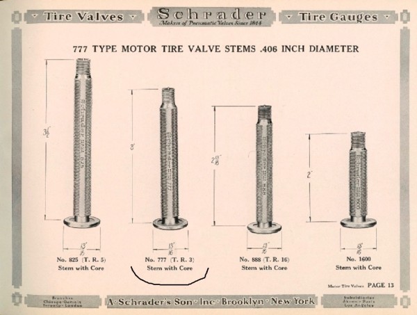

The correct original inner tube stems are Schrader number 777. If nobody answers before me, I'll measure one of my loose stems tomorrow.

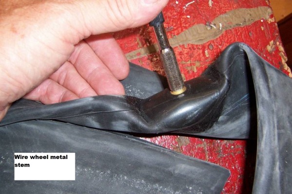

Thanks, Stephen, but I wasn't so worried about the Schroeder number as I was the actual stem length. I have two brand new Universal Tire Co. nickle plated metal stem tubes that have 2" stems. I was just wondering if they were correct.

Terry, I believe all the current metal stems are wider than what Ford used originally. I haven't found this to be a problem. As for length, all you need is for them to stick out far enough to hold the nut and the dust cover. The "correct" Shrader 777 is longer than your 2" stems, but if they hold the nut and the dust cover their shorter length doesn't matter. If the 2" stems don't reach far enough, you'll need to replace them with the longer old stems.

The 2" stem tubes you have are ok for Ford welded wire wheel, or for disc wheels for that matter. The shorter stem supplied on reproduction tubes and stems needed as there is no thick felloe. A longer metal stem is supplied on clincher reproduction tubes of today.
Just use the reproduction rim nut and the dust cap will thread onto it.

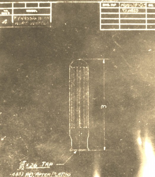

Ford originally used the longer length 777 style stems[as noted by others, the 777 stems are smaller diameter than reproductions today, original dust cap threaded right on] Ford did changed the length of the dust cap for the wire wheel cars that were fitted with tubes using the 'T.R.3' stem in the adv. below.
Longer 3" dust cap used for only wire wheel T's, because the stem stood taller in the thin wire wheel rim:
