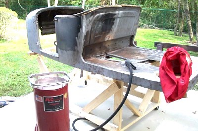

In the process of doing this and have come to the point where I can add the roadster’s metal floor to the frame. Since this was the original “trunk” floor and there’ll be no trunk, do I need to add the floor back with the pickup bed going over it anyway? It would seem the original metal floor would add some additional rigidity to the overall body subframe. Along this same line, did the back of the cab have a ledge or flange to attach the trunk floor to the back of the cab? Seems like with the battery cutout, one would need a way to fasten the two portions on either side of the cutout to prevent them from flopping around.....other than just rivets or screws into the cab back panel....
Posts: 4110
Re: Converting a 26 roadster to a roadster pickup
Post by DanTreace » Mon Feb 10, 2020 5:55 pm
Rob

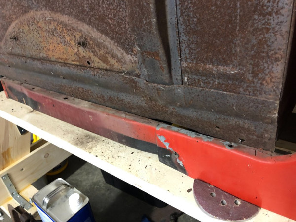

You don't have to add the sheet metal floor unless you want too, since you are putting on the pickup bed.
The runabout body does have a metal 'return' below the tub for the metal panel to fit, it has a lip to hold that floor. The metal floor does have rim for the battery door, but you can make something do with the wood floor only to hold the door in place, a hump plate will fit your your wood bed anyway as that bed has to clear the rear crossmember.
Depending on the year of your bed, the later used a 'filler' plate on both sides to cover the gap between the runabout tub and the front panel of the bed. Early beds just had exposed area there.

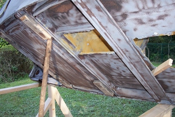

When doing a '26 pickup, removed the rusted floor panel and placed the completed bed with wood floor onto the runabout subframe, works good that way too. ;)
bed hump plate under side.jpg (68.84 KiB) Viewed 9852 times

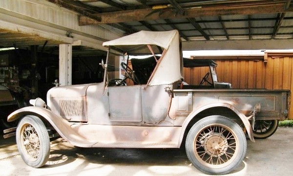

That’s a great point....maybe Scott C will take a look at his new PU and see if there’s any evidence of trunk floor on it. Looking at his bed picts, looks like he doesn’t have a diff hump on his....
I wonder if there’s more “converted” RPU’s out there with beds over metal floors? Seems like it might have been easier to slap a bed on a previous roadster and not take the time to drill out the riveted in trunk floor. And I imagine Ford sent a few factory RPU’s out with cabs that still had trunk attachment holes in the cab, just to save a buck or two...

Post by Scott C. » Tue Feb 11, 2020 1:15 am
At first glance, I did not see a metal floor. I will take a closer look and see if I can tell if there ever was one.

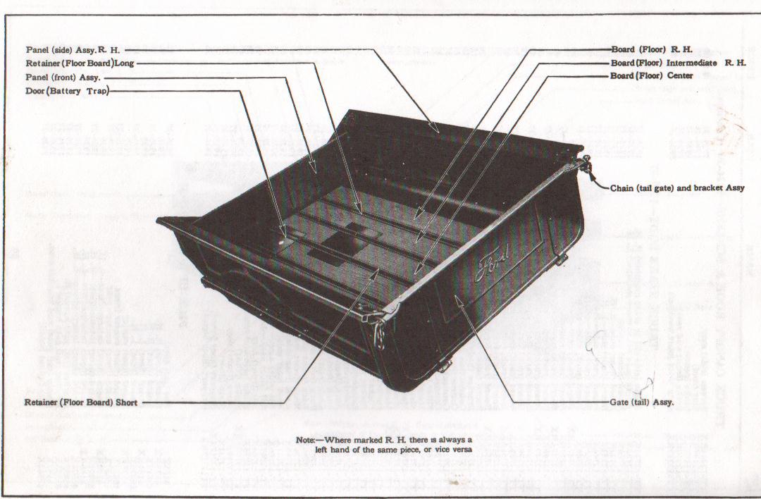

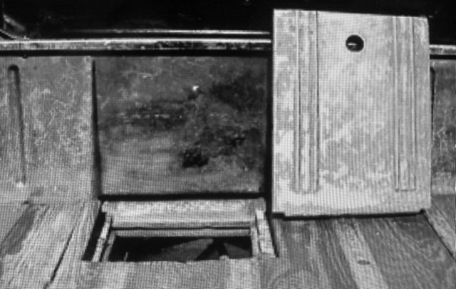

Unless someone can confirm factory assembled pickup didn't have a metal deck (rear floor ), then IMO, all runabout bodies came with a metal deck.
A '26 pickup that I restored had the metal deck. The metal deck sealed road grime, and it also has the battery door flange, and bump up for the rear crossmember.
The pickup bed with its wood floor slats sits above the metal deck, as its mounted on side members that bolt to the subframe. Makes it very easy to remove a turtle deck (they have no floor and rely on the metal deck) and mount a pickup bed with its wood floor for hauling stuff, easy to slide things over a wood floor out of the bed. :)
Now perhaps later '27 factory assembled might not have the metal deck, but seems odd. Although that may be the reason the later pickup beds have a forward 'filler' plate to cover the gap between the tub and the front of the bed, that would hide bare frame rails if no metal deck. Don't know, have only experience with pickup bed over the metal deck on a '26.
Note the metal deck under with flange to keep battery door in place, same as runabout only it has a wood door, the pickup bed uses a metal door, with unique molding to mimic the metal bed strips for cosmetic effect.

Cool! That picture of the metal stamped battery door is great! Good point about the metal deck stopping a lot of road gunk from hitting the underside of a “vulnerable” wood bed...

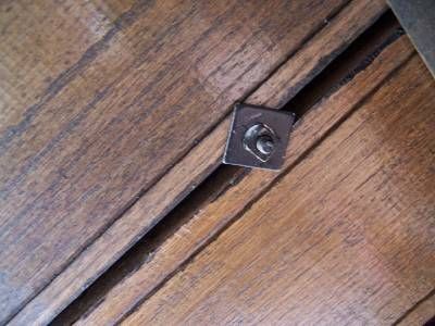

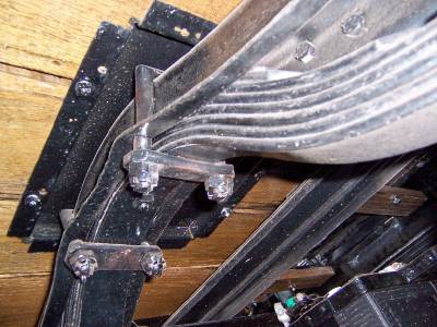

Larry

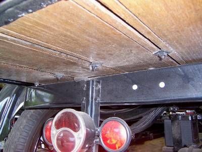

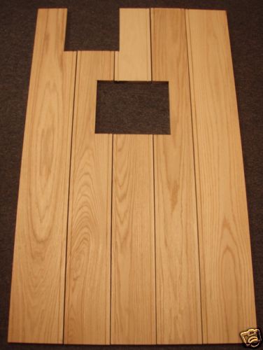

The '26-'27 pickup steel bed is a standalone assembly. The wood floor boards are fastened to the metal sides of the bed, and along the rear, and at the front of the metal bed. The metal strips only provide center support for the wood floor.
The carriage bolts are short and only go between each wood board, no holes to drill, and into a special 'toothed' square washer that locks into the saw kerfs on the board underside, and fastened with a square nut.
The assembly fits over the metal deck of the runabout, and it is above the deck for clearance. The side frame rails of the bed are what hold it up over the metal deck. No fasteners go into the metal deck to hold the pickup bed.
bed rear tail lamp mount web.jpg (50.89 KiB) Viewed 9381 times
Reproduction board and reproduction special washer, note the repro washers are a bit too narrow to fit well into the kerf, or else the reproduction boards are made with the saw kerf too wide apart, although the metal strips fit well into the upper kerfs. The tooth ends of the square washer should bite into the saw blade kerf, to keep the washer and board from separating or moving apart under loads, the metal bed strips fit the same way on the upper surface of each board, into matching saw kerfs. Those metal strips cover the gap between each bed board.
bed sq washer under bed web.jpg (47.04 KiB) Viewed 9381 times
Wood bed set for the '26-'27 pickup metal bed.

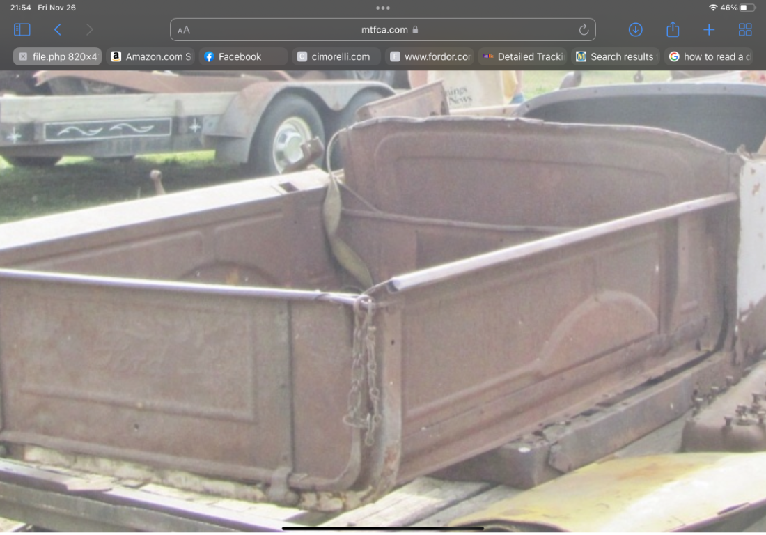

I am in similar boat. My 1926 roadster came with a wooden bed, which I am replacing with a stock metal one.
However if I place the bed onto the rear, the width of the bed is 2” - 3” more narrow than the rear side panels where the turtle deck would normally sit. I don’t have the metal panel either.
This photo illustrates the gap.
So would I need the metal panel shown here?
And I see nothing the pickup bed would attach to on the body frame. So wondering about the discussion related to the 2 crossmembers shown here:
Help!

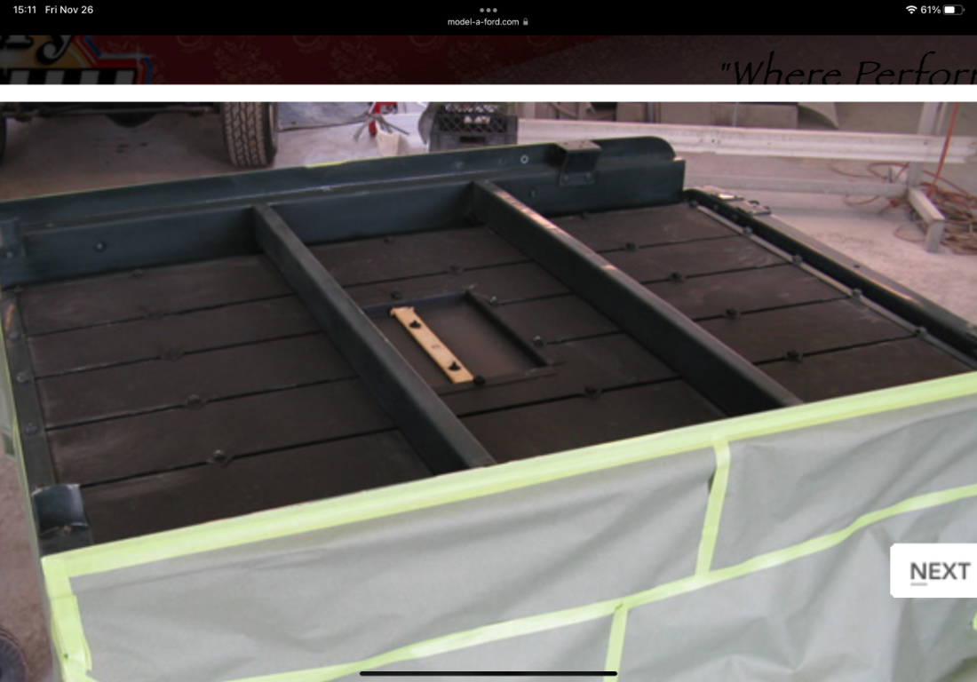

Ugh. But it has the half moon sides, and the front cut out for the battery box…

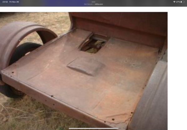

Literally the offset matches this file I found while searching the forums
Does your sides come straight down or is there an “L” flange on the bottom surface where it sits on the body ?
(And thank you for your help!)
Jennifer
Posts: 4110
Post by DanTreace » Sat Nov 27, 2021 7:24 pm
Looking close at that photo you posted from the web, that bed is correct later T bed on T runabout, but not aligned correctly. The flare rails should extend pass the body tub equally, obviously one side is off center.
Appears from your description you may have the Model A bed. Can't fit to the T runabout subframe :?

So based on everything I’m seeing, I’m fairly convinced this was a model T bed that some one cut off the bottoms of the “L” panels along the bottom of the bed which is how it would be mounted normally.
It has the correct half moon embossing on the side panels, and the front panel has an obvious modification to remove the battery notch and make it flat which I’m told folks used to do when converting them to trailers.
The length of the bed is 57” and it’s 47” wide side to side measuring the outer edges of the top “lips”, the inner width is 40.5”.

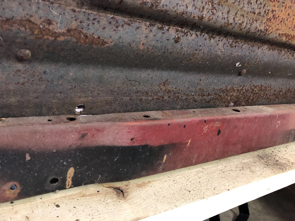

Mystery solved??
I finally figured out what the issue is (I think/hope/pray). Sometime in the distant past someone took this and flattened out the battery notch and flattened out the long “L” bracket along the bottom of each side where it bolts to the body!!
Notice how tall the lower panels are:
And it appears that if I were to re-bend the bottom back into an “L” shape the holes align with the frame! So the "L" is now an "I"!!!
How in the world did they bend this 4’ long piece of pretty heavy metal I wonder?
Thanks everyone!!!
