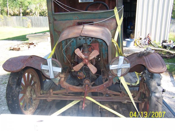

My TT is titled 1926 and supposedly the original engine. It came to me with an engine mounted coil box but has an early firewall as seen. Was there a transition period where this could have been correct. If not should I use a firewall mounted coil box. What say the experts?

The 26-27 TT trucks had a lot of 1924-25 features such as hood, fenders, cab, and firewall coil box.

It is my understanding that coil boxes on all TT's were mounted on the firewall, including '26-'27 models.

Henry is correct. ALL TT's stuck with the cowl mounted coilbox until the end.
However, many have found their way to having the engine mounted set up in
the years since.

Firewall mount it will be. Thanks

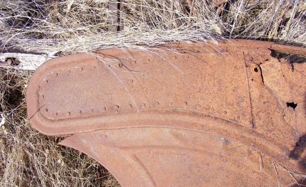

- Posts: 979
- First Name: Stan
- Last Name: Howe
- Location: Helena, MT
Re: 1926 TT coil location
I think that was my fender patch photo. I'll see if I can find it and post it again.
- Posts: 979
- First Name: Stan
- Last Name: Howe
Is this it??
