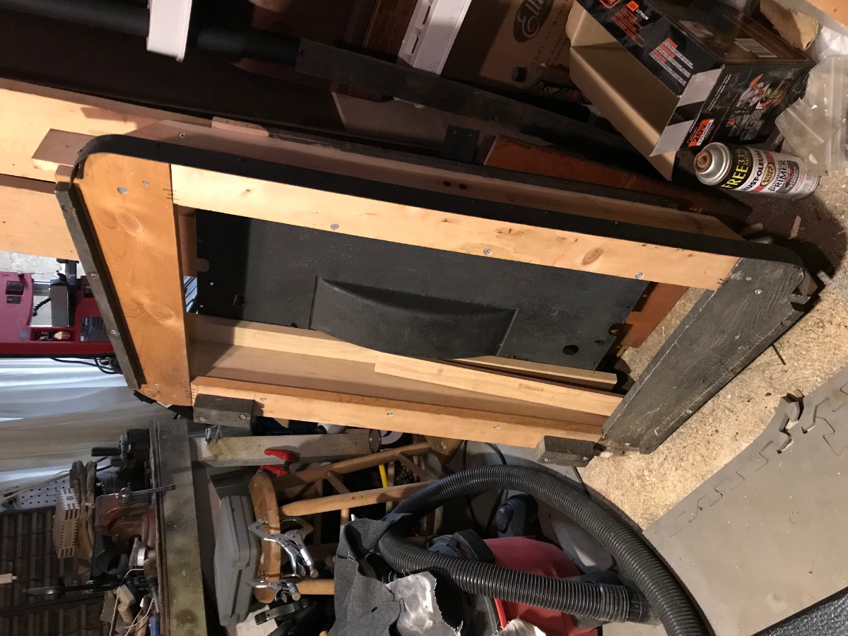

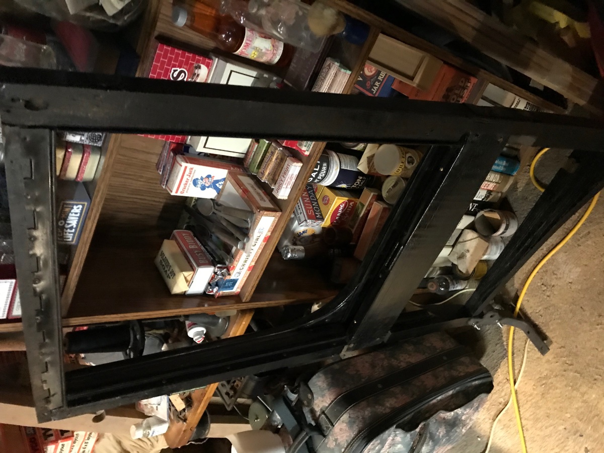

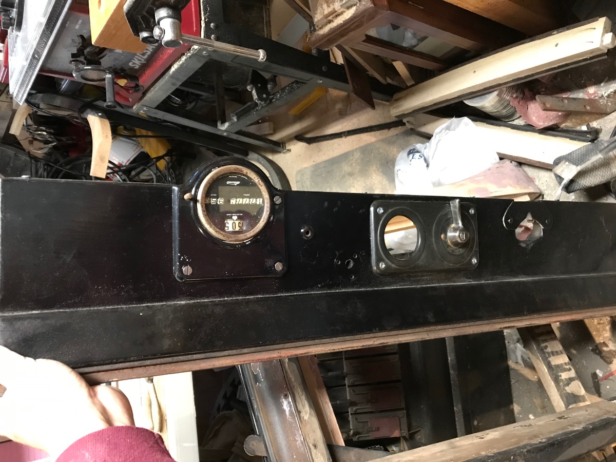

Here are some pictures of progress on my 22 center door sedan.

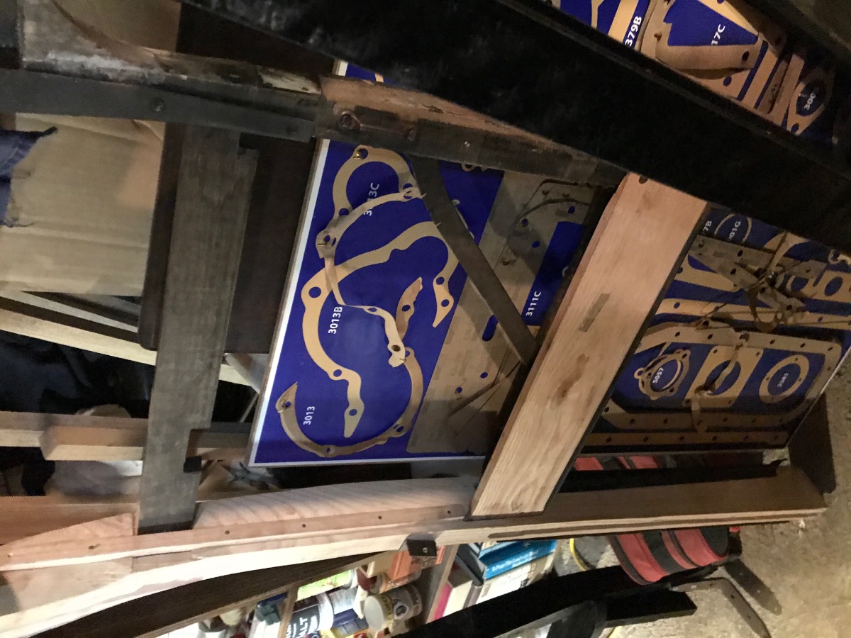

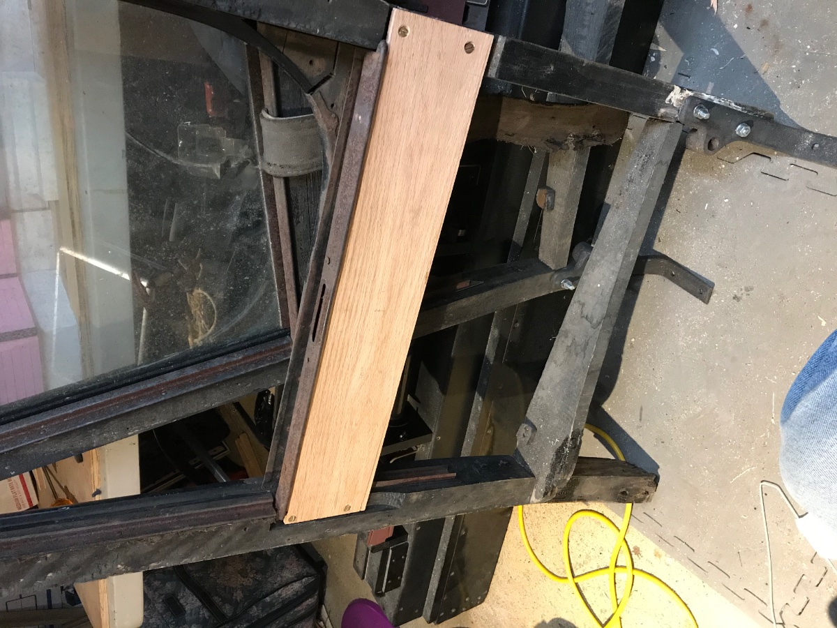

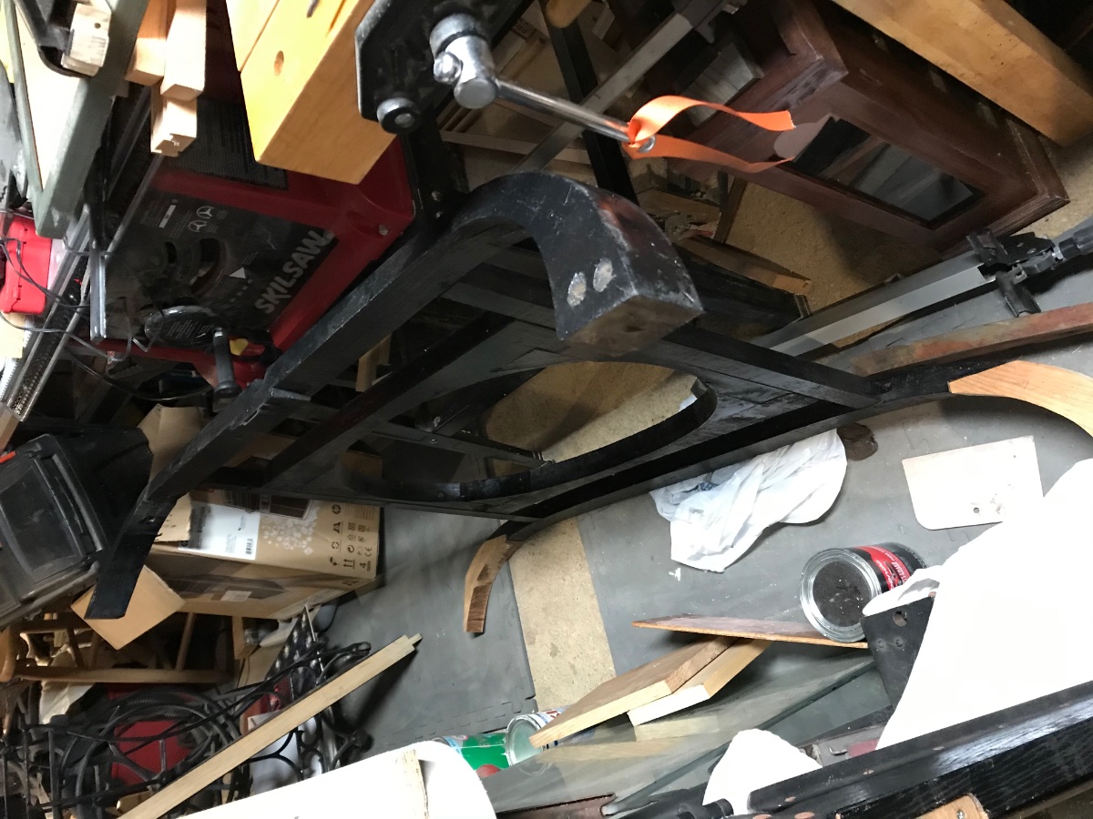

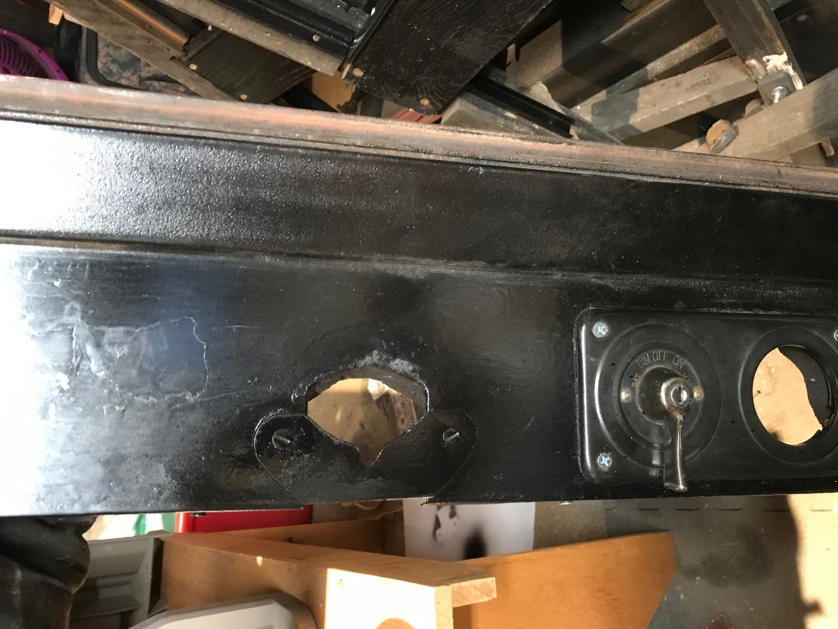

More pictures

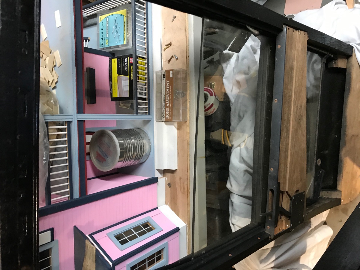

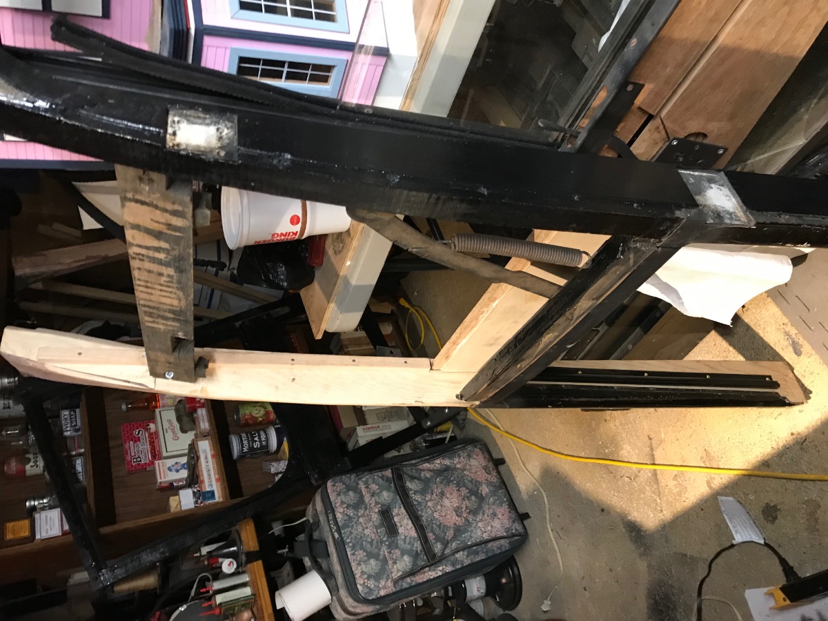

My basement is a gathering of sub-assemblies. I also have both front seat platforms, the cowl former, windshield header and a kit for the roof rails/bows.
At least one other piece will need to be made and that’s the rear seat stringer. I may also need to rework the front header as it has a significant bow to it (I’m fairly sure it should be flat.)

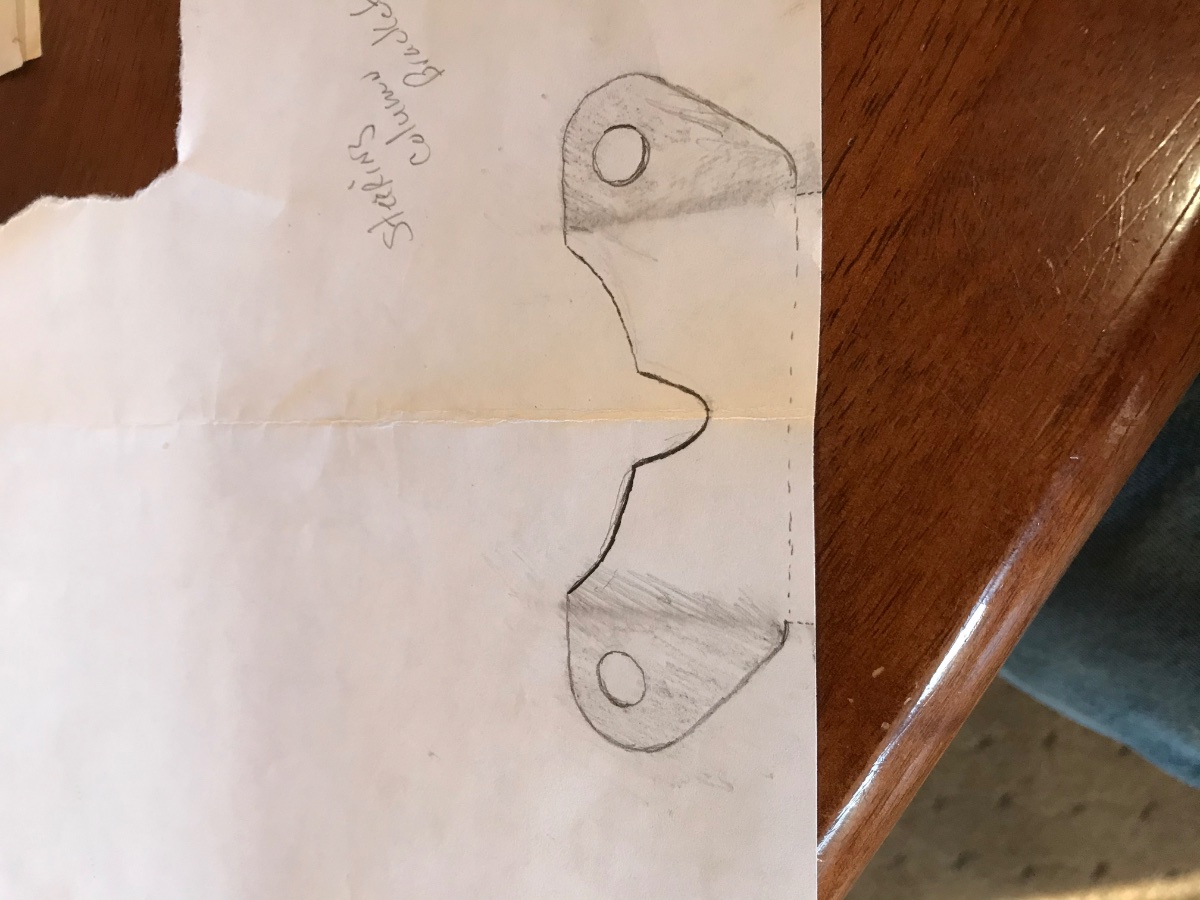

The hardest piece for me to make was the steering column bracket.

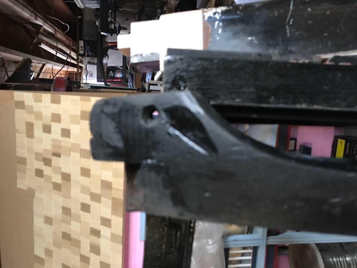

Post by Will_Vanderburg » Sun Feb 16, 2020 5:59 pm

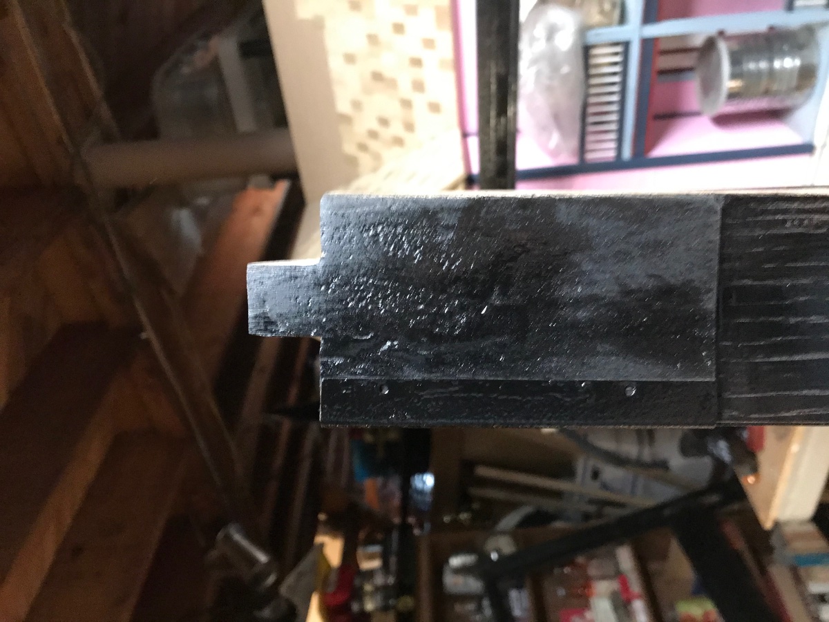

Here’s a tenon that I installed where it should be. The pillar had been sawn even with the sheet metal.
Also filling and reshaping a small missing piece
