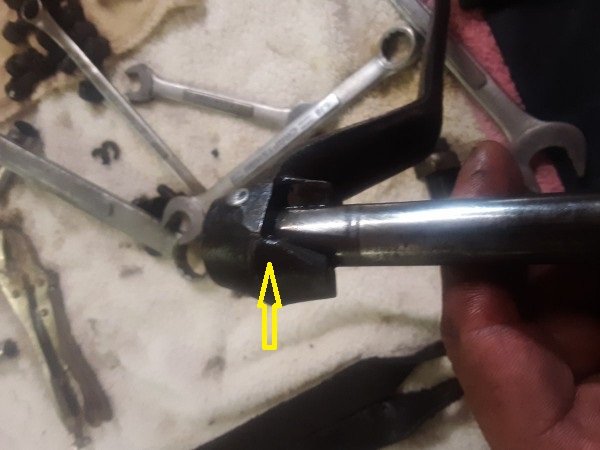

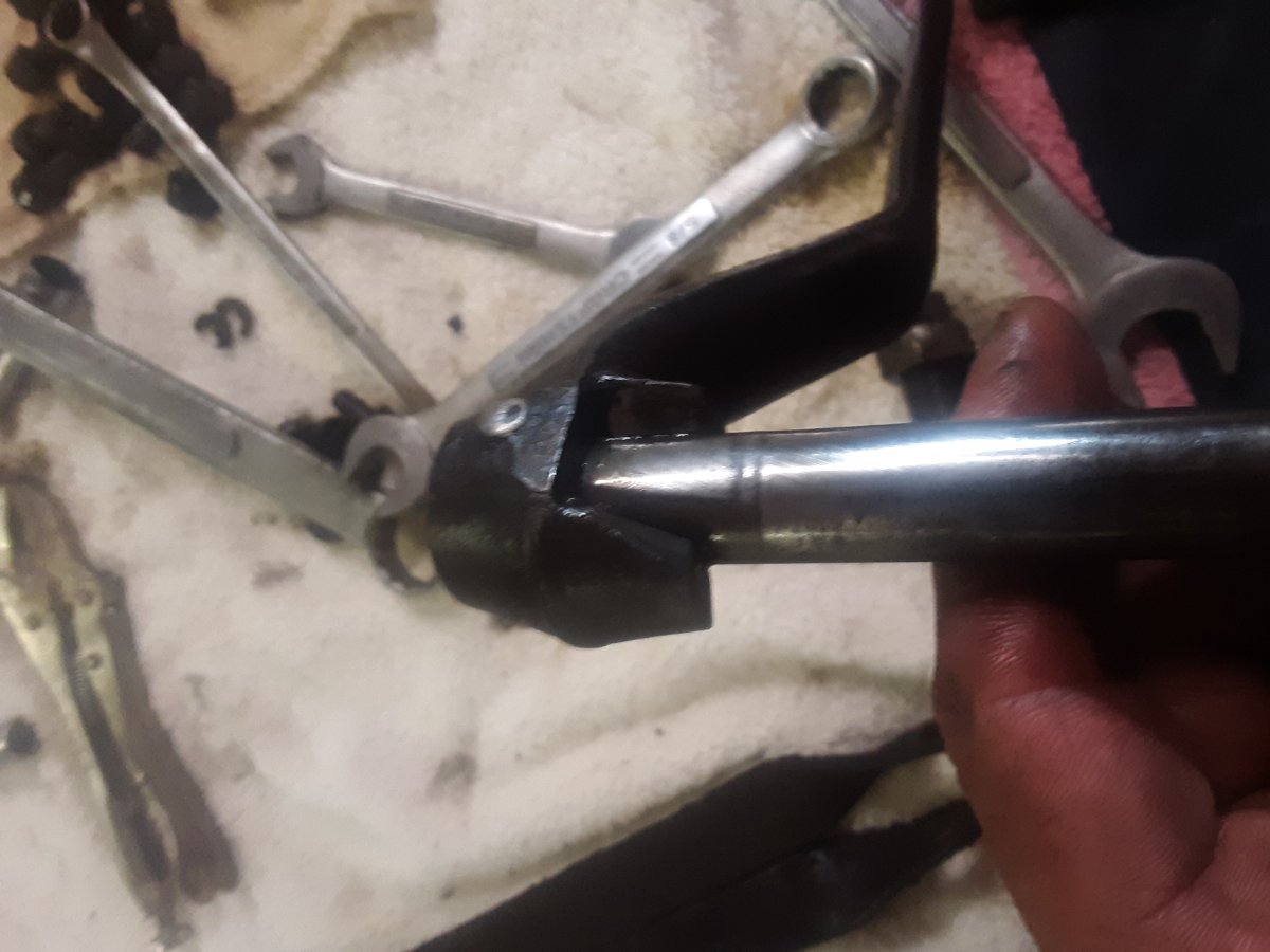

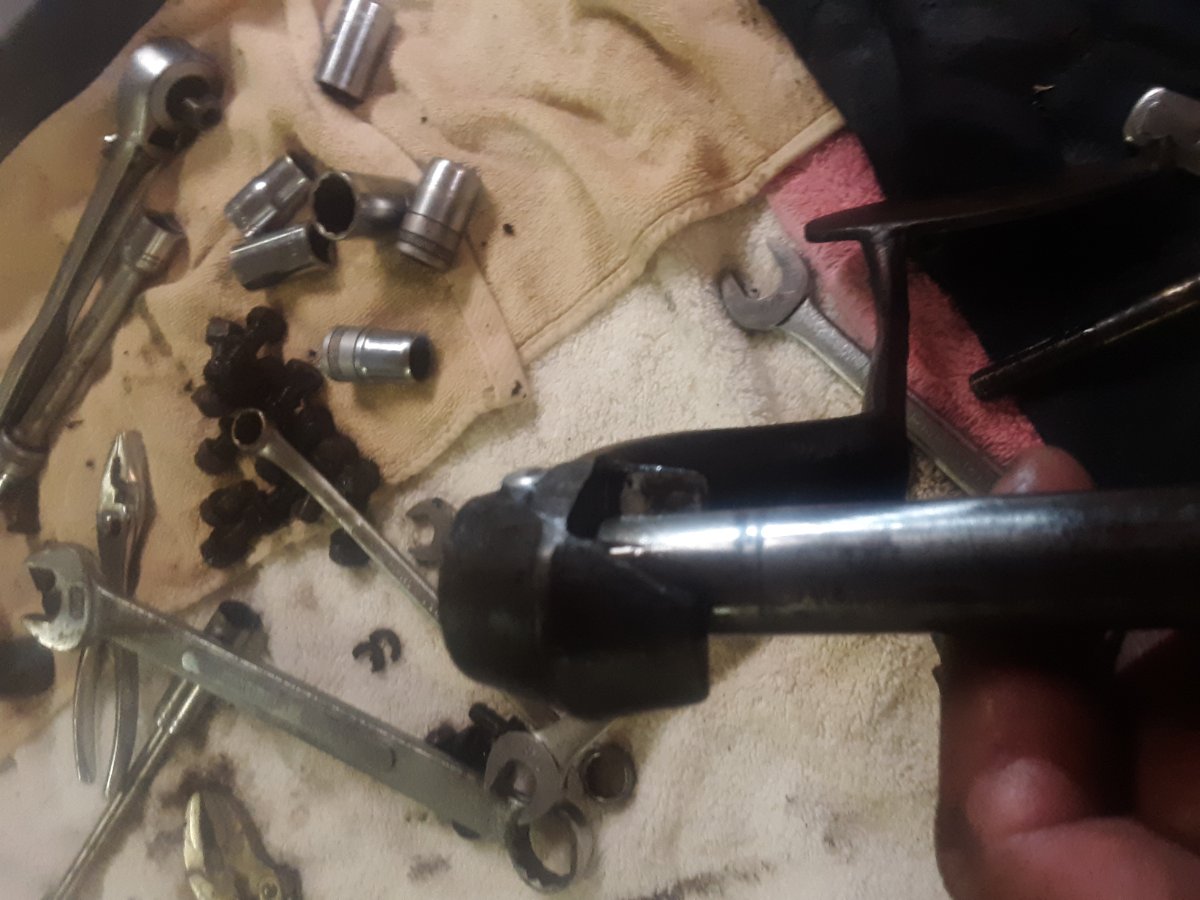

My low speed pedal notch is bad, really bad. I thought by the way my brake and reverse pedals worked they seemed ok...however take a look what do you think of my pedal notches are they still acceptable or not ?
- Posts: 7275
Re: Pedal notches
Larry, because the ramp is part of the pedal, it is not easily corrected, as new pedals are not available. A new notch will help, but the pedal needs to be removed from the shaft so the ramps can be welded up and refinished to compensate for the wear. Just don't add too much weld and remove all the play between pedal ramp and notch. There has to be some to be able to hold neutral with your foot on the pedal.
Hope this helps.
Hope this helps.

Check the pedal notch fit with a new hogshead notch and go from there. Good luck to you,

Ok.. thanks, that's what I'll do hold it against a new notch and make it fit..

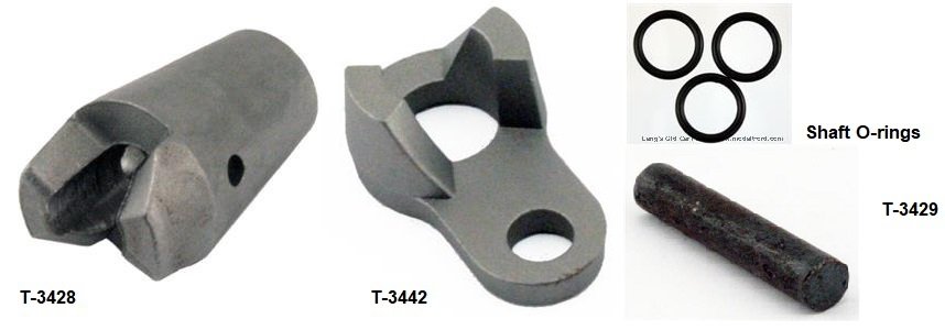

LHD cars have a replaceable pedal support (inside) and a notch, which slides over, and is riveted onto the low speed pedal shaft. On the low speed pedal itself, there are no pedal ramps to wear out or require building up. As JAB35 mentioned to OP, Replace the pedal support and notch with new and you should be good to go (though you might wish to replace the shaft, too, if it leaks too much oil).

Thanks Scott. Our RHD cars are as I indicated. The pedal shown at the start of the thread is a LHD brake pedal? That shows ramps like our first gear pedal. I missed the fact that it is not a first gear pedal. Given the use the brake pedal is likely to have had, the same repair procedure as I outlined could be used, but with the brake pedal there is no need for play between the pedal ramp and the notch ramp. Or am I still missing something?
For those unfamiliar with RHD hogsheads, there are external adjusters on the brake and reverse pedals, and internal adjustment on the first gear pedal, the exact opposite to LHD covers. Hence the differences in pedal ramps.

Luke, if you purchase a new notch, let that be your guide as to how much your pedal ramp needs to be built up. On a brake pedal, the two are a neat fit. Build up plenty, so you have plenty r to work with. The working surface is both angled and twisted. Some beating blue will keep you on track as you work the ramp.

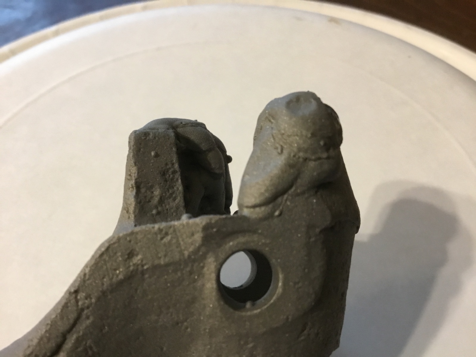

Don't have the time read everything that's been written above, so if it's already been mentioned, than please excuse me.
Both the notch/cam AND the pedal need to be replaced/repaired in order to make things work right. One is no good without the other.
As suggested above, using a new notch/cam as a gauge is excellent advice. However, even if the ramp of the pedal cam matches the new notch nicely, you still want to assure that there is minimal play between the two before the pedal engages with the notch and begins to ride up on it.

you can carefully weld the pedal and dress to where you have full contact. It’s a slow process, but the end result is close to new.

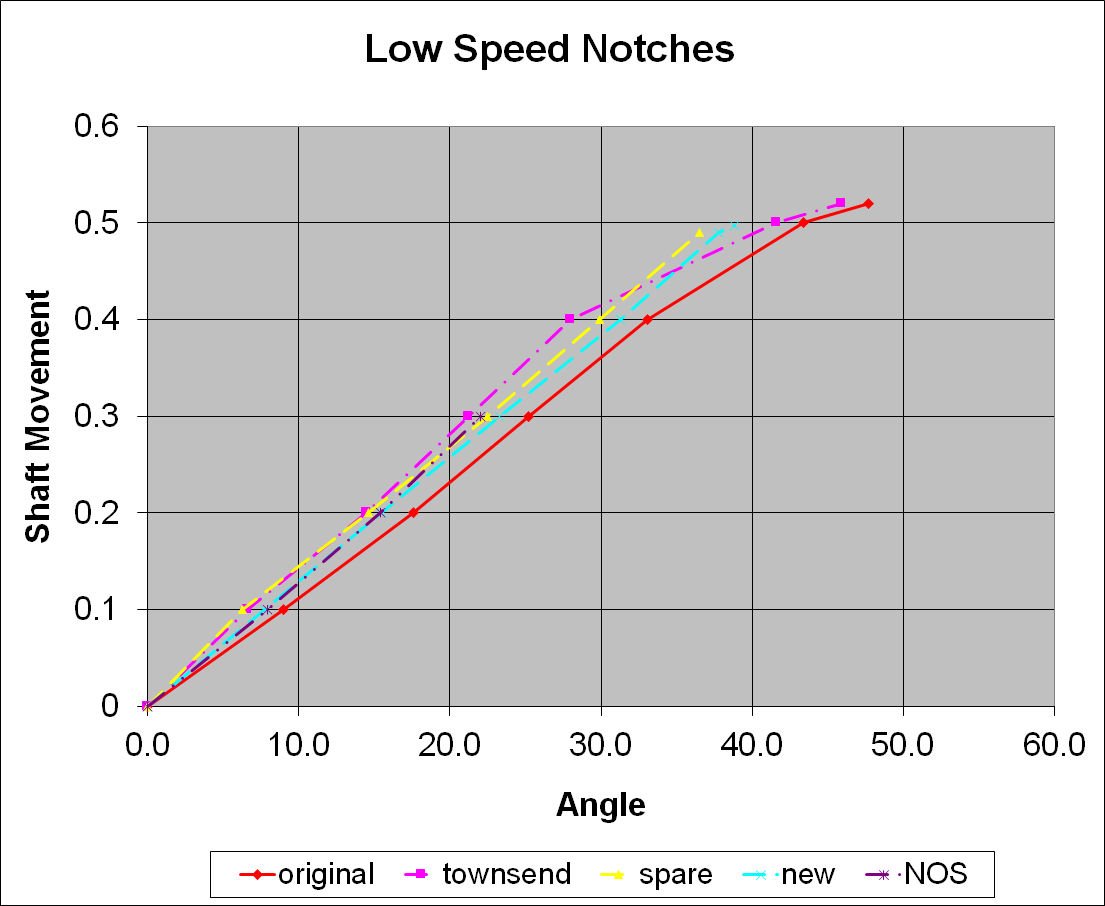

Some time ago, I thought my notches were too worn, because I was having to adjust the bands so low engaged near the floor. I decided to take a scientific look at it. I gathered a bunch of notches, (1) my original one, (2) a spare used one, (3) a new one from Snyders, (4) one thought to be NOS, and (5) one of the reconditioned ones that Townsend used to sell. I put a dial indicator on the end of the shaft and measured the angle of the pedal with a digital angle gauge. I got the graph below. The maximum difference was only about 10%, so I cam to the conclusion that this is a nonproblem. - Larry Young

Larry,
Top marks for the quantitative analysis!
However it appears there's no free play shown? Was there indeed none, or did you start the measurement at first engagement rather than say with the pedal lightly back against it's stop?

I didn't plot the free play. I'm not saying notch wear is never a problem, but I am saying that I couldn't find a significant problem for all the used notches I could put my hands on. You could always do similar measurements and compare to the graph.

So, ignoring the free play, cams are about the same for a given rotation. Not surprising to me as ramps don't tend to wear "flatter" to any real degree in my experience.
So, for the sake of analysis, assuming that total throw for a pedal is about 30 degrees, limited by the floorboard, then considering free play, let's say that a new pedal support rotates 10 degrees of free play and then rotates the remaining 20 on the ramps (0 to 20 degrees on the graph). And then assume a worn pedal/support rotates 15 degrees in free play and then rotates the remaining 15 degrees on the ramp (0 to 15 degrees on the graph). One could argue that total movement/rotation is more or less than 30 degrees, but it won't vary much, nor will the basic findings relative to lost motion due to wear.
For the sake of ease and dealing with only one set of numbers, I picked your original cam to input theoretical free play increase (which is how the wear manifests itself), and it shows that the movement difference of 15 absolute degrees vs 20 absolute degrees is a difference of .16" sideways vs .23" sideways "squeeze" on the band. Those numbers are I think a reasonable "guesstimate" that I figure from the low fidelity of the graph. That's a 43% increase in "squeeze" with a new notch with less free play vs a notch with typical-to-excessive wear. That difference is the difference between a blown up drum/transmission and 25,000 miles of trouble-free touring.

Larry: Thanks for sharing that graph, and taking the time to make the measurements. Comparing the 'shaft movement' over the range of rotation, it appears to me there's up to 30% more band tightening motion with the new notches vs the original for the same amount of pedal travel (shaft rotation). ('Townsend' vs 'original' at rotation of 25 degrees in graph). To me, the demonstrated effect of notch wear is significant here, and in addition as others have suggested, coupling this measured wear with wear-induced increase in free play, suggests notch wear is something to be aware of even if many do not consider it a 'problem'. jb

Shouldn't the "new" and "nos" lines be identical? Since they are not, they are showing up at your doorstep not being within original specifications to begin with unless I am not understanding something.CamMan wrote: ↑Sat Feb 29, 2020 2:44 pmSome time ago, I thought my notches were too worn, because I was having to adjust the bands so low engaged near the floor. I decided to take a scientific look at it. I gathered a bunch of notches, (1) my original one, (2) a spare used one, (3) a new one from Snyders, (4) one thought to be NOS, and (5) one of the reconditioned ones that Townsend used to sell. I put a dial indicator on the end of the shaft and measured the angle of the pedal with a digital angle gauge. I got the graph below. The maximum difference was only about 10%, so I cam to the conclusion that this is a nonproblem. - Larry Young

Who knows about these parts. The "new" may have been a newly made copy of a worn out notch. When people talk about NOS Model T parts, that is just their opinion, right? Just consider this a random sample of notches found in my garage.
