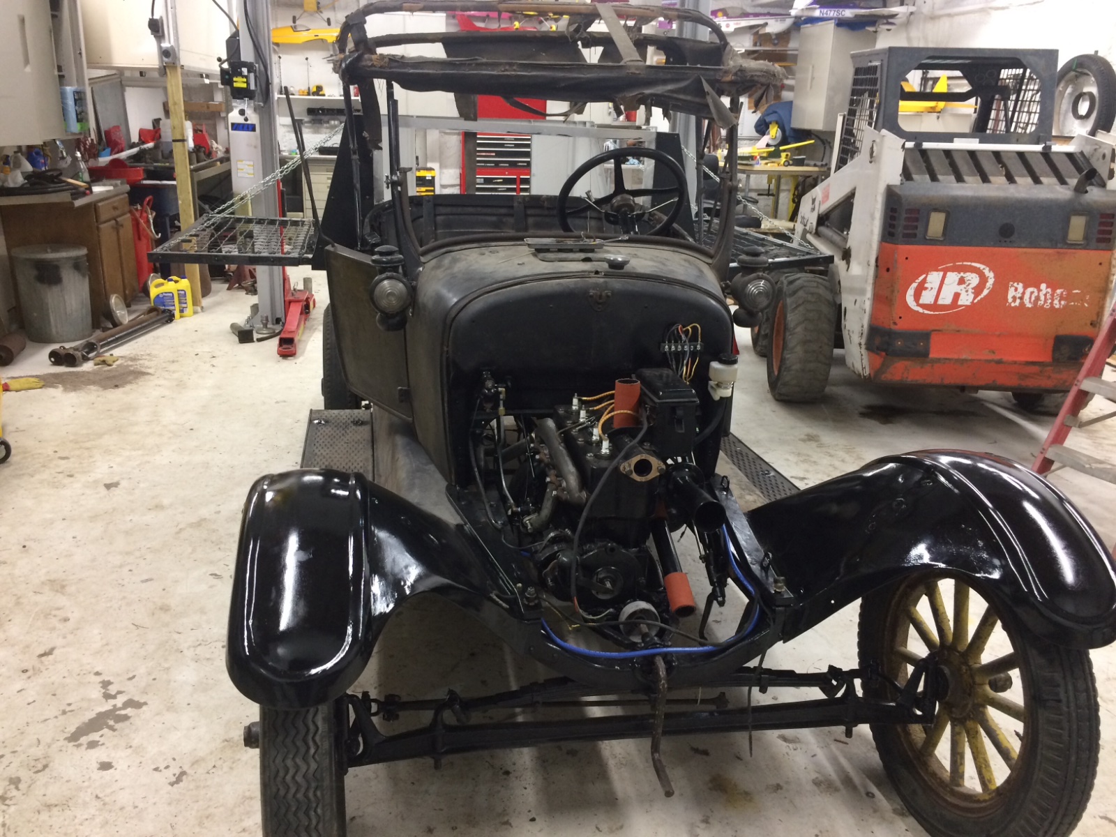

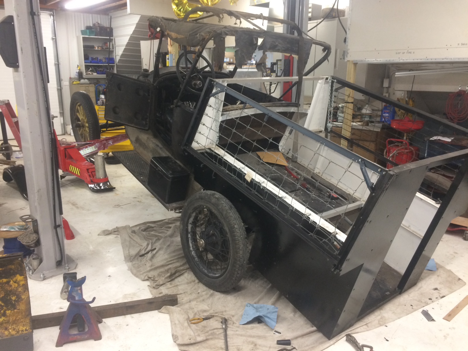

To bleed the disc bakes ;)

What kind of truck are you building there Dean?

My version.

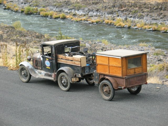

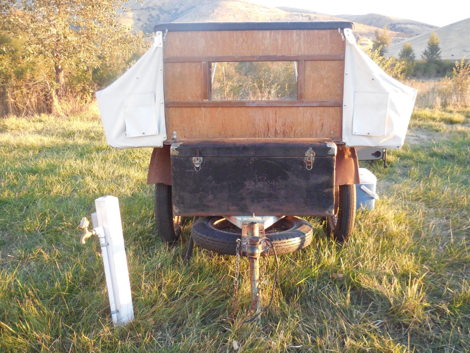

I like it, please keep up updated on the build, I have a camp trailer for behind my Model A pick up that looks similar in design.

Dean Was it high enough? I been trying to get the disk brakes on mine bled for a year. They work but are soft.

Plenty high. You need to disconnect the master cylinder from the brake pedal so you get enough travel.

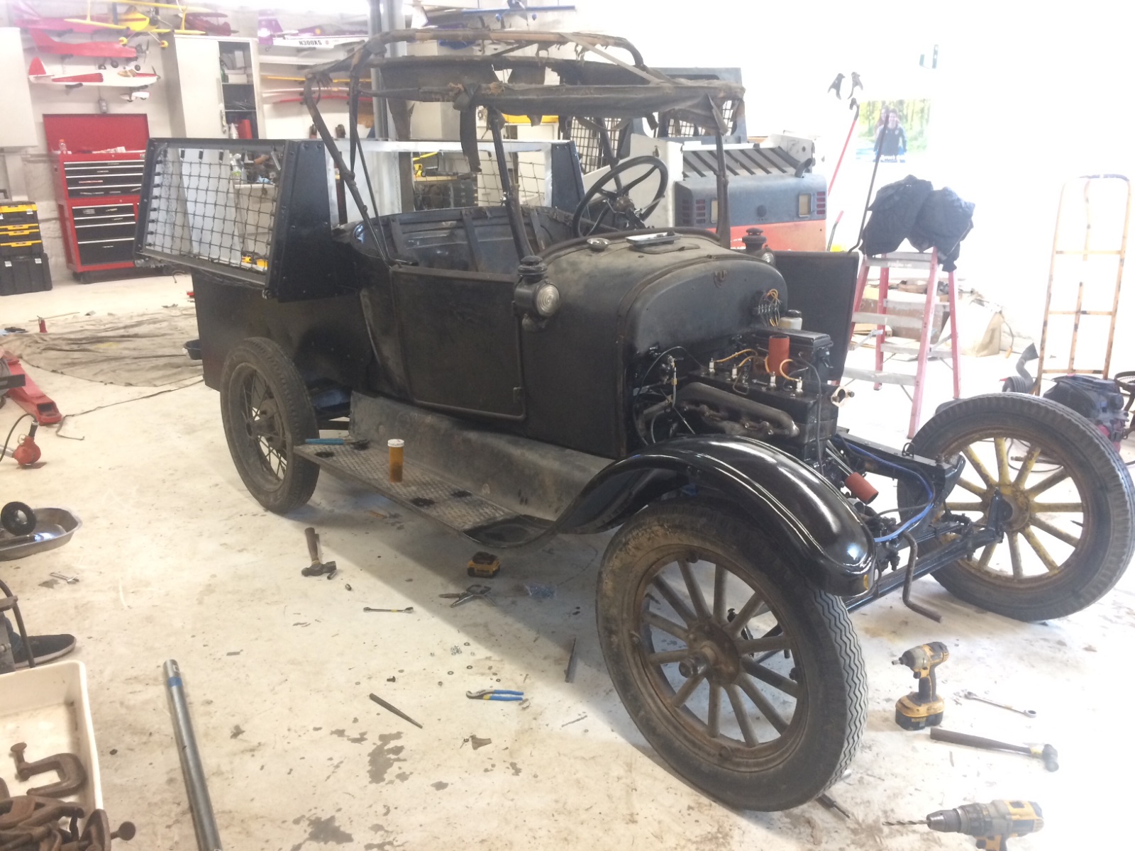

Is that the T that had the tread plate rear fenders?

No that is a chopped touring.
This is a real Roadster. I have both a turtle deck and pickup box for it.
Today we got brakes ,left splash apron & both front fenders on😊
