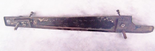

Photos of '23 low cowl hood shelves, with wood blocks installed. You put the assembly together and drop it over the fender which is on the frame rail. Then add the carriage bolts, if using engine splash pans, they secure under the square nuts and lock washer on the ends of the carriage bolts.
A '24 hood shelf is similar.
Mount the springs and hood latches, be sure to use small dia. washers and fold over the cotter pins, as the spring and latch must pass thru frame rail holes and not hang up.
Factory assembly from Service Manual.
