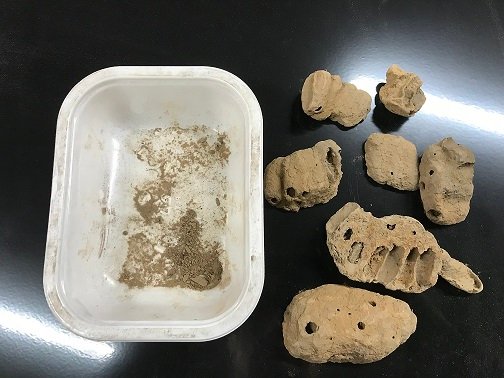

"IF" the tank was not rusty when set side in the 1960's and was dry at tat time - depending on where it was stored an climate conditions - the rust likely from condensation. If the tank was outside the car and the drain &/or gas cap were off there could be something else rattling around inside besides rust. I had thought that the one I had may have been caused by the baffle that was missing from the underside of the gas cap or a tank baffle. I shook the heck out of it, several times, each time retrieving the culprits (photo). Even small loose rust should slide under the baffles to the gas cap end for retrieval. Note the size of the mud wasp nests that I got out via shake, rattle and roll. I filled the tank with white vinegar (cleaning grade) to dissolve the remainder nest that was too big and wouldn't break (powder that is in the dish). The dish is 4w x 6l x 3h. The vinegar also dissolved some powdery rust in the tank . If you can't get what is in the tank to get under a baffle then its bigger than one of those wasps nests!
There really isn't any point in sealing the loose debris too.
