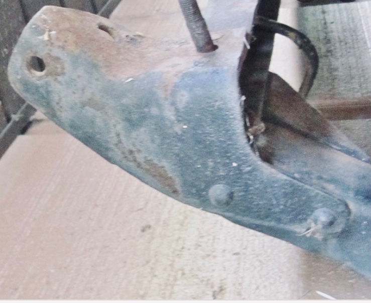

Need to replace the front cross member on a 27 pick up and I have some older frames that I could get a donor cross member out of if they are the same. Thanks, Dennis

TT's are different from cars. All car front crossmembers should interchange.

Dennis, The front cross member on the '26 and '27 Ts are different from the '25 and earlier frames. They are made to accommodate the '26-'27 front fender irons. I don't have a picture to show you. But, if you take a close look at the one on your '27 and compare with an earlier one you'll see the obvious difference.

You could use an earlier pre-‘26 front cross member, but would need the left and right fender bracket extensions, and with some modifications re-drill holes in the earlier crossmember and rivet both back in correct place.

Thank you all, It looks like with a little work I can make it work.
