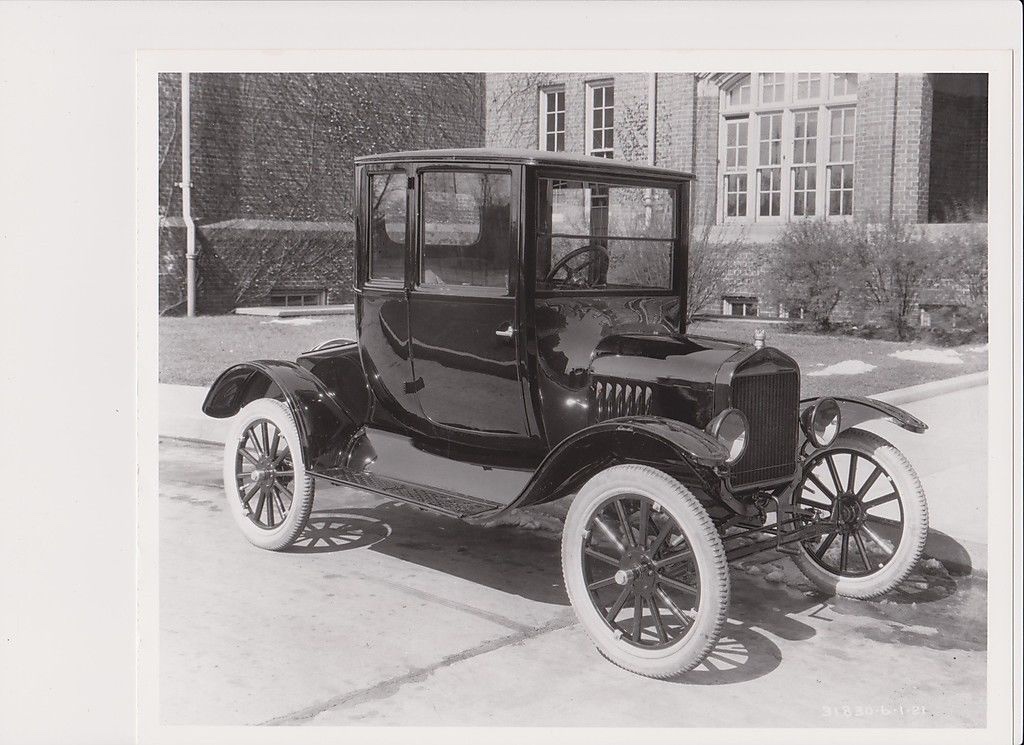

According to Parts book, listing also by B. McCalley in the C-D encylo....
The T-9066X Channel, rubber, is listed for only the closed cars. The open cars '15-'22 didn't use a rubber channel. The closed cars got it assuming for the cloth upholstery. Open cars were more open to the elements :D
With the 'new' slant windshield open cars, '23-'25, that T-9066X was then used, as the upper windshield could fold out and away, so the channel was used.
The Improved car got same, but a tad longer, part T-40324X rubber channel.

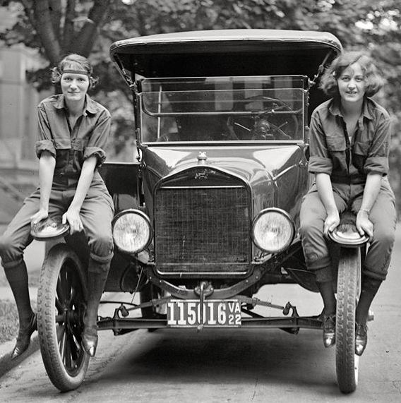

On the 1915 through 1922 roadster and touring windshields, in the up position, the upper half of the windshield sits forward of the lower half. Also, the bottom of the upper half slightly overlaps the top of the lower half when the windshield is in the up position.
Therefore, by design, there is no need for rubber between the two halves on 1915 through 1922 tourings and roadsters and they were not equipped with rubber as Dan posted above.
