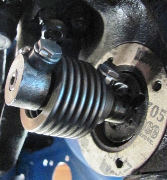

Normally a little starting bend with single slot screwdriver blade, levered against the spring loop.
Finish the flattened bend against the Bendix bolt with narrow width angle jaw 10" slip joint (Channel Lok) pliers, opposite jaw on backside of bolt.
