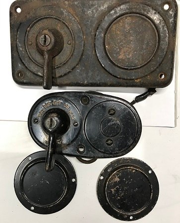

Would these non-starter ignitions switches also be required to call it a "non-starter". Both ignition switches have the dimmer for mag lights. The ammeter block off plates are original one piece, not a disk inside a ammeter adapter plate.
- Attachments
- non-starter switch.jpg (52.2 KiB) Viewed 3612 times
- Posts: 4114
Re: Non-starter engines post-1917
Frank, yes.
That is if going for 'factory' non-starter car.
That non-starter, Plain Jane, the timid sister of Lizzie, came with those style switches, and simple wiring harness, and magneto lamps, and no electric tail lamp.
.....just coal oil illumination out the back
