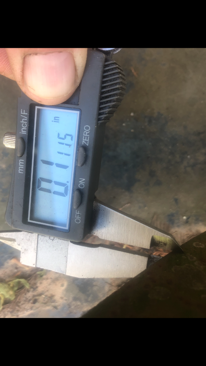

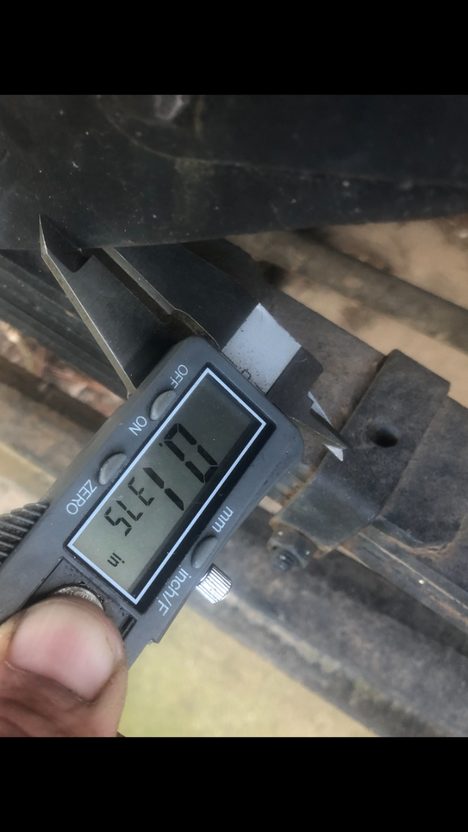

Re: Front cross member "heavier steel", thickness?
These measurements are slightly larger because of rust and paint and/or inaccuracy of the cheap calipers, but they are consistent with what R.V. stated. One is an 09-13 frame and the other is 1921-25.
