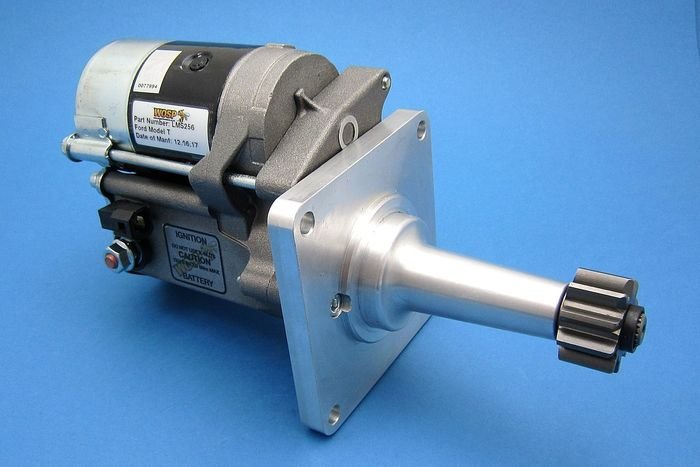

If you are dead set on a 12v starter, get one of those new ones made for 12v. $400+. They seem to work real good, according to guys i have talked to. Keep the left hood side down. They are bat ugly wrong. Thats the trade off.

Re: How do I convert a 6v starter to run on 12v?
Bat ugly? Awww..... I think the new starters are elegant.
If this sounds familiar we just had a similar discussion on another thread.
I also have a high compression head and originally ran a 6 volt starter on 12 volts. To drop the voltage a bit I put the battery in the back seat, ran #4 wire and put an old bendix spring in series with the cable from the solenoid (yes, I used a solenoid, not a foot switch) to the starter. Normally it worked fine but a couple of times I stalled out on tour (engine hot) and had to crank it by hand beyond compression before the engine would turn over. I also had a bendix problem (slipped woodruff key) another time. These little things bothered me enough that I decided to purchase a modern starter designed for the job. I wanted to stay with 12 volts for a number of reasons which need not be discussed now.
I took my 6 volt starter and the diagram for re-wiring it for 12 volts to a reputable old-time auto electric shop. When I explained what I was thinking and showed the guy the starter his reply was "Aw....you don't want to do that....." Indeed, he refused to do the mod. I'll leave it to others to debate the pros and cons of that modification. At that point, I decided to look at a modern replacement.
The WOSP unit is a geared starter, with a built in solenoid. You can keep your foot switch, just use it to activate the solenoid. When activated, the starter gear first engages the flywheel, then turns. Less wear and tear on the gear teeth. Also, no little bendix parts to come loose and end up in the engine. In the year I've had the starter it has worked well and given me zero problems.
They aren't cheap, but I covered most of the cost by selling my six volt starter and bendix. My goal has always been to have a reliable car for touring and the starter goes a long ways towards meeting that goal. If a future owner wants to return it to original, it is a simple matter of out with the new and in with the old.

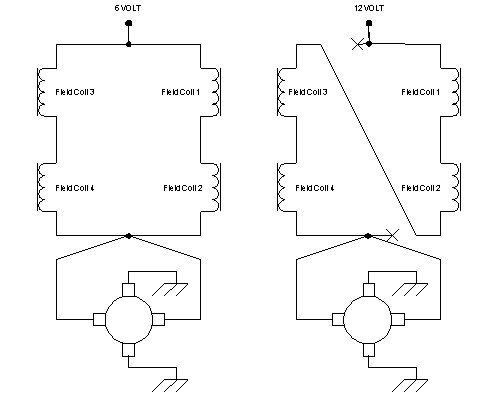

jsaylor
- Posts: 443
- Last Name: Saylor
- * REQUIRED* Type and Year of Model Ts owned: 1921 Touring, 1927 Tudor
- Location: Citrus Heights, Ca
To convert the stock 6 volt starter to 12 volts requires rewiring the field coils from parallel to series.
- Attachments
- 12v_starter_schem.jpg (20.22 KiB) Viewed 8923 times
