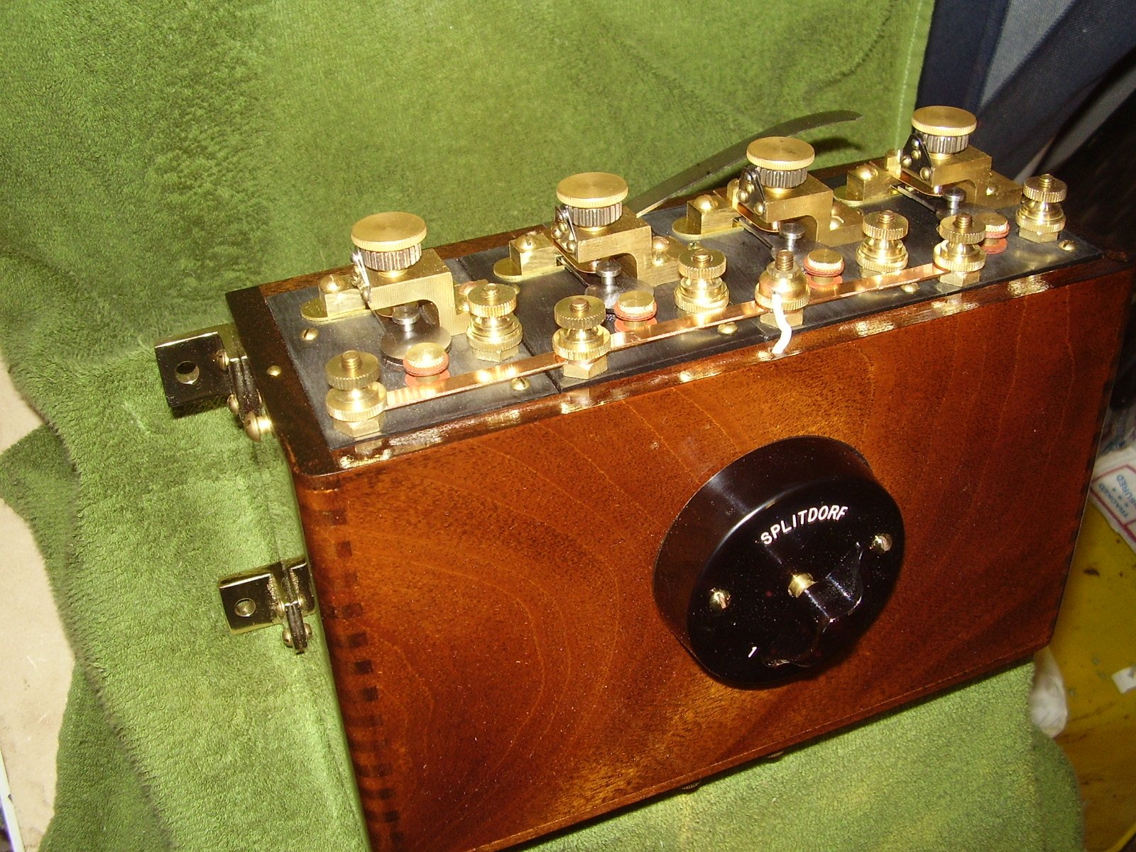

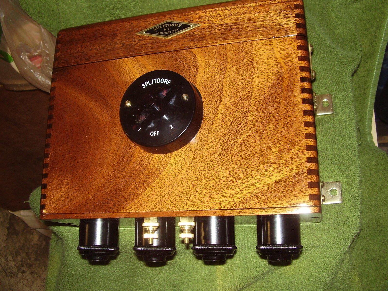

Just finished building this for a goodfella in MD's '06 Ford Model N. Complete box and four coils, correct down to the anti-rattle leaf spring under the lid.

Absolutely marvelous RV. I was fascinated by the grain in the box front. I presume it is a result of the way that particular board was first cut. It would certainly make it hard to duplicate when making the matching lid, as is shown. I presume they are the same species, just milled differently.

Thanks for the kind words, guys. Allan, you are right; the wood is all from the same mill run of partly quarter sawn Honduran mahogany but from different planks. I try to buy 16/4 mahogany whenever possible; first, to avoid glue-ups when cutting large sections for later sawing into individual panels, and second, to allow for more wiggle room when the planks are partly or even fully quarter sawn. Trouble is, fully straight sawn 9 to 12 inch wide 16/4 can be tough to find so I usually have to settle for 12 or 10, or sometimes even 8 if I (and my customers) are desperate. Since I have to take what I can get, when I can get it, completely grain-matched lids and boxes only happen about once every three or four builds.

R. V. may I ask how these coils are hooked into the wiring?
I saw this thread, hopped up to grab a coil out of my curio cabinet and it's this type and wondered what for.
Says Splitdorf New York in a diamond on the Bakelite top.
I'd guess that the rail is positive on the posts closest to us. Is High tension on the bottom post?
Where do the four wires from the commutator attach? The other top post on the adjustment mount? That knurled nut is TIGHT.

Duey, you have it right. The timer connection is the one closest to the large knurled adjusting screw. The primary is the one in the corner, and the high tension post is on the bottom of the unit.
