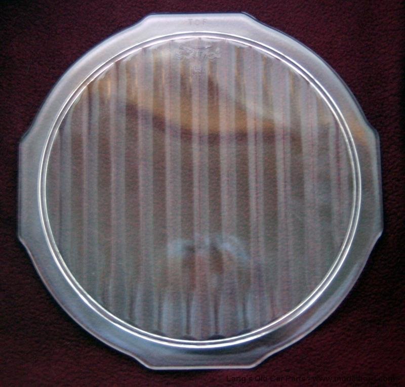

This is the type of lens I own.

The fluted lenses don’t hide much...

Yes, that is the standard Ford H lens. When I went to Hershey last year I went to the vendor selling the LED lenses and mentioned the odd pattern they threw. He said that yes, the vertical ribbing on those lenses was the reason and there was nothing one could do to improve the light. Now .. they do shed a lot more light than anything else, but it is an odd pattern. The street signs really flash back. Yes, you can see that they are not the typical bulb.

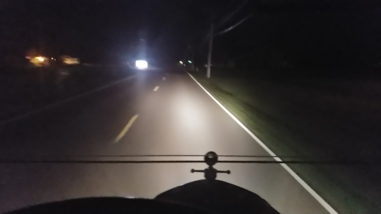

Good to know the vertical Ford H lenses cast an odd light. I have a spare set of plain clear lenses, but wouldn't want to install them since the LEDs will be even more obvious when not in use. All good insight. Below is an image I shot last summer when driving home late from work using a standard 6v lightbulb - not bad.

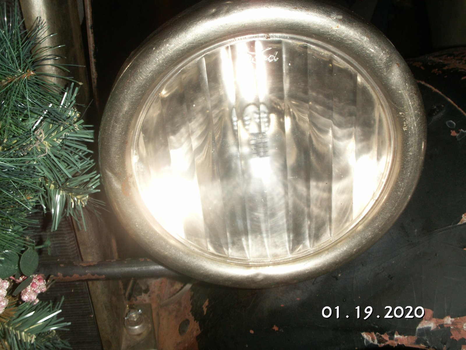

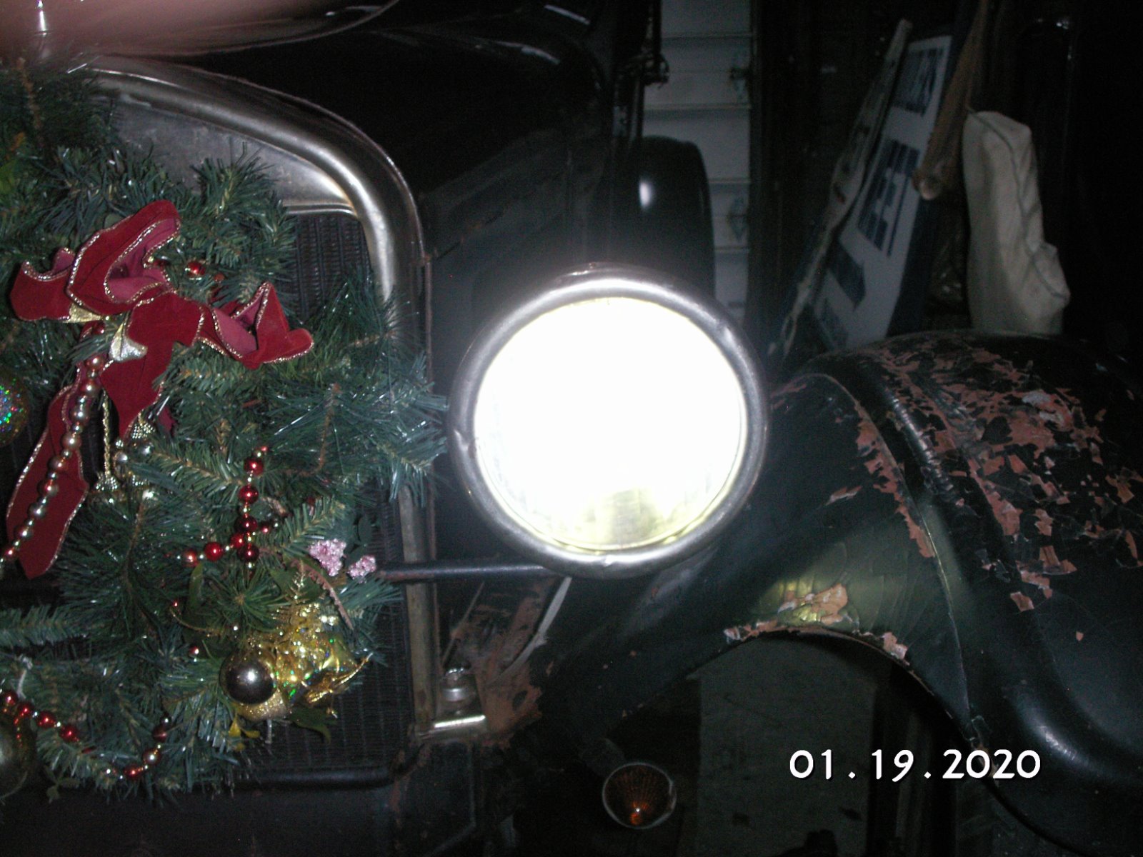

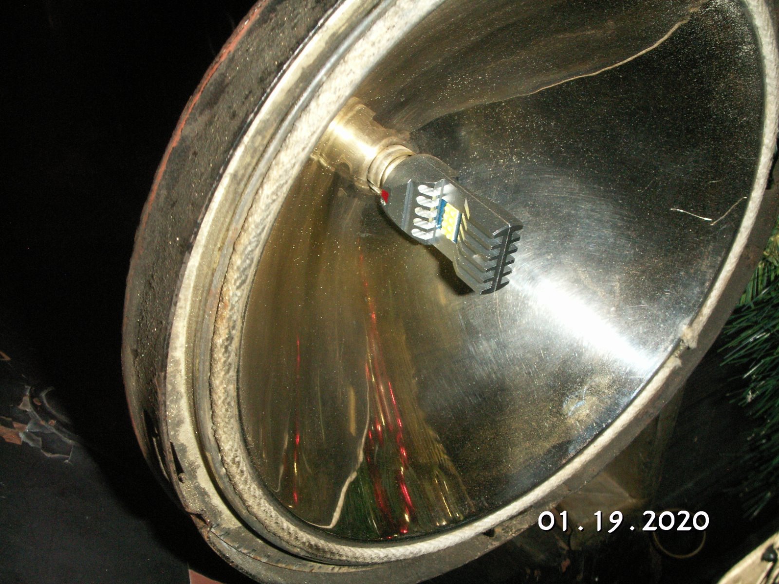

These are from Gaslight down in Urbana, Ohio got them from Bob at Hershey last fall. After getting hit because some woman didn't see me two years ago I wanted to be seen and these sure do the job. They are not that noticeable with the H lens. Also when I turn the lights on now my amp meter doesn't peg to the negative side so I can run with them on all the time. They also have a high and low beam. Jim

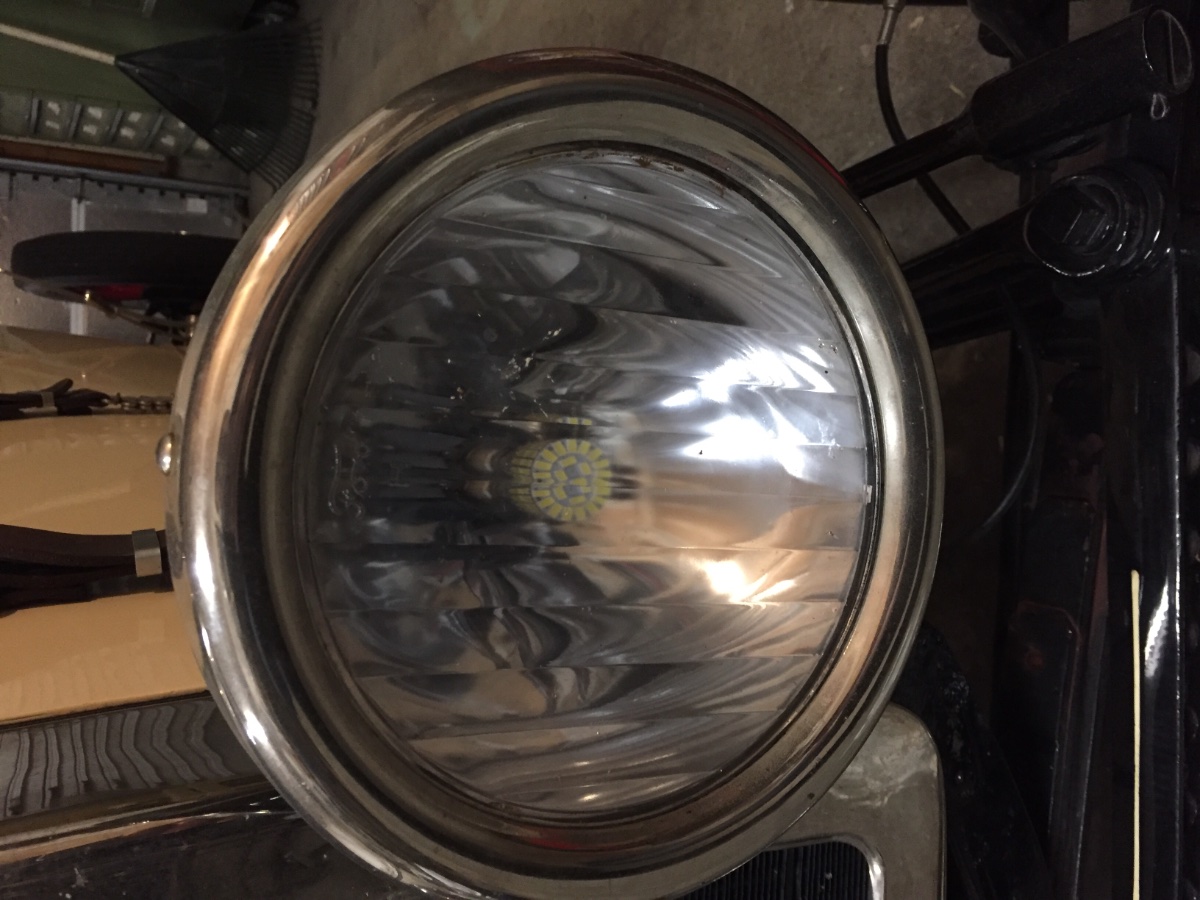

I bought both types for My 26. The round ones like kevin has seem to work the best. I have knock off logo lights from a different Co which were less than half price of the logo lights which are pricey. The problem I found with the wedge shaped lights was two fold. the lights put out a funny pattern C or a U shaped depend on weather Your sockets are original or reproductions which are mostly vertical. in My case I have a org Horiz socket one the left and vertical retro on the right which produced a C pattern on one and a U on pattern the other. Lights in My estimation are too bright and with the funny pattern oncoming drivers may flash their lights at You. With The round ones it doesn't matter which sockets You have vert or Horiz position. There is a question about how the rounds ones hold up to the vibration of a model t. Mine are doing just fine but have not been on any endurance drives. The Round Ba15D is 6 volt and very bright especially with the motor running on a generator car. The 74475 / Logo lite is 6 to 18 volts and even brighter. a little too bright except for boon dock roads with no traffic. "Your car Your choice"
