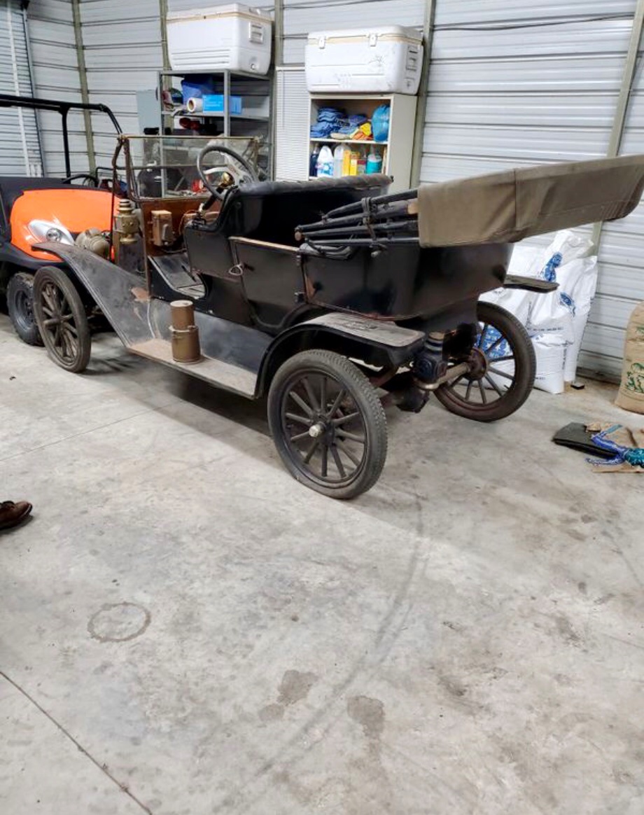

Any one ever see a rear door like this on any 1909-12 T
Topic author - Posts: 1967
- Last Name: Tannehill
- Location: Hot Coffee, MS
- Board Member Since: 2002

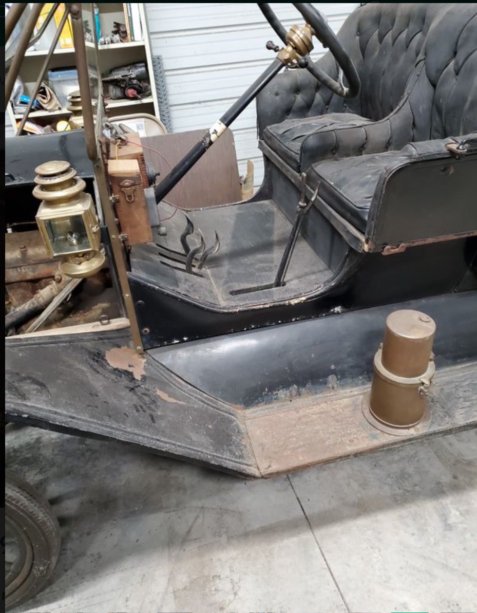

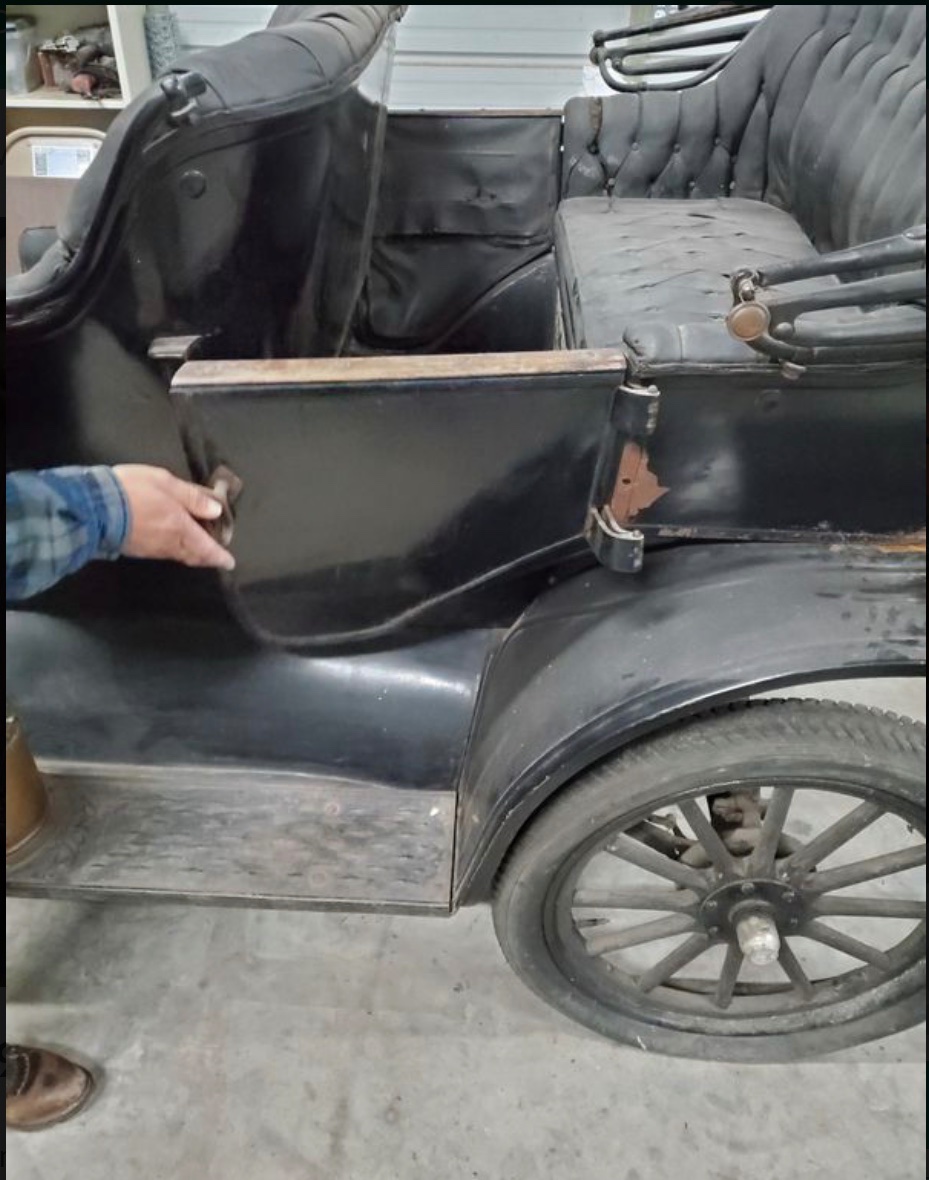

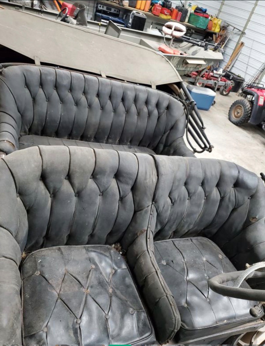

Looking at an unusual “early Ford T” to purchase. Looked more late 11 to early 12 put together. 9/10 steering column, split valve engine mid teens rear axle case and so forth. I can attest that the body is early but I don’t think Ford. What through me was the split front seats and rear doors with a slightly curved shape & bail handles. Anyone have an idea of the body?
- Posts: 4406
Re: Any one ever see a rear door like this on any 1909-12 T
What are the body mounts/brackets like? Even if they are Ford, was shimming or trimming required? Any holes or fillings to indicate other previous mounts? I am with you, I very much doubt that it was a Ford body originally.
Even Ford used outsourced bodies all through the '10s (and before), and many of the companies also produced bodies for other car manufacturers. Wilson produced bodies for dozens of other early automobiles including Cadillac and I believe I read Oldsmobile early on. Fischer in the '10s produced fine bodies for lots of companies. It was not uncommon for similarities to show upon other cars. There is a surviving Maxwell center-door sedan in very original condition. People that have looked it over closely say the body is nearly identical to the Ford center-door sedan, and original sales literature bears this out as being Maxwell original.
It sounds as if someone got a nice original body and built a Ford under it!
I seem to recall seeing an EMF/Flanders many years ago with a body very similar to this.
- Posts: 6789
Front seats: Ford Model early T (or possibly R or S) runabout. Top support holes plugged.
It's a marriage. To what/whom, I don't know. Maybe Wayne is right on the rear half. EMF had bale handles on the rear but the shape of the rear door doesn't look right for EMF.

I am still pretty sure front seat is runabout, but less sure it is Ford, though there have been some photos in the long-past which had very similar seat dividers.
