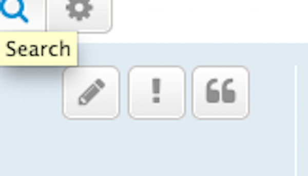

I forgot to add this was a Model A. Is there a way to edit a post?
- Posts: 7350
Re: Head gasket
Yes. Click on the pencil.
