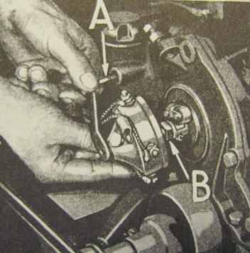

Timer is located on the front plate of the engine, passenger side, held by a spring clamp under the large bolt head on the front plate.

The commentator is also called the timer. Open the hood on the passenger side, look at where you put oil in the engine and right beside it to the right you should see a cap that has wires attached to it. The cap will have a keep that keeps the cap tight. Follow the keep toward the oil cap and you will see where it’s bolted on. You will have to loosen it a bit and slide the keep off the cap. Pay attention to where the caps orientation is. Look inside and clean out anything in it with a paper towel. Also clean around the the brush or flapper on the cam shaft. Now squirt a little oil in the timer and run it around the contacts on the inside with your finger now reverse the way you took it off to put it back on. Be sure to tighten the bolt holding the keep in place on the tip of the cap. Others may give you a better description. Hope it helps a bit. By the way don’t mess with your coils. You can really mess them up if you don’t know what your doing. Also just wondering do you have a lid on your coil box? If so be sure it’s locked on and holding the coils in place. If you don’t have a lid then you’ll need to make sure the coils haven’t lifted up preventing them from making contact on the bottom terminals. Don’t push them down with the point only push on the wood edges. Good luck.

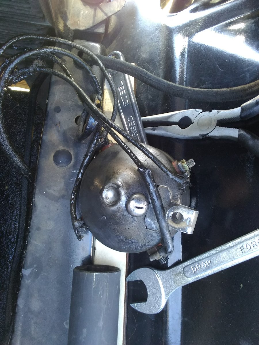

Carson, the advice on the timer so far has been excellent, or it hasn't, depending on which timer you have. Can you get a picture of it so we'll know what we're talking about?

That's my timer. The guy I bought the t from replaced it before. He says a tiger brand timer. I pulled it off and noticed a nut was very loose. Could this be part of the problem?

The nut that holds the brush on the shaft? In a word, "yes" it could cause problems if loose. Also check that the contact surfaces are clean.

It's a Tiger and a later imported repro, at that - orange colored insulator is how to tell from a vintage Tiger which has a maroon insulator.
Runway/raceway looks a bit funky also.

What is the runway/raceway?
Posts: 5592
Re: model T problem
Post by RajoRacer » Sun Feb 23, 2020 4:06 pm
It's where the roller runs around in a circle. That needs to be very smooth - no ruts or bumps or ?
Posts: 5592
Re: model T problem
Post by RajoRacer » Sun Feb 23, 2020 4:07 pm
Oh, what nut was loose ? A contact wire terminal nut or the roller retaining nut ?

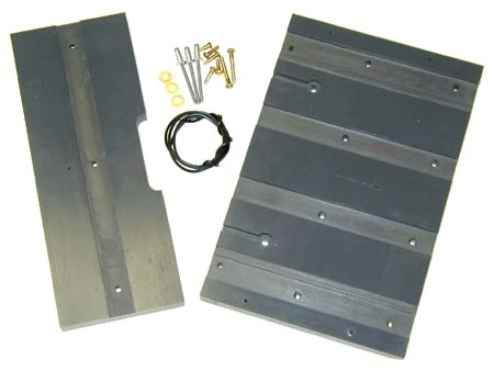

Rebuild the coilbox with the plastic kit from fun projects. Readjust coils properly on coil tester. Make sure timer and wiring connections are all correctly functioning. Otherwise, you will be chasing your tail for a bit.

One of the 4 nuts on the outside that holds on the wires was loose

It was the contact wire terminal bolt was loose. Oh, and the timer had a bunch or crud in it, so I cleaned it out and put it back on and put in a newer plastic coil, and now 2 coils buzz every once in awhile.
