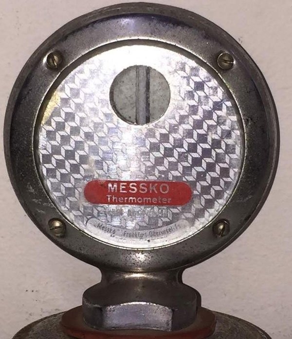

Re: Is my MotoMeter normal?
The first motometers I bought were made in Germany with MESSKO name plates. The tube is oriented to be read from the right hand seat rather than the left hand seat. This was in the '60s.
I'm sure there are many still around with the face plates replaced.
