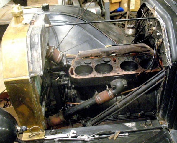

... maybe this was the reason.
I checked all the usual stuff I could think of: plugs, timer, manifold leak, float level, etc., etc. But there was one thing I forgot. So today Mike Bender came to take a look at it. Even with a less than wonderful compression gauge, it didn't take him long to diagnose the likely trouble — a head gasket leak. When we pulled the head, sure enough, it showed a leak between #3 and #4. And why would that happen? Removing the head bolts was too easy. Apparently some absent-minded old man forgot to retorque the head after last year's engine work. It's a bit embarrassing, but it's also a relief to find something so stupid and simple and easy to fix. I'll clean everything up and reinstall the head, correctly this time, and see how it goes.

Do check to see that the head bolts aren't bottoming out. They can stretch and torque right without cinching the head down. This allowed my gasket blow behind #4 cylinder after several miles.

Best I can remember the old bolts can stretch to,Tight as I am I try to use new headbolts when i get a motor together so at least long as I have i know the bolts are old and stretched.

Use a straight edge and be sure the head didn't warp, you don't want to trash another gasket.
