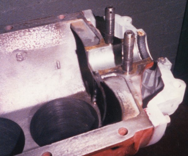

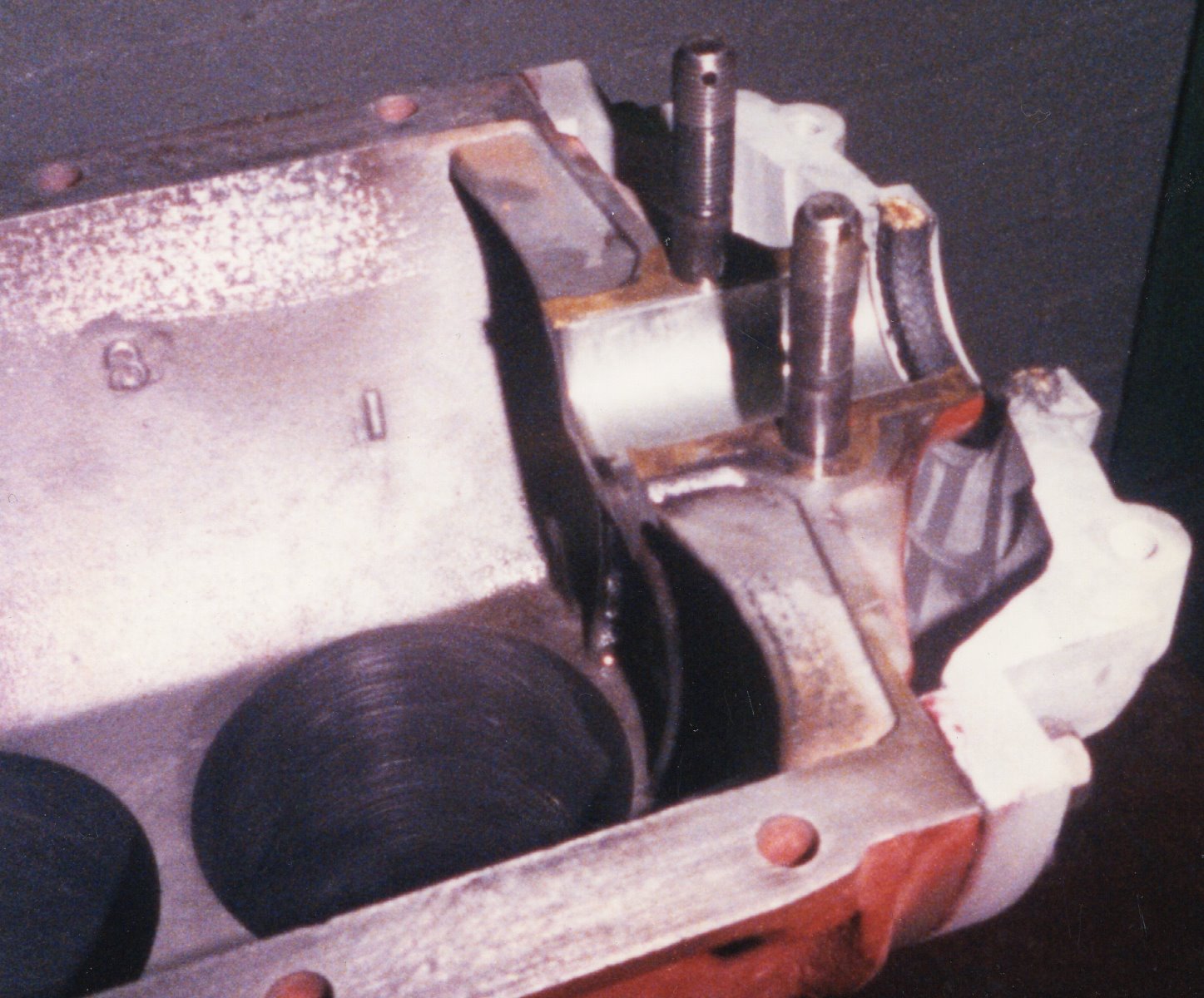

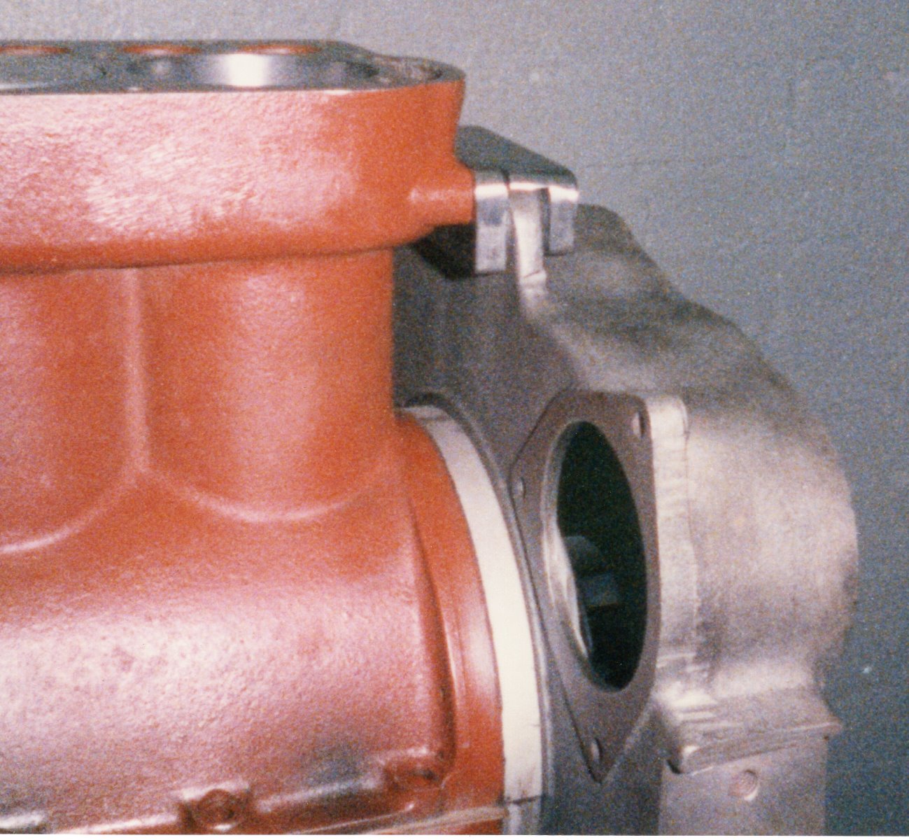

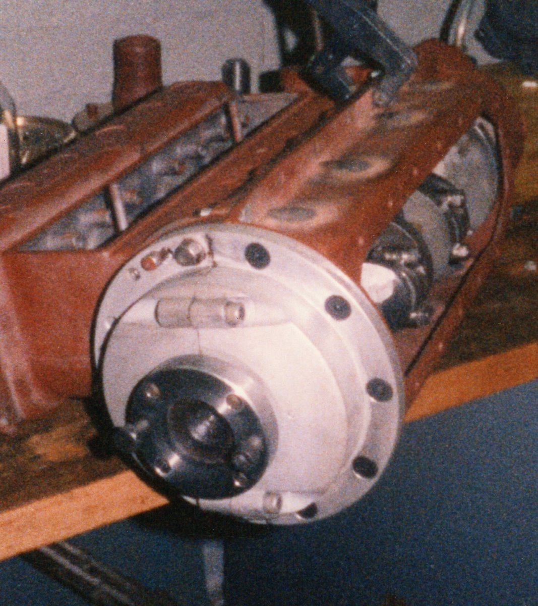

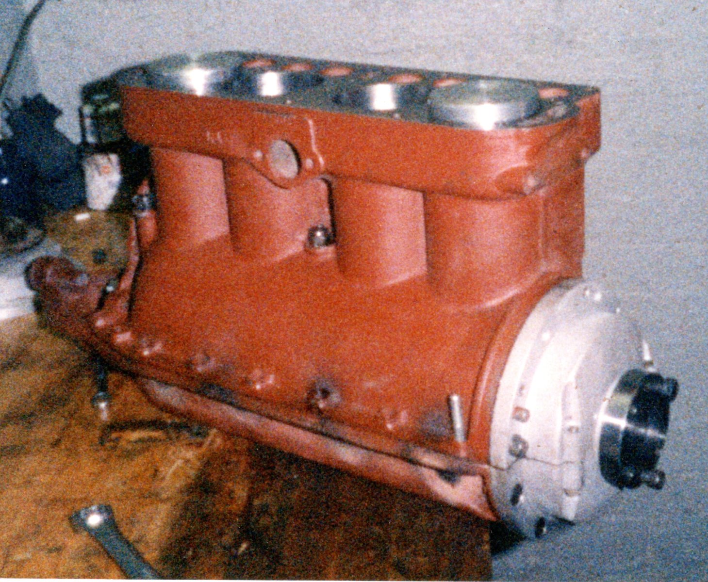

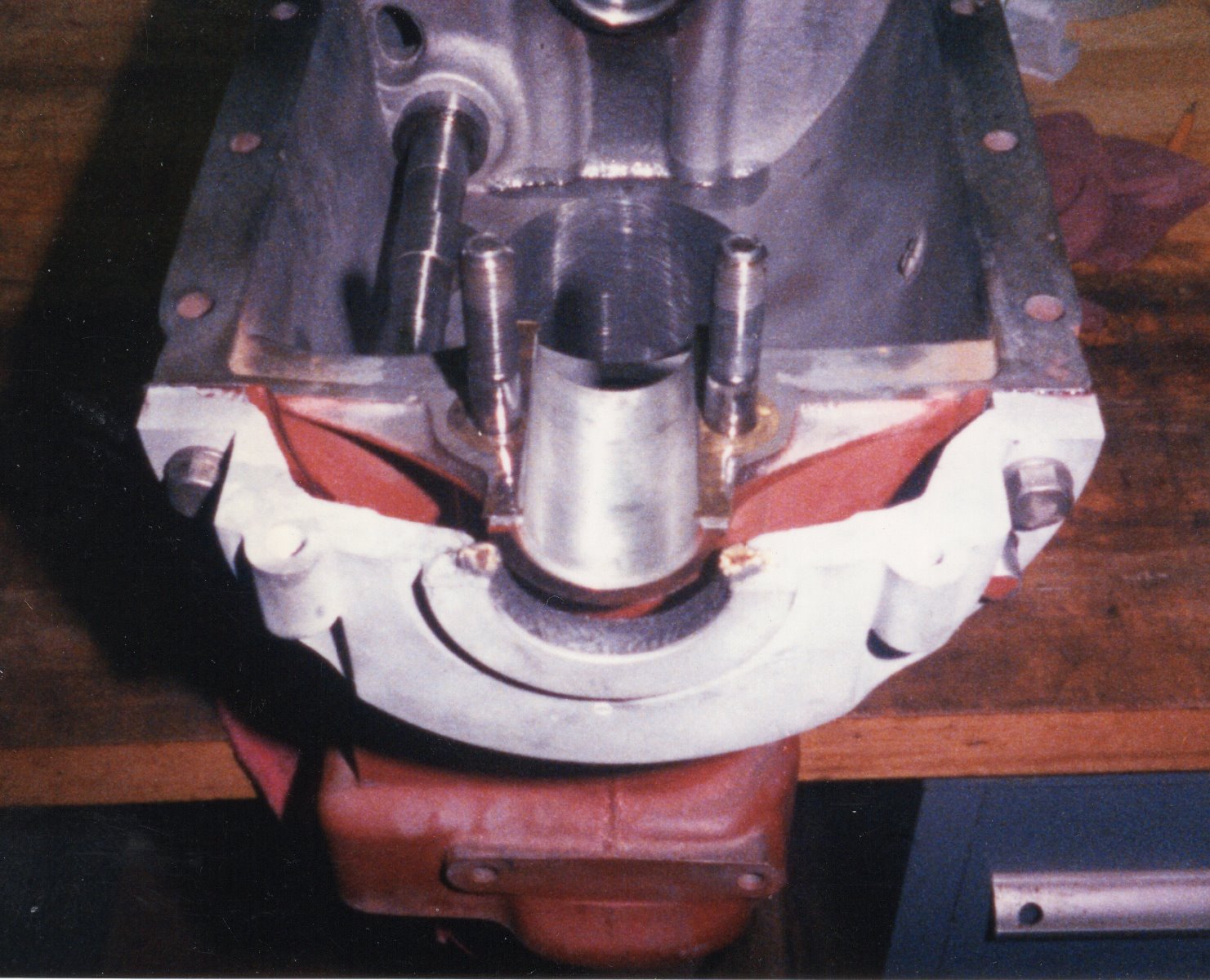

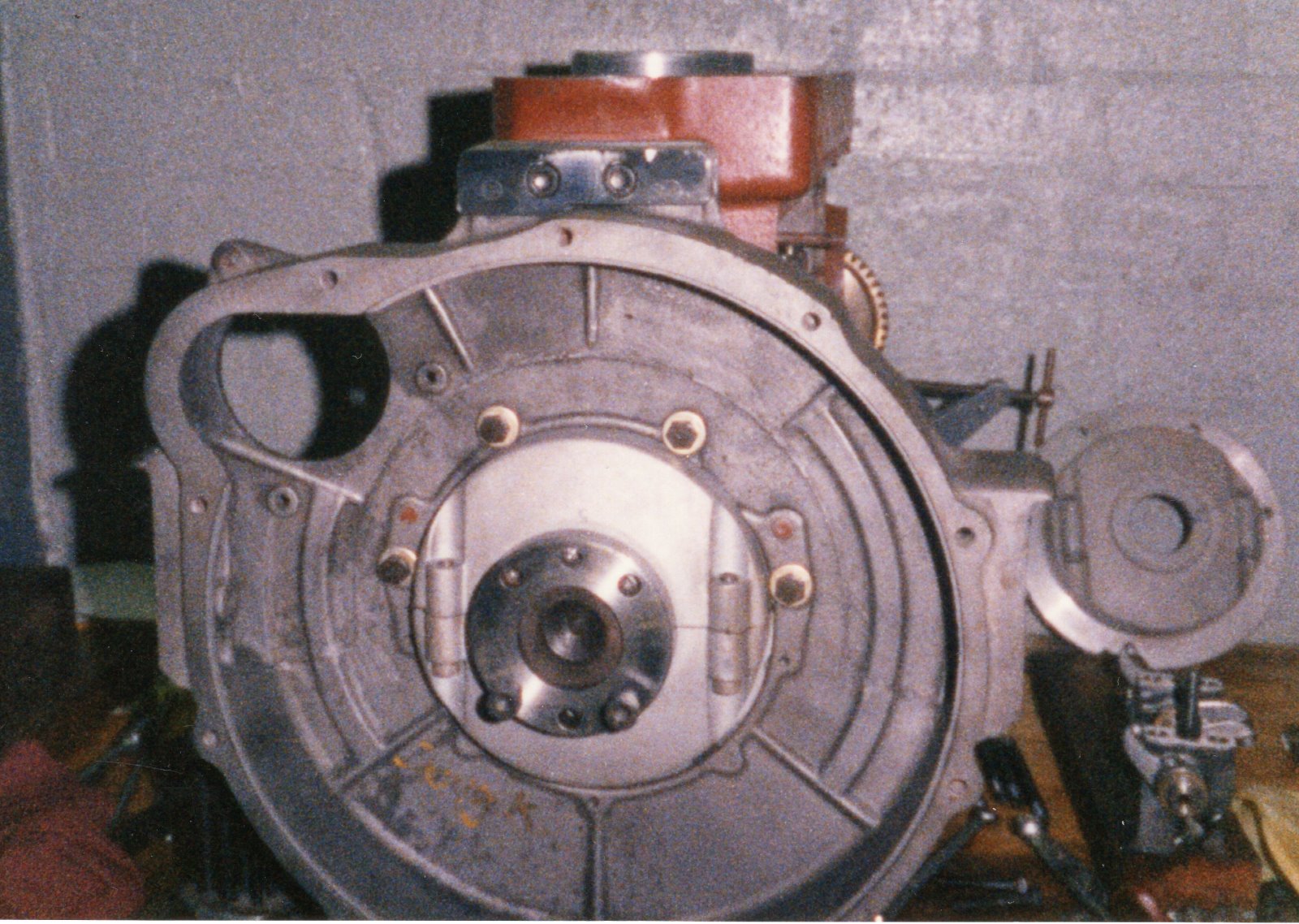

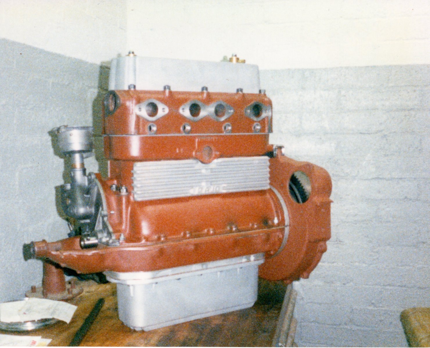

Ok- here are a few pictures of my seal setup- pretty much self explanatory. The last picture shows the extended crank flange necessary to position the flywheel properly. The flywheel in this engine is a lightened model A with a V-8 pressure plate. Crank is model A with a full length rear main. I'll post a few more later.

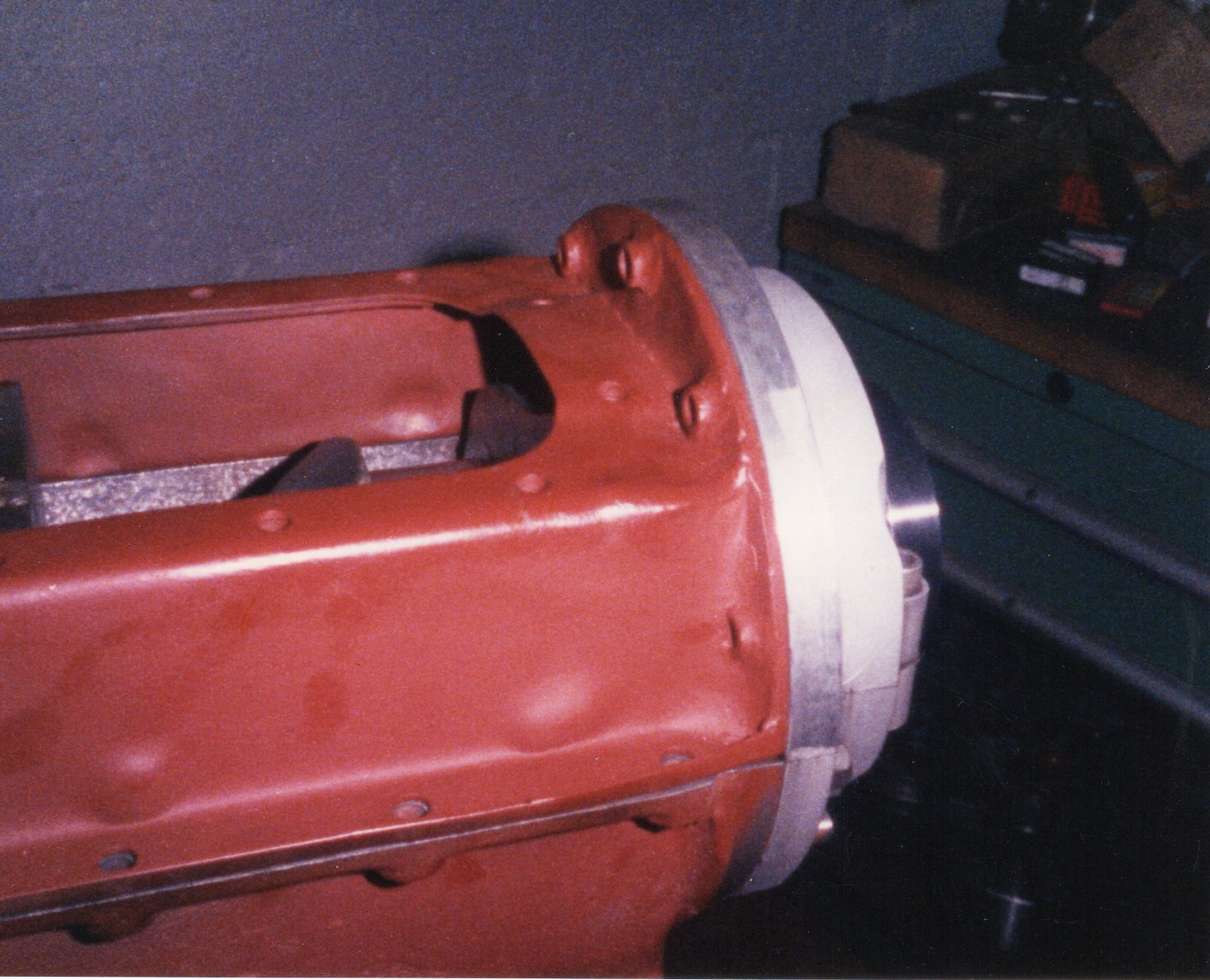

Here are a few more pictures.

Dan, Per our phone conversation a few days ago, you were absolutely right, the pictures are worth a thousand words. THANK YOU!!! I am Definitely still interested in one of these for my "A" crank build.
While thinking about this earlier today for the "T" crank usage, I actually had a similar thought of something that is sort of like yours for the "A" crank. The problem with a "T" crank is there is no real seal surface for a seal to ride on other than the rear flange. But with some calculations I have done that may be perfectly viable.
Thank You Very much again Dan for sharing, I hope you can get a few cast up soon.
