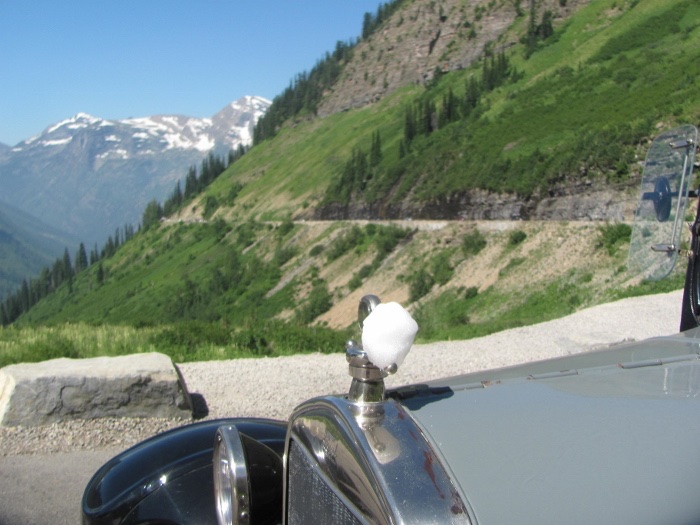

Have the Prus head on my '27 touring, and love its performance in flat Florida. Think just having more umpth over stock Ford iron head with high compression head would make things happy.
Have to say, reaching high altitude didn't really affect driveability of my touring in Montana, easily climbed up the Road to the Sun.
Snowball on the dogbone cap, ran thru some deep drifts
