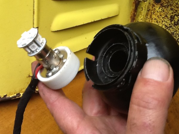

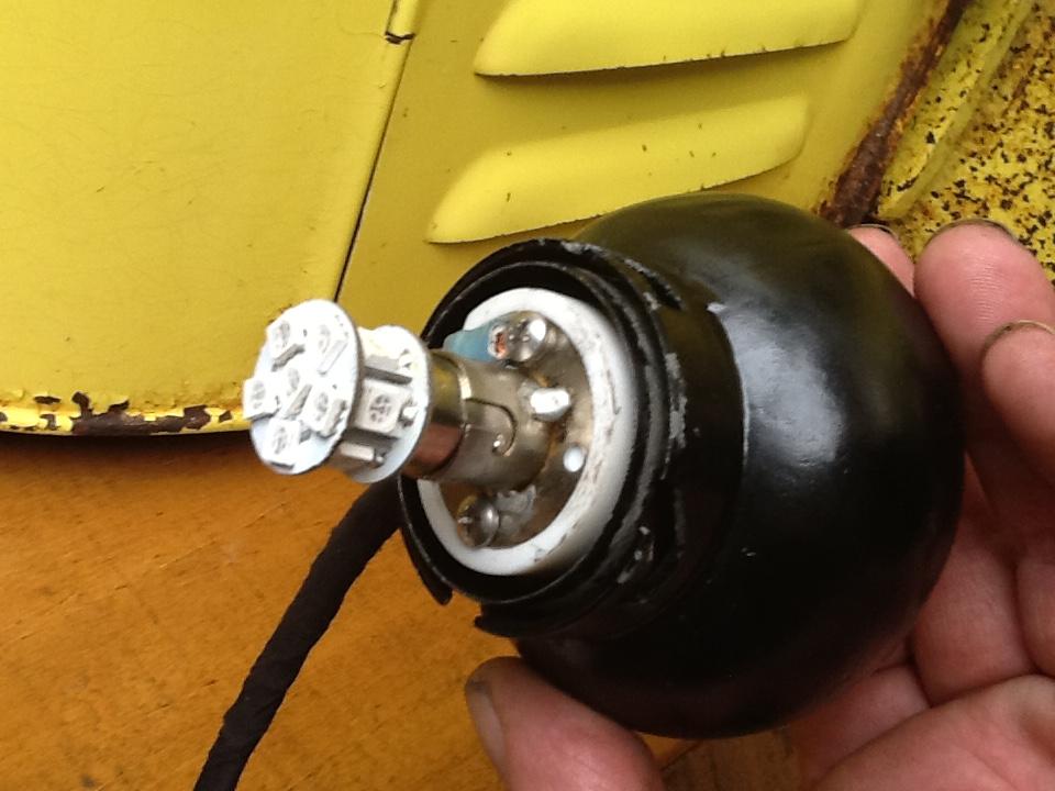

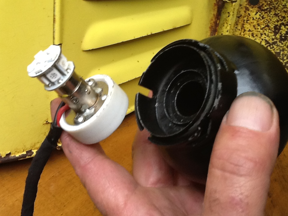

I made these some time ago, to convert my side lamps to blinkers with LEDs, took a block of i think nylon and made it the same height as the burner assembly, that way the tank holds it in place, the wires go out the slot where the fegulator knob normaly goes, you don't have to butcher a good sidelight and you can convert back to kerosene in about two seconds, only thing is you have to find a way to make the wires look inconspicuous (did i spell that right ??) :roll:

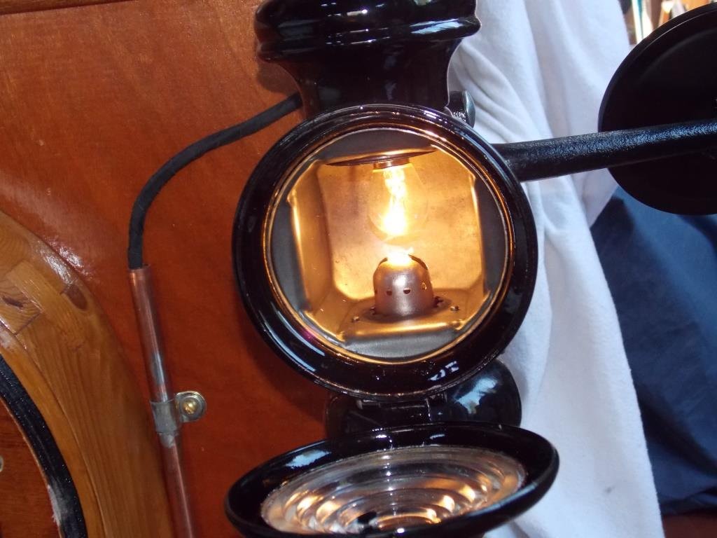

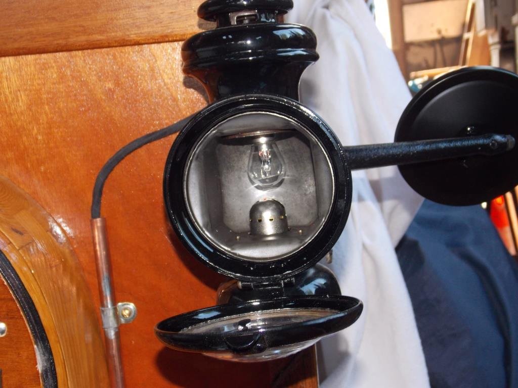

Here is how I did mine.
Lamp is 5/21W 12V.
Wiring enters by the chemeny, no hole was drilled.
