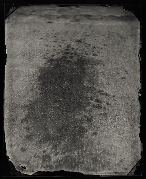

So let me start off with, I drive this car a lot! I would guess between 3.5K and 5K miles most summers. I did not need to do an oil change this past summer, I just had to keep adding oil :( so I need to fix the issue, as the carboard under my T was highly soaked in oil, and left her mark everywhere. I put two small catch pans under the T last fall when I parked after the last trip, within a week I collected about 3/4 cup of oil in the two small pans. Most of the oil was collected within a day or two. One pan was under the starter weep hole, the other under the drain plug (low point). As winter progressed, no more oil has collected in the pans.
Up until this past summer, she would mark her spot, with a few small droplets. But it's becoming a puddle.
I feel that the leak is coming from near the Starter. The oil pan on that side from the starter to the drain plug is really wet with oil. I have not found the source. The area under each of the peddle shafts are dry, as it the area around the Hogs Head inspection cover.
I thought it was the starter as it was dripping a ton of oil from the weep hole. - it was rebuilt, with modern seals. The leak maybe less, but still leaks, and the weep hole always has an oil droplet forming.
About the same time, I replaced the gasket on the drain plug. New copper crush ring. No noticeable change in the oil leak.
This past week I pulled the oil pan. I found the previous owner painted (primed and painted) the mating surfaces. Ground the paint off, and reinstalled, with new gasket and Permatex. Also installed the Texas T neoprene washer set. - no clue if this will help. The engine rebuilder had used the cotton string method to seal the bolts, there were lots of oil buggers hanging from them.
Sametime, replaced the oil drain plug with a new magnetic plug and copper crush gasket. Wondering if a neoprene O-Ring would be a better choice?? (I have not added the new oil yet, so there is time to make a change)
Next thought, it could be leaking from is between the block and the pan. If they painted the oil pan flanges, why not these matting surfaces. I really do not want to pull the engine! I can tell they used Permatex on the surfaces. Some of the bolts have a lot of oil buggers growing on them. I'm thinking of pulling the bolts one at a time, and doing one of two things. Clean the bolt and reinstall with a little Permatex to help seal the hole/threads. Or look to see if I can purchase and install the similar neoprene washers, as with the oil pan. My concern here is ensuring the engine block and pan mesh up correctly, and secured together.
Any thoughts on places to look or tips to reduce the oil loss? Thanks

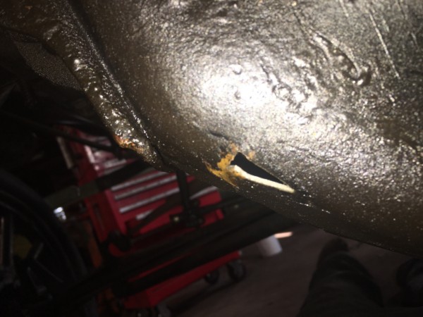

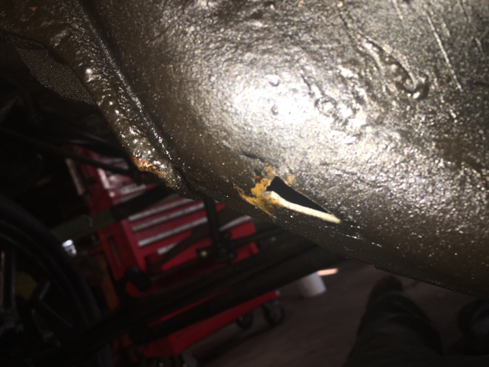

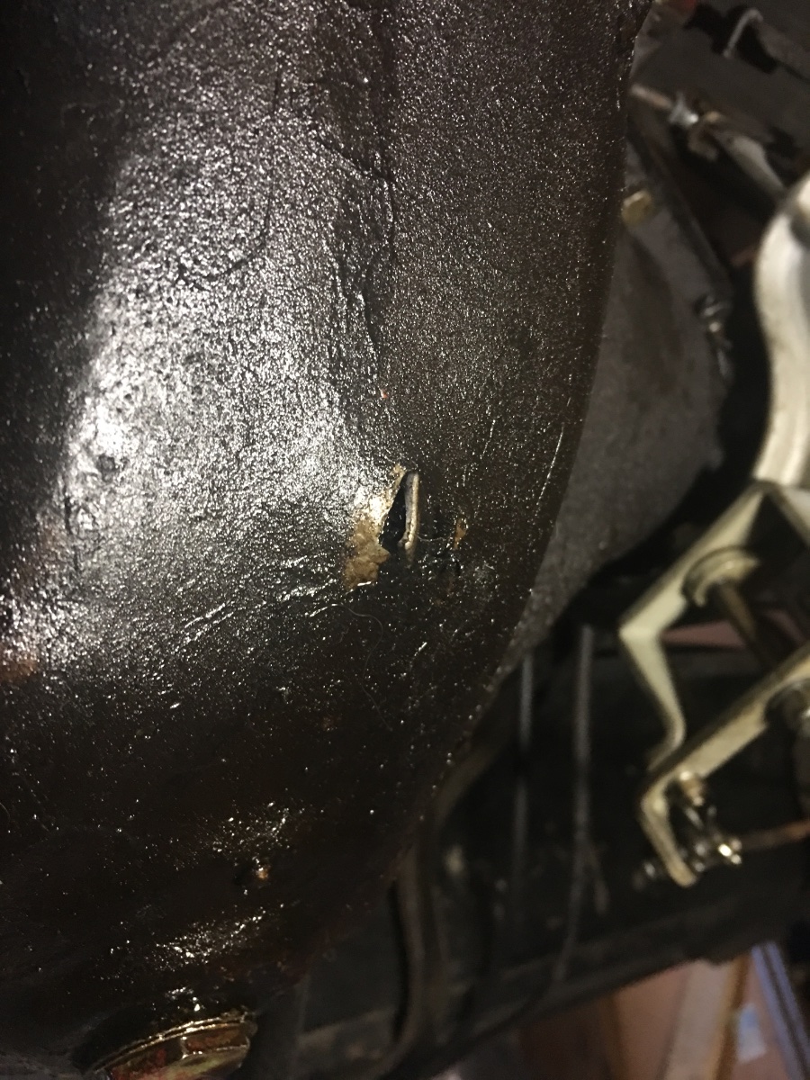

The reply about the lack of oil leaks reminds me of a The Centerdoor currently in the workshop. A magnet broke with lots of damage (story for another time) and it lost oil and then the leak stopped.
Here is why
Yes it lost all the oil thru the holes in the pan 😊😊

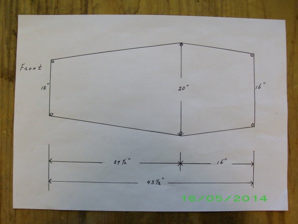

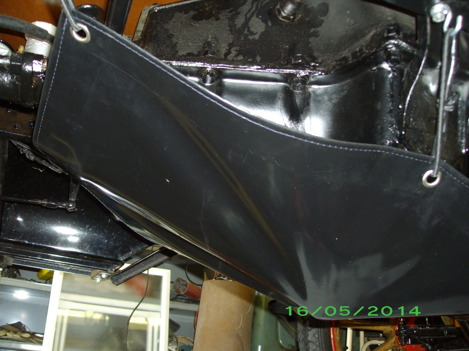

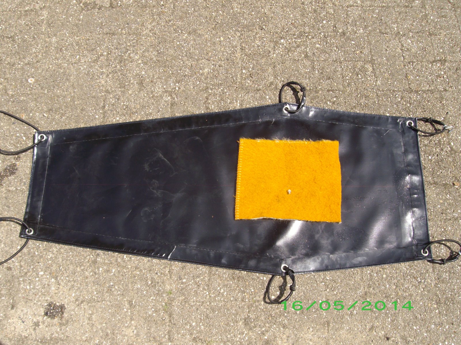

As our Model T also mark her territory ,
I made a diaper for her.
Toon

The oil and dye are in the engine, but I have not had a chance to run the engine as it has been to dang cold to leave the garage door open and snows when I have a chance to pull it out onto the driveway, so it is staying in its warm stall.
However, I grabbed the black light, found one oil leak, the lower peacock valve for checking oil level. It is leaking around the threads. Feel like draining the oil, pull the valve and re-seat it, before starting it up. It is not a lot, but there is a small droplet on the drain plug.

The art of model T oil drippings
