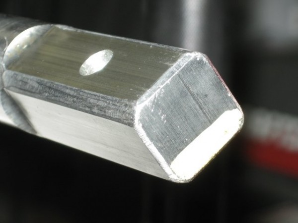

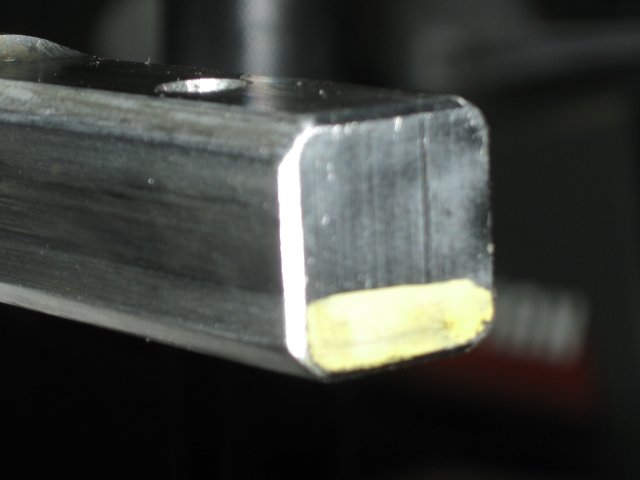

There are 2 issues that I found with the newly made drive shafts, both on the machined square end for the universal joint. The first is the chamfer on the end, they only chamfer the edge of the machined flat surfaces and ignore the "corners" that are left (I apologize for the photo quality, it is the only one that I have):
Be sure to chamfer those four corners. If you look at an original Ford Drive shaft versus a modern made drive shaft you will see that Ford chamfered the entire leading edge and the newly made ones only chamfer what they machined. Those sharp edges can/will dig into your nicely reamed bushing and raise some material and create a bind.
Second, you may need to dress/break/reduce the aforementioned corners down their length to get the u-joint to fit. If you look at an original Ford drive shaft, they not only machined the flats for the u-joint, but also the corners that were left. The new drive shafts leave the corners at a 1.000" diameter and that can create an interference problem when trying to install the u-joint to the drive shaft. Check your u-joint fit to the drive shaft end and if it is tight or does not want to go on, that is your problem. On the original drive shafts, these "corners" were machined flat. Aside from those 2 issues, the drive shaft is excellent, they just missed a couple of steps.

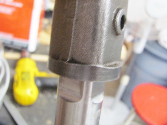

Post by DanTreace » Fri Feb 28, 2020 9:15 am
New driveshaft sticks on the way into the new reproduction U-joint.
IMG_7944 (550x413).jpg (87.88 KiB) Viewed 7476 times
Arthur
Have the same fitting issues with reproduction parts, it happens. We can't go get NOS factory parts anymore, but sure glad reproductions are available.
Of course in a perfect world, new parts would fit, but many times a bit of 'custom' fit is necessary,
On the new driveshafts as noted, the chamfer isn't there, so you have to file it to shape, easy to do as the driveshaft isn't hardened steel, its soft.
Same with the square end, the flats aren't in dimension either to fit to the new U-joint or maybe the new U-joint dimensions are off, either way custom fit it. There's no filing on the new U-joint, its hardened steel!
So get out the mill bastard file and drawfile the 4 flats down some so that the female U-joint slips easily, all the way to the bottom, remember to add a bit of grease on assembly to the flats.

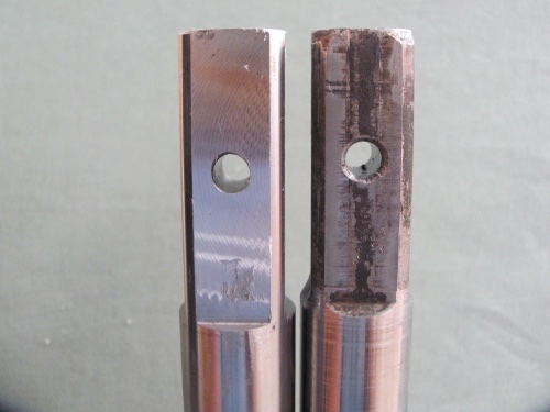

IMG_7978 (500x375).jpg (71.6 KiB) Viewed 7476 times

Post by CudaMan » Fri Feb 28, 2020 9:25 am
Dan's photo shows another feature of the currently available driveshafts that cause me to worry - note that the blend radius at the base of the square section is much tighter on the reproduction than the original. That could increase the stress at the fillet, increasing the chance for a crack. :(

Post by Pep C Strebeck » Fri Feb 28, 2020 11:29 am
Radius? What radius? The most recent drive shaft that I had purchased (September of 2019) looked just like the one on the left in the photo that Dan had posted. There is no radius to speak of, almost a square corner. The vendors website descriptions state that these are made to Ford specification and all dimensions are correct, but they do not say "made to the blueprint".
There are obviously a couple of fitment and dimension issues due to them not being made to the print, and these could be easily corrected, the vendors just need know about it. As I had said in my earlier post, the new drive shafts are excellent, with the exception of a couple of small and correctable issues. These issues could be sorted-out/corrected on new production.
As for Mark's concern about the radius, I agree, there should be a radius there. A radius reduces a stress point where a crack or break will/can form. As made now there is no radius to speak of.

Post by ArthurB » Fri Feb 28, 2020 7:26 pm
I got my drive shaft from Fun Projects. It has a nice blend radius at the end of the mating surface, and the chamfers were fine. The only obvious difference from the original Ford script driveshaft was that it is smooth and shiny the entire length instead of just at the bearing surfaces. I don't know who makes the shafts for Fun Projects, but it definitely looks nicer than the one Dan shared.
I'm confident my problem is the reproduction u-joint. I'll decide this weekend if it's time to touch up with a file or look for a good old part. Thanks for all the advice. I'm much more confident I understand what's going on.
