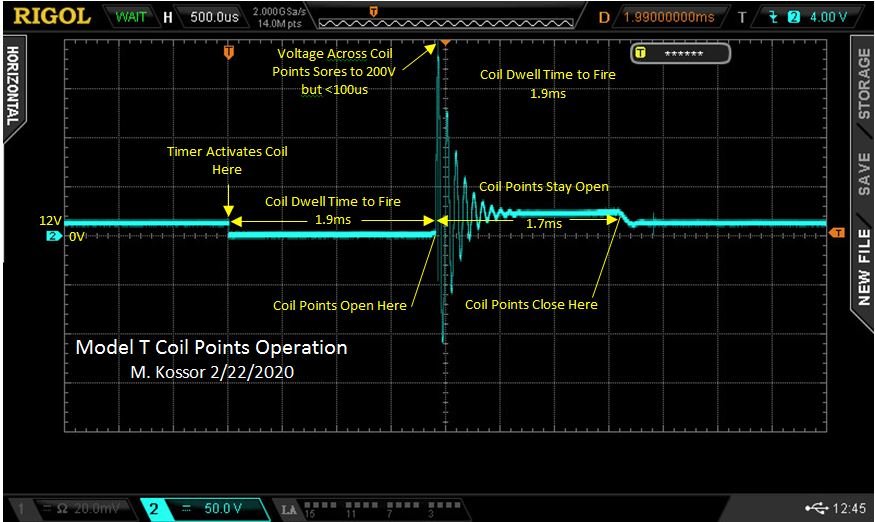

Regarding the question: Can You Get Shocked Touching Operating Model T Coil Points?
The answer is YES. Here is the measured voltage that develops across a Model T coil operating on 12V battery during operation, note that the peak voltage reaches 200V but only for a very short duration:
Will you get shocked? The answer is; It depends. The variables include:
1. The voltage develops across the coil point contacts so touching both point elements present a shock hazard.
2. The voltage also develops between one point element and Engine/body ground so touching that point element and Engine/body ground presents a shock hazard, which could be even more dangerous if electrical current passes from one hand to the other as it travels across the chest.
3. How moist your skin is a factor in making good electrical contact with the coil point elements and/or Engine/body ground.
4. How tightly you touch/squeeze the coil points and/or Engine/body ground is a factor in making good electrical contact with the coil point elements and Engine/body ground.
This may explain why you received varied input others based on their experience.
