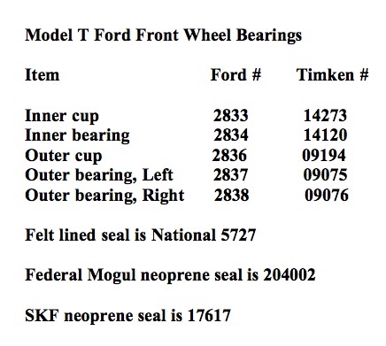

This should take care of replacement bearings, races and seals for the front axel. All are readily available. I get mine from Fisher auto run by Federated Auto Parts.
Brad

Here is something found some time back.
MODERN DAY REPLACEMENT PART NUMBERS.pdf
(70.01 KiB) Downloaded 339 times
(70.01 KiB) Downloaded 54 times
Excellent! I'm saving that for sure. I didn't know about the carburetor floats and some of the other items.
