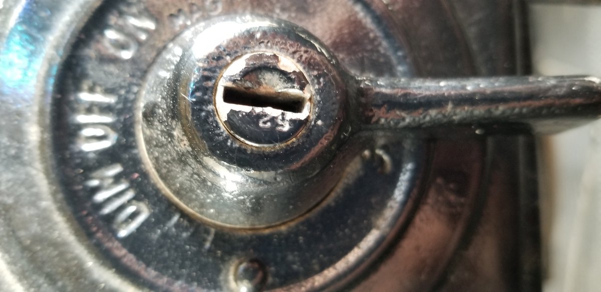

What year? 1919 up easy with stock switch, just look at the face of the switch, the number should be right there.

Ok look at the switch.

John, As Mark indicated you should find 2 numbers on the switch face and they ranged from 51 to 74. If the number is 55 it may be a modern replacement, except for a modern #55 you should try to find an original key or older replacement as the new replacement keys from the vendors do not seem to fit well in the older switches. The original or older keys should be found for about $10.

It looks like 52 to me. Anyone concur?
Re: Ignition key stolen!
Post by Norman Kling » Sun Mar 01, 2020 3:25 pm
Looks like a 52. If you know someone with a 52 you can borrow the key to see if it fits. If not, the price is not too great, so you buy one and see.

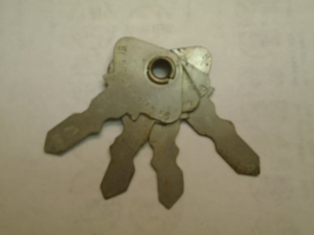

There was masters available at some vendors key nos. 51 - 56, 57 - 62, 63 - 68 and 69 - 74 all in a crimped set.

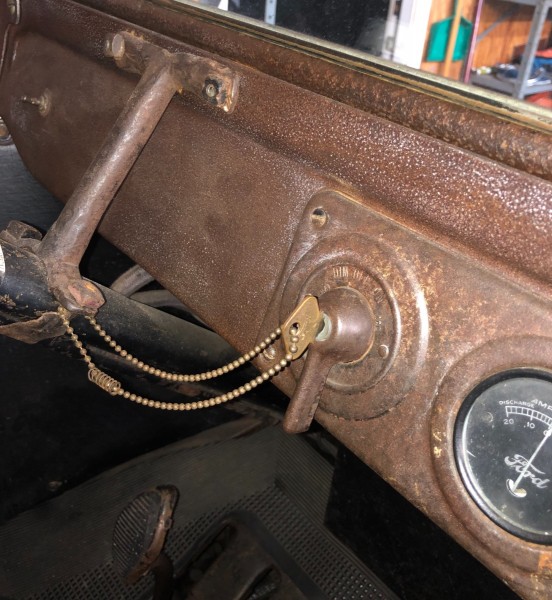

Key is chain secured.
Keeps quick passerby from pocketing 'em. :) Always in place for fast get away. 8-)
Never known to fall into the transmission abyss when adjusting the brake and reverse bands. :o
