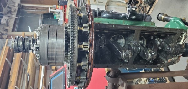

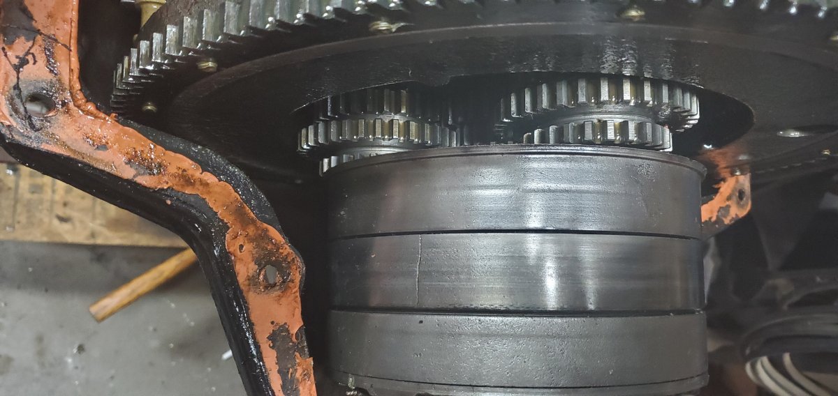

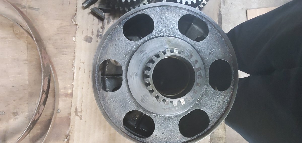

Towards the end of the season last year I had to adjust the low pedal band several times had a feeling something was up.
Will post more as I progress.

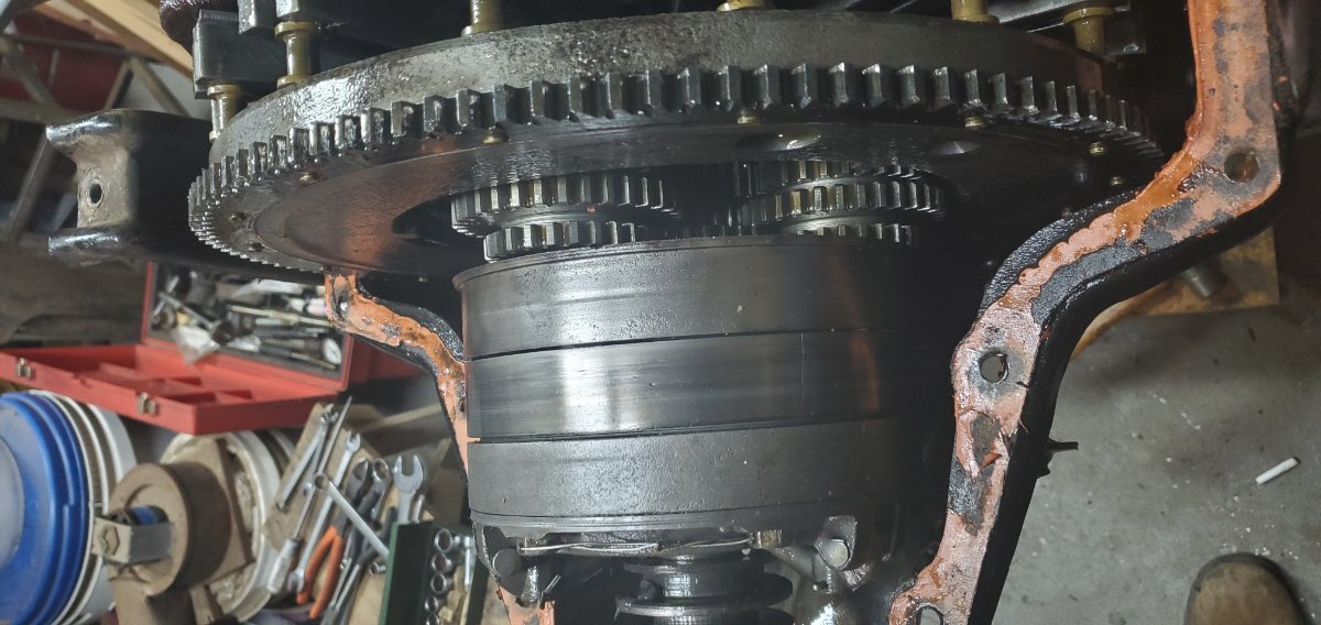

WHAAA...?...assuming you have a Canadian T
(as I see by your RH steering column); were the manifolds really on the left side of the engine ??

Re: Transmission Disaster avoided
“Selfie” mode does that!!

Yup selfie mode I didn't realize it reversed it.

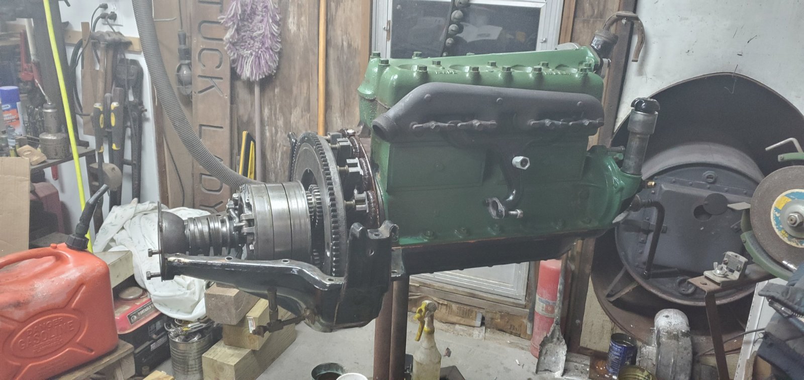

Almost 12 Hours after Discovering the cracks have it ready to pull transmission apart. Will have to wait for another day.

I doubt seriously you missed both of those cracks when you rebuilt it.Something happened in that 7000 miles probably
Just looking and thinking,you wouldn't need to remove the trans from the engine to replace the drums would you?

Thomas, you should really consider looking for a better transmission. Pitting on both brake and reverse is too severe for me to consider putting into anything of mine ...I'd start searching with a WTB ad in the PARTS forum.

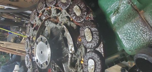

Lots of fuzz to clean out. Be sure your engine oil line is clear.

It gets in everything, can block the oil holes in the mains and even get all tangled up in the oil rings.

I have 5 other transmission Sets to look through hopefully I will find good drums with those.Yes there was fuzz everywhere Amazingly somehow the internal oil line was still clear the mag most oiler was plugged up.I will remove transmission leaving flywheel on engine,Everything else looks good was a good runner good compression will probably check bearing Clearances while I have it apart.

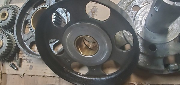

You might already know this but when replacing a cracked drum with with another one good used drum can sometimes cause a noisy transmission. Not always but sometimes. It happened to me after I had rebuilt T transmissions over time with no major noise issues. I had read about it here on this forum but no issues until the last one.
Its probably best to replace with with a set instead of individually but that’s up to the individually.
In my case I had used a low speed cracked drum with a ‘good’ drum that after looking closely had a very slight worn drum gear. It looked to me that it was ‘worn’ about the same as the other good drums but what a difference it can make as far as noise goes!
It had a whine that wasent all that bad but I went ahead and found another that was a better match and quieter. All OK now but maybe I got lucky.

The bluish color of the drum is a key that the band has been dragging. This is usually caused by a worn notch and cam on the low pedal shaft. This is what happens. You have to tighten the low band too tight in order to get the band to lock before the pedal hits the floor board. So the band drags all the time you are in neutral, high, or reverse. It only stops dragging when the band is tight in low gear. That continual drag overheats the drum which gives it the blue color. eventually the drum cracks. So even if you replace all the drums and get new bands you will still have the same problem until you replace the notch and cam. I know this from experience after breaking two drums on the same car. I have not had that problem since I replaced the shaft, cam and notch.

On the top picture looks how worn smooth the low speed drum is..maybe indicating a significant drag ?

The color of the drum in the photo is misleading it is Not blue Just shinier than the rest because it gets the most use, reverse Drum not so much brake drum not at all. When I got the car it had Rocky Mountain brakes installed and the Ford transmission brake was not used. I know there is opinions pro and con to this practice But so far it's worked out well. When I rebuilt the motor and transmission I left it that way the only thing I changed was putting lined emergency Brake shoes on So that when stopped Uphill it would still hold. Can't always count on those rocky's holding backwards. Cam and notch Where replaced when I rebuilt it and still look fine whenever I adjusted the band I always made sure that I had a free neutral If the band was too tight I would not be able to roll the car back-and-forth by hand due band drag, I think would someone please correct me if I'm wrong on that point. In the warmer months I use the car pretty regularly and I am thinking Due to too much slippage When I put the car away, I keep it in a cargo trailer sometimes I probably slipped the low band too much going up the ramp.

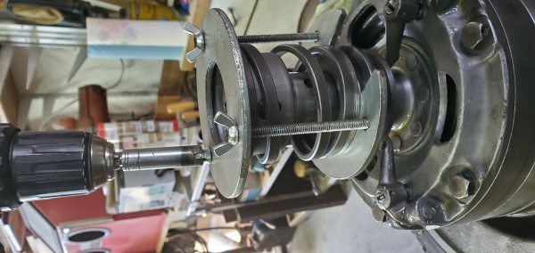

Yeah Bob it's been a busy Winter just discovered this yesterday don't know If it's possible but going to try to get it together for the Westhampton Saint Patrick's day parade in 2 weeks I think. Wish me luck.

I know it could get noisy with a drum change but I will hope for the best. I have at 1st glance what I think is a nice looking set of drums from a later model transmission can anyone tell me for shore I believe they are the same as the earlier low and reverse drums Or are there differences.

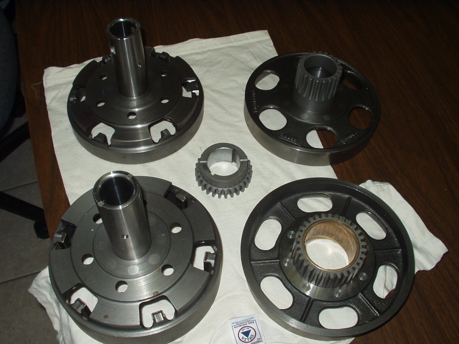

The Low speed and reverse are the same throughout the Model T years.L.I. Tom wrote: ↑Mon Mar 02, 2020 4:46 pmI know it could get noisy with a drum change but I will hope for the best. I have at 1st glance what I think is a nice looking set of drums from a later model transmission can anyone tell me for shore I believe they are the same as the earlier low and reverse drums Or are there differences.
Your pictoral example is the reason why we started making and selling drums.

Really nice looking stuff, John
Thanks for making them.

John they are beautiful I have seen them, one day I believe I will own a set but not yet. Thank you for the info on the high and low drum application.

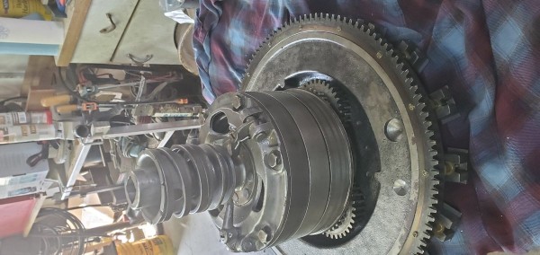

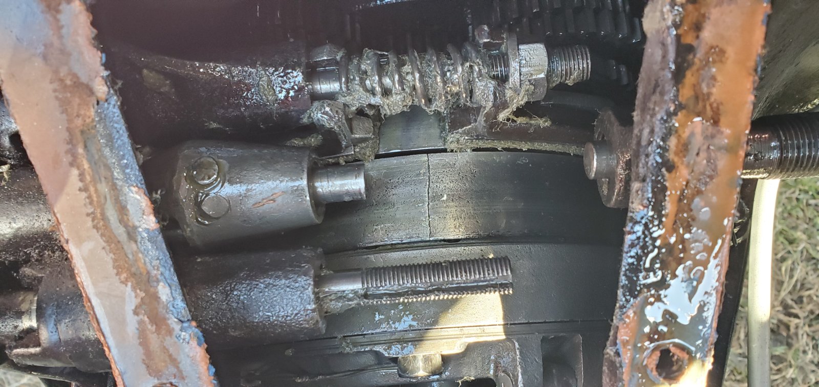

Norman you are absolutely right and I was wrong My apologies. Here are some photos it got hot at some point I'm thinking probably Slipping it when I'm going up into my trailer. Here are a few pictures

I don't follow that the first gear drum gets most use. In proper use, there is band slippage only until the band is clamped to engage bottom gear fully.
The brake band however, slips constantly under varying loads, unless the back wheels are locked up! The brake band is also used more frequently than the first gear bands
It is nice to replace the brake drum and driven plate from the same source, as the outer edge of the driven plate forms part of the braking surface It is rare that two components from different sources match, causing a step in the braking surface.
Hope it turns out well. Allan from down under.

Put together some decent drums with no cracks, new Bushings where needed cleaned up the gunk putting her back together.
