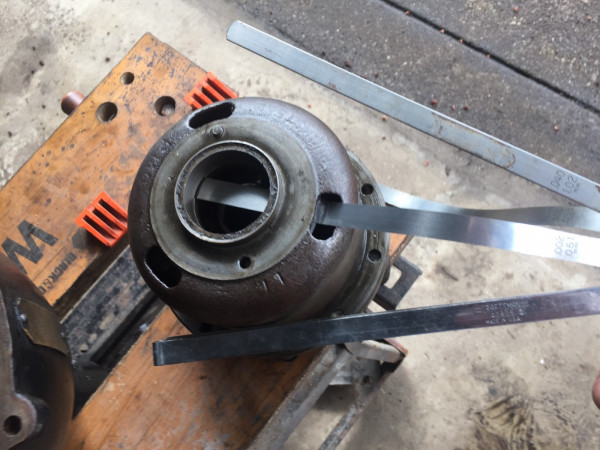

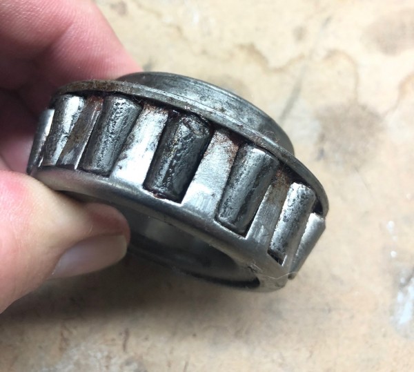

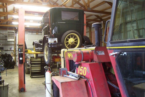

I was able to figure out how to get Clarabelle on the new lift so decided it was a good time to pull the front wheels so I could clean and repack the bearings. I had pumped new grease in when I first bought the truck. Thanks to info on this forum, I was able to get the inside bearings knocked out. Once I cleaned them up, I was glad I did. The outside bearings and races were perfect, the inside not so much. I suspect the previous owner had not taken time to remove and repack the inside bearings with any regularity as they both looked pretty rough. They had newer dust seals but obviously there had been moisture sitting for some time.
- Posts: 6642
Re: WHat Have You Done To Your Model T In March?
Bruce
Love the shop and the truck. I am slowly becoming a fan of T trucks...yours is a beauty.
Re: Bearings - time well spent. Races, bearings and seals are not that terrribly costly and well worth the time to R&R. Good catch.

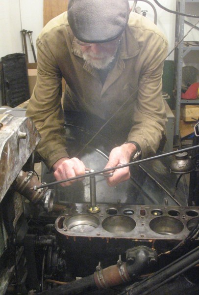

Took time out from other stuff to work on valves a little more.
How do you reach those two way in the back?
Put a spring between the shaft and the cup and wrap Gorilla tape around it to keep it on.
Put some Gorilla tape in the cup to grab the valve.

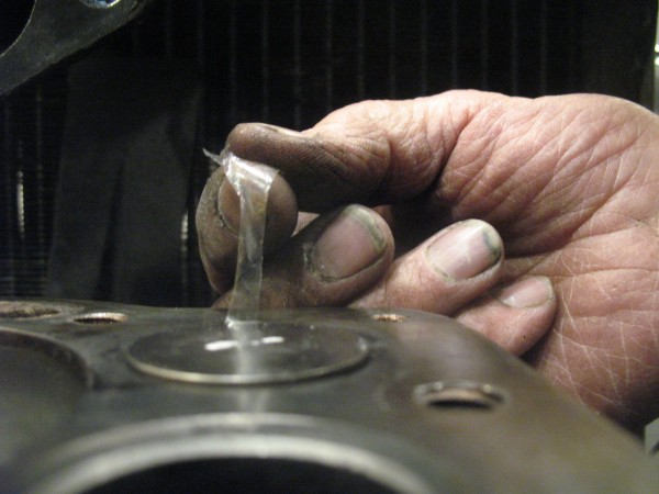

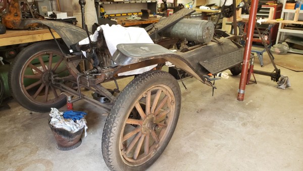

Still working on getting the fenders, splash shields and running boards on nothing lines up with out a lot of grunting and some drilling.

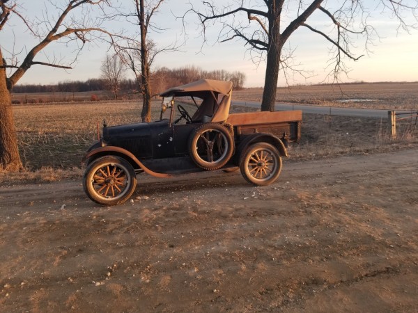

- Posts: 2835
- First Name: Dallas
- Last Name: Landers
- Location: N.E. Indiana
Had to drop some things off at the job site.
This was laying out the house last fall.
This was today. The T is still on the job.
- Posts: 7376
Dallas, I love the early Sunday morning shot. That kind of early or late sunlight makes for some great pictures.

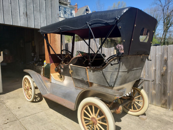

My father started fitting up sheet metal to my 1915 cut down touring project. Check out the accessory splash apron trim.

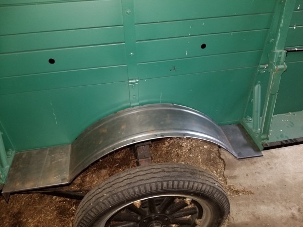

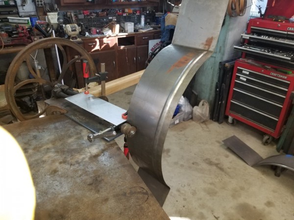

Still working on fenders for the 8in1 bed. 1st test fit tonight.
I need to get this done so I can get Tim Morshers 1867 tools back to him. Also Jim Sims loaned me the dies for the large bead on the top. Tim also loaned me an original Marti Parry fender for a pattern. Some great people in this hobby!

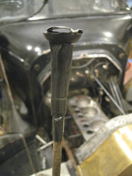

I didn't have a suitable tool for installing valve springs, so I set about making one.
It needs a little tweaking, but most of the time the springs don't pop out of it and go flying across the shop.
I finished it today and installed four springs before I ran out of time and had to go to town for groceries.

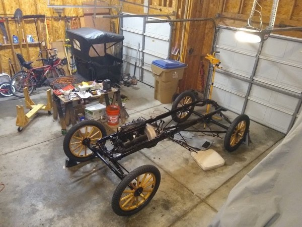

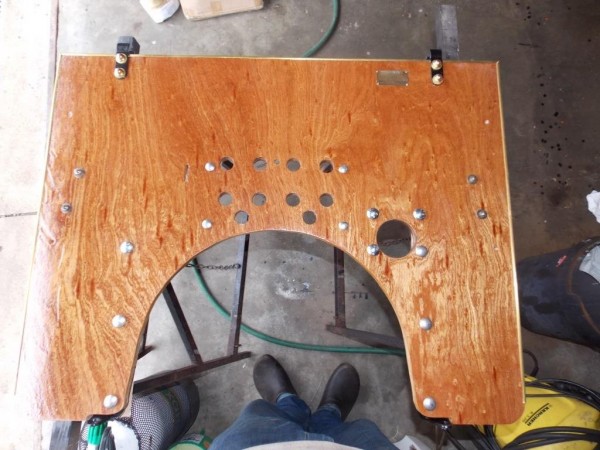

Have a laundry list of things to get done but will wait on that and fit up the "New" front and rear bumpers this weekend, Thank you Jeff Humble.

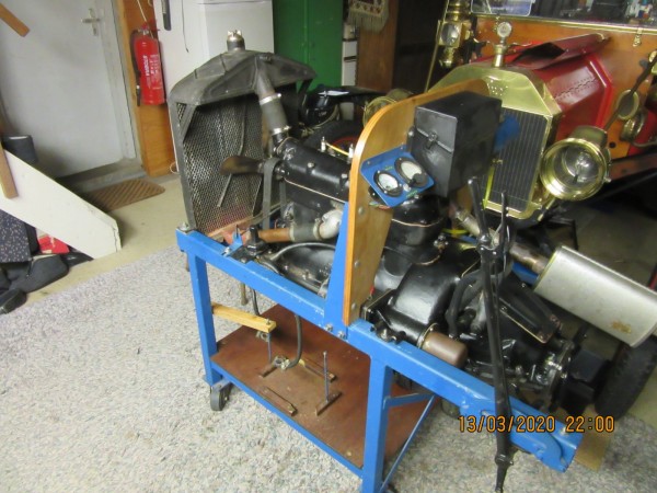

Yesterday I finised this 1923 engine ,and is now waiting for a test run

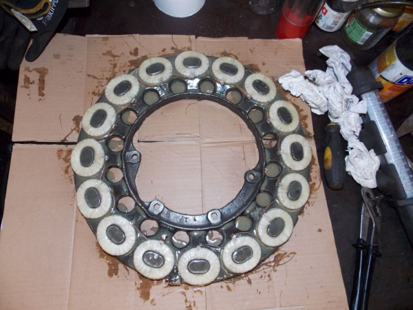

Started the rebuild of the magneto loop yesterday and finished it this morning.
Andre
Belgium
Andre
Belgium

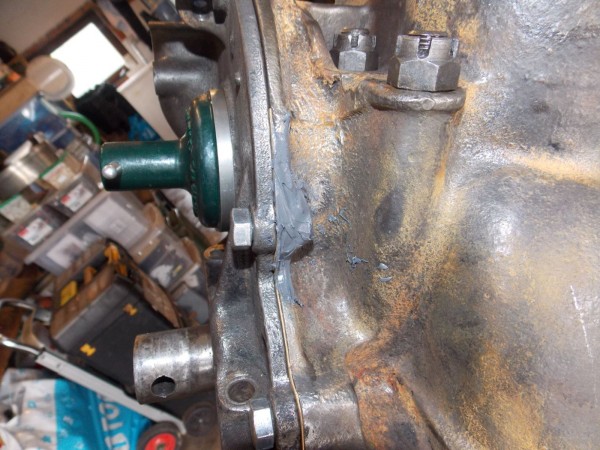

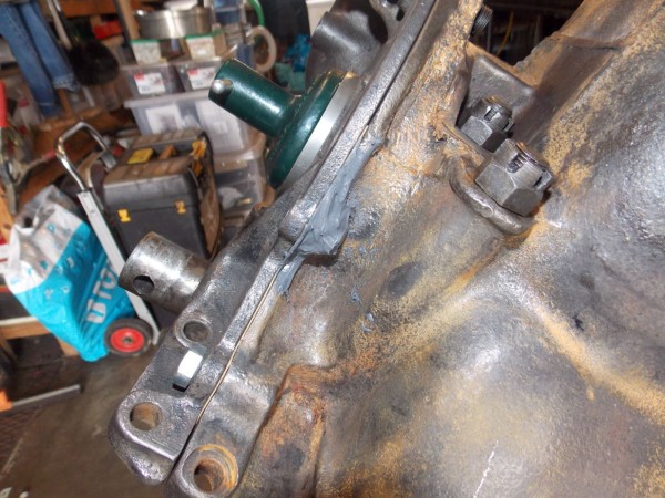

After the magneto loop I tried to repair the missing thread on the distribution cover.
Hope this is going well.
Will see in a few days when I start the reassembly of the engine and J&B weld will be hard out.
Andre
Belgium
Andre
Belgium

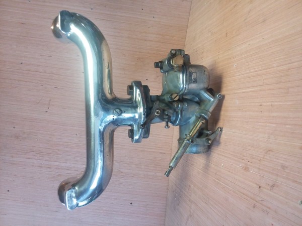

Removed and disassembled carburetor after a no-start and found no fuel at the bowl drain. The float valve is stuck, big-time. I'm trying to free it up. If I don't succeed by tomorrow, I'll order a new valve from Lang's.

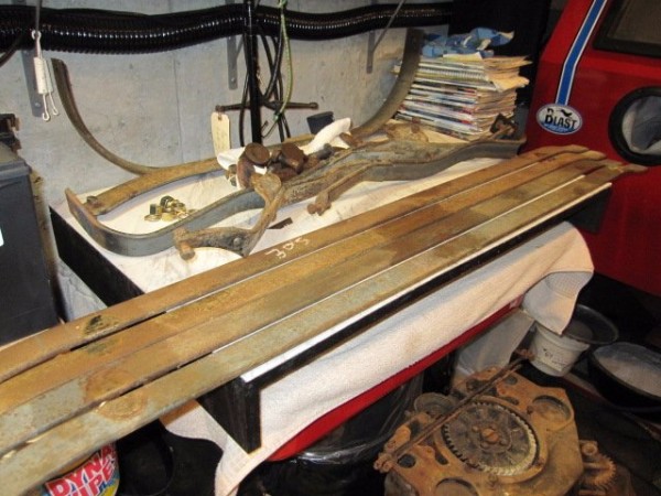

- Posts: 5464
Knocked the rivets out of 26/27 rear end center section. Tomorrow will press tube out in preparation to install a Ruckstell housing. Before installing need to check for length and straightness Snow and cold yesterday, today sun and wind!

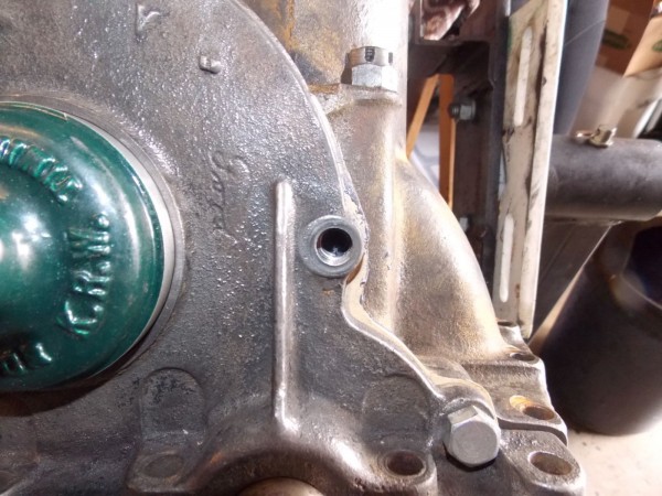

Pulled out the rear bearings, drilled and tapped a hole in the rear end for a drain plug. Greased the bearings up and got them reinstalled, only to find out I bought inner grease seals. Oh well, good practice for something I hope to never do again!

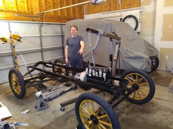

One of my sons helped me install the front wheels and engine in our 15 runabout restoration project. I am sure glad that he was able to help with this job. My hat off to anyone who's installed a T engine by themselves!

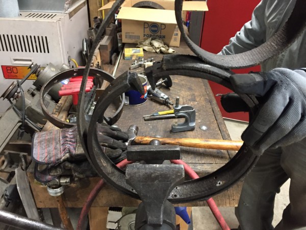

Ruxstel24
- Posts: 2351
- Last Name: Hanlon
- Location: NE Ohio

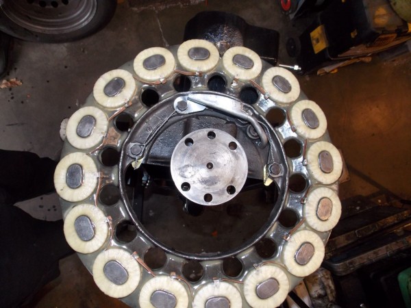

Relined the rear shoes today, found some nice lining in the stash of dad’s. I suppose a dose of asbestos beats a dose of COVID-19...
Starting to remember where I saw things over there.....occasionally
Bill had a rivet tool so I took everything over there and zip zip !!

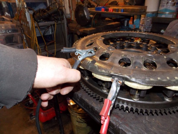

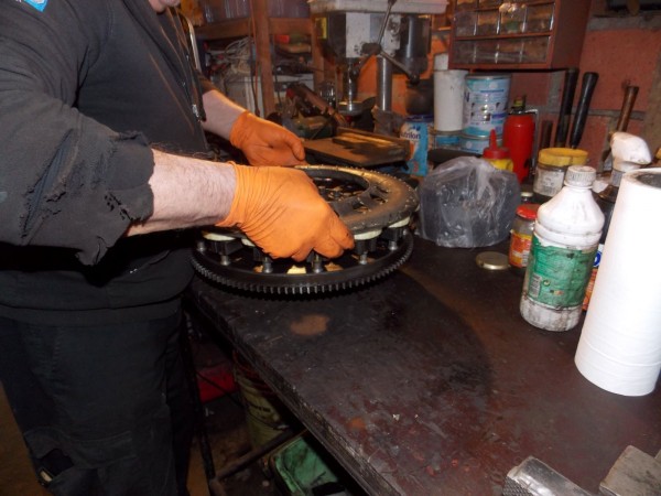

Started this morning by painting the engine for the 1915 touring.
Recharged the magnets on the flywheel and installed the magneto coil loop and the flywheel on the engine.
After the recharge I needed a prybar to separate the coil loop from the magnets.
After the reassemble the magneto test give 3.5Vac, turned the flywheel by hand.
Will go on tomorrow.
Andre
Belgium
Andre
Belgium

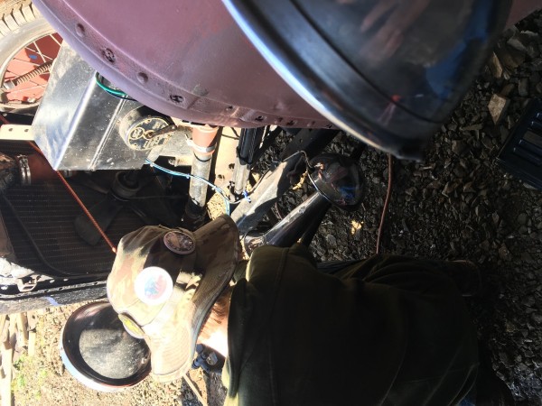

I installed the 1/2" copper line on my engine. The fitting was in the pan and hogs head when I got it but no line. The elbo in the hogs head would not clear when trying to thread it in. I used a coupling and short nipple to get it done. I also adjusted the reverse band one last time, hopefully. Not much but quallity time in the shop.

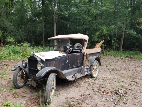

My weekend work has been cancelled as we limit contact with each other. Lots of motoring events I usually attend have been cancelled. This weekend I have used the time to make some progress on my 1916 pickup project. Very pleased with the new windshield frames and brackets from Langs. Our Australian supplier of frames has stopped producing so had to buy from the USA. Have been busy fixing brackets and hinges. Windshield supports rods are next. Lots of sanding and painting, then should be good to go. If this isolation keeps up, it will be finished in no time.

That truck is looking awesome! Nice work. Keep us posted on your progress.

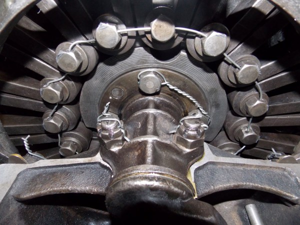

At the end of last week, I finished the reassembly of the engine for the 1915 touring. Yesterday morning, Sunday, I set the engine in the frame and in the afternoon I tried to make it running.
A few weeks ago I bought a few boxes with model T parts, in one of the boxes was a coil box with four great looking coils. At that time I thought they were Fun project coils and reserve them for the 1915 touring.

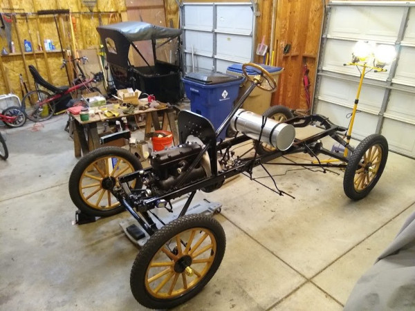

Finally got wheels on the ground and started mocking up th speedster

Normally we should have our last technical reunion of the winter season this afternoon at the model A club of the Netherlands in Bergambacht near to Rotterdam. Corana makes it not possible.
Thanks to Toon, Piet, Peter and all the others for the fine and learn full afternoons this winter. I watch out for next winter season starting the last Saturday of October.
Hope to meet you all on one of the rides during the Summer.

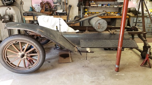

I finally reinstalled my rear assembly after a total rebuild and repaint. It was out for three months and I had to wait for warmer weather to paint. Otherwise, it would have been back in sooner.

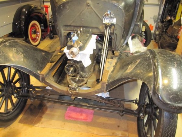

I got 4 of the valves back in. Halfway there! Ordered a new manifold gasket set from Lang's. I have a new head gasket already.
