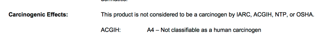

Whoa! I don’t see anything on my can of acetone or the MSDS indicating it is a carcinogen.
In any event, penetration of the skin is not a good thing, especially if one uses it to remove other substances on the hands.
MSDS
http://sds.chemtel.net/webclients/safar ... cetone.pdf
MSDS

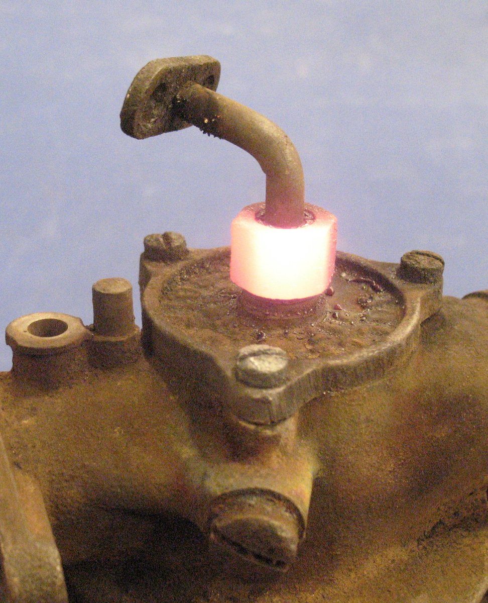

I swear by this stuff. Originally called "heat valve lube"....fondly called "panther pi$$" !!
Of course heat/quench, sometimes just heat.
