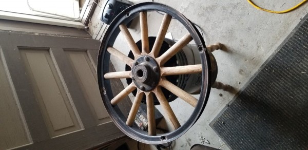

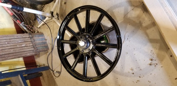

I started refinishing my wheels. Sanded down the wood and metal fellows and painted them black.

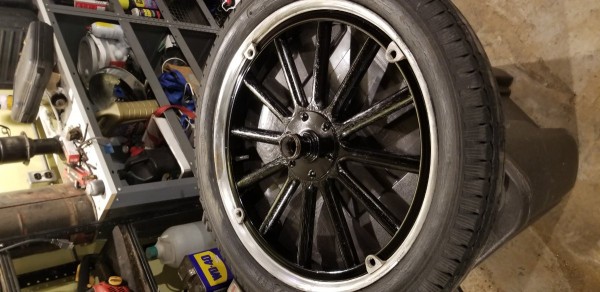

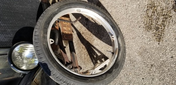

But then it came time to sand the Hayes wheels and prep them for paint. I was just going to paint them silver so they'd be uniform. But after sanding and cleaning, they are reeeeeeeeeaally shiny.
Is that how they were originally? There is a bad spot where the car sat that is a little rusty but the rest looks really good. Should I paint them silver? Is there something that matches original better? The car is a daily driver, just trying to make look a little better.

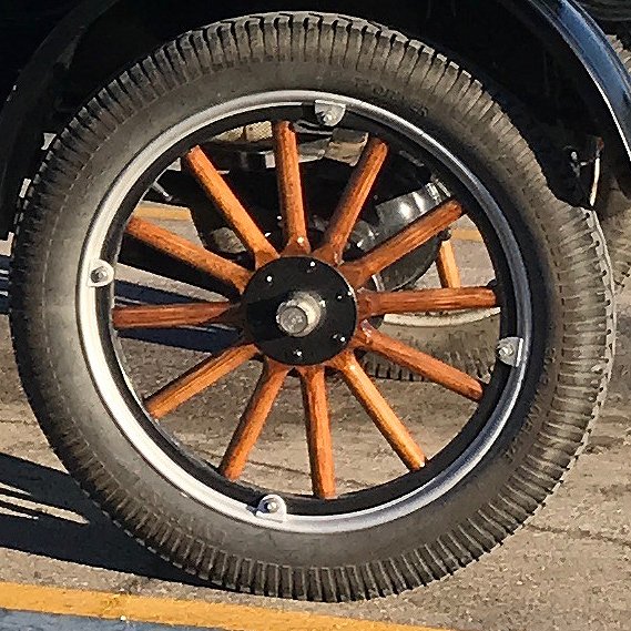

The rims were electro plated zinc originally. There is evidence that some were hot dip galvanised. These finished a Matt silver colour which darkened with age. The best colour match I have found is aluminised brush on paint. The brand here in Australia is Silvafrost.

I used a rustoleum silver paint. Holds well and looks good.

Rustoleum makes a "galvanoleum" spray that is a galvanized finish to it and it looks very close to hot dip galvanized when it dries. I've used it and like it but everyone has their own ideas on how something should look when finished.

I used Krylon aluminum. It’s sort of a dull silver color and not really bright. Looked good to me.

For now, I'm going to leave them the factory zinc until all 4 are done and I see how they all look. I may try and find some of that brush on stuff for some touch-ups. Rustoleum has clear reflective paint that I am considering spraying over the zinc to provide some protection as well as give me a little more safety at night. Has anyone used that product? Any comments?

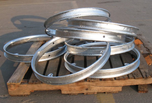

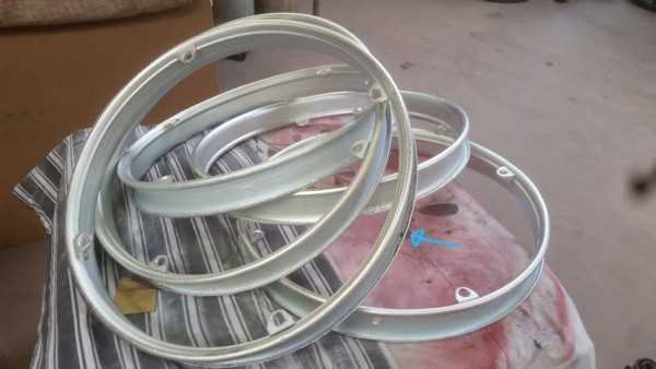

The best choice for rims is galvanizing. I had seven hot dipped eight years ago. When fresh they are shiny, and after a few years they are duller but the same color. I would not cover them with anything. My second choice would be Oklahoma chrome (Rustoleum aluminum rattle can).
Hot dip galvanized.

I agree with Steve on this - when we had the rims of the 20 done, we had them hot dipped, and they turned out absolutely gorgeous... plus when they "normalized" out from super shiny, they still looked good. The silver paint, IMO, is close, but not the same...

I'm gonna leave them they way they are after sanding. I think they look great, almost too good compared to the rest of the car.
