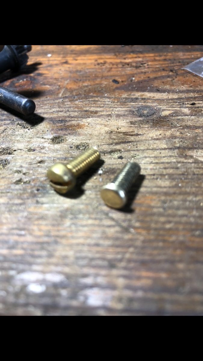

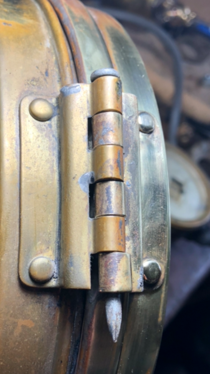

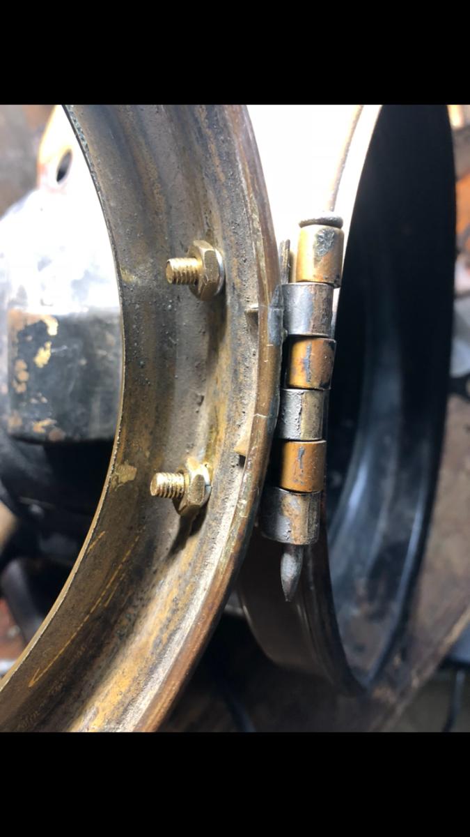

I made some of those threaded rivets for a headlight door, also reduced the size of carriage bolt heads on 4 bolts that hold the coil box on my 21. Easy to do with a drill and a bench grinder or a lathe if you have one.

Cory,
I like your idea. How to you get the nut tight?

Wow, that huge nail instead of the hinge pin looks factory to me. Lol. Actually a great idea On the threaded rivet and I learned something again today. Thank you. Frank
