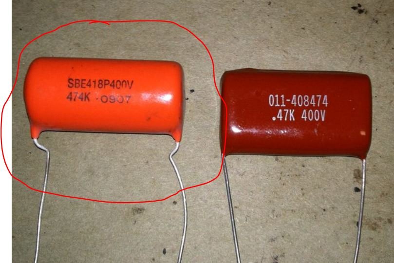

A couple of months ago I tried buying some capacitors to rebuild my spare coils. Lang's was out of stock then, with no idea when they'd get more. I called Snyders and I think that they said that they had "hundreds". They are the orange, rounder ones shown in the left on the photo. They are a little wider than the one on the right that Lang's had in stock. Anyway, at least you can get those kind if other places are also out of stock on the narrower kind.
jab35
- Posts: 1037
- Last Name: Bartsch
- Location: Dryden, NY 13053
Re: Coil capacitors
From an earlier post by John Regan, in reference to the two capacitors shown in NealW's post:
By John F. Regan on Tuesday, February 26, 2013 - 02:09 pm:
",,,,the capacitor that Snyder has pictured on his web site is the SBE type 418 cap and it is commonly called an "orange drop" capacitor and it is the same capacitor that Fun Projects sells as our part number 5007CAP and is the cap with the 900 dV/dT rating. The capacitor pictured above and marked 011-408474 is the capacitor Fun Projects sells as 5007CAP-HiD which is rated at 1700 dV/dT and is a bit smaller than the "orange drop" type capacitor that we have all used for years. The 011-408474 is "flatter" and thus leaves more room when nestled beside the coil winding. ,,,"
- Posts: 6804
Re: Coil capacitors
Either one pictured works fine. The one on the left generally requires the glass partition to be removed in order to fit. A little more work, but that's all. Buy and use with confidence.

Yep, that's what I had to do on the one "Ford" coil that I rebuilt a month or so ago. It was interesting to see the old, big condenser that got replaced with the orange capacitor. The others that I rebuilt were 1961 K-W's that had a smaller capacitor.The one on the left generally requires the glass partition to be removed in order to fit.

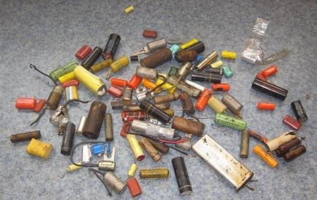

Ron Patterson
Re: Coil capacitors
I have been rebuilding Model T Ford ignition coils for over 30 Years.
I kept examples of the range of various replacement capacitors I found inside.
Many .047 U Farad caps, Metalized Mylar and electrolytics.
I seems that some felt size was the most important criteria when in reality the DV/DT rating was the critical factor.
Here is a picture of that archive.
Another funny thing is I found was rocks, gravel, body putty, newspaper, silicone spray foam and, believe it or not, cement used as re-potting material.
Ron Patterson
Ron Patterson
- Attachments
- Capacitor Archive 001.JPG (43.9 KiB) Viewed 8109 times

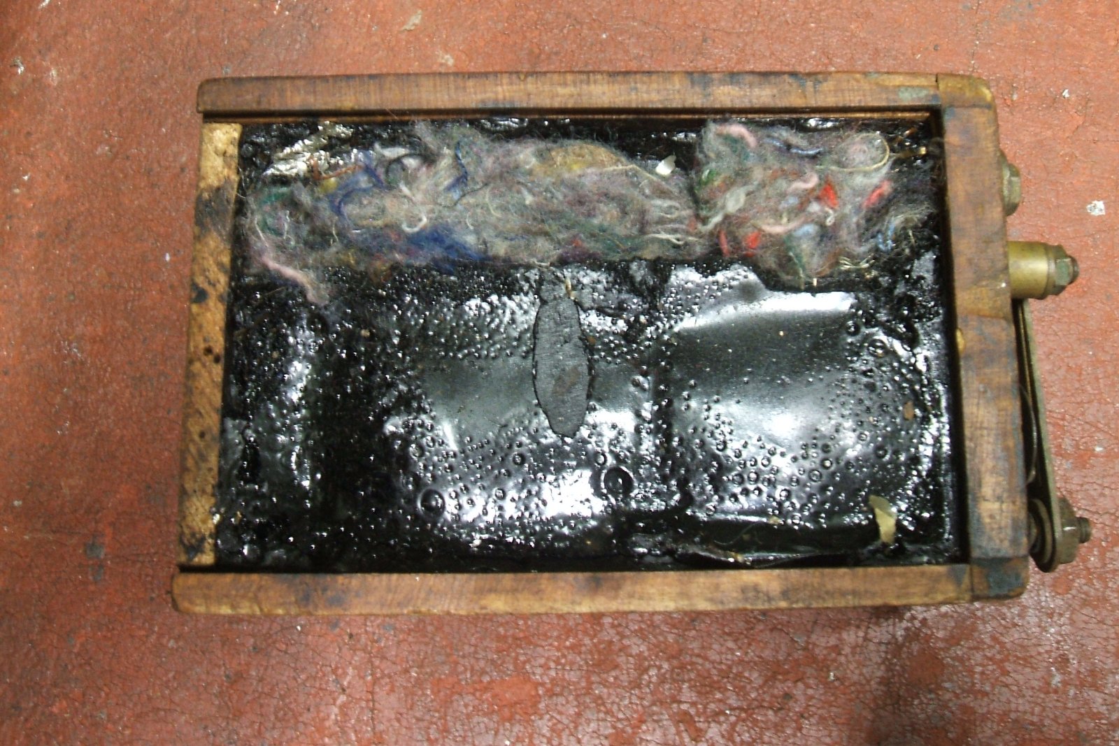

Just done a set of coils and found cotton waste as the 'potting' material.Ron Patterson wrote: ↑Sat Mar 14, 2020 6:14 pmAnother funny thing is I found was rocks, gravel, body putty, newspaper, silicone spray foam and, believe it or not, cement used as re-potting material.
