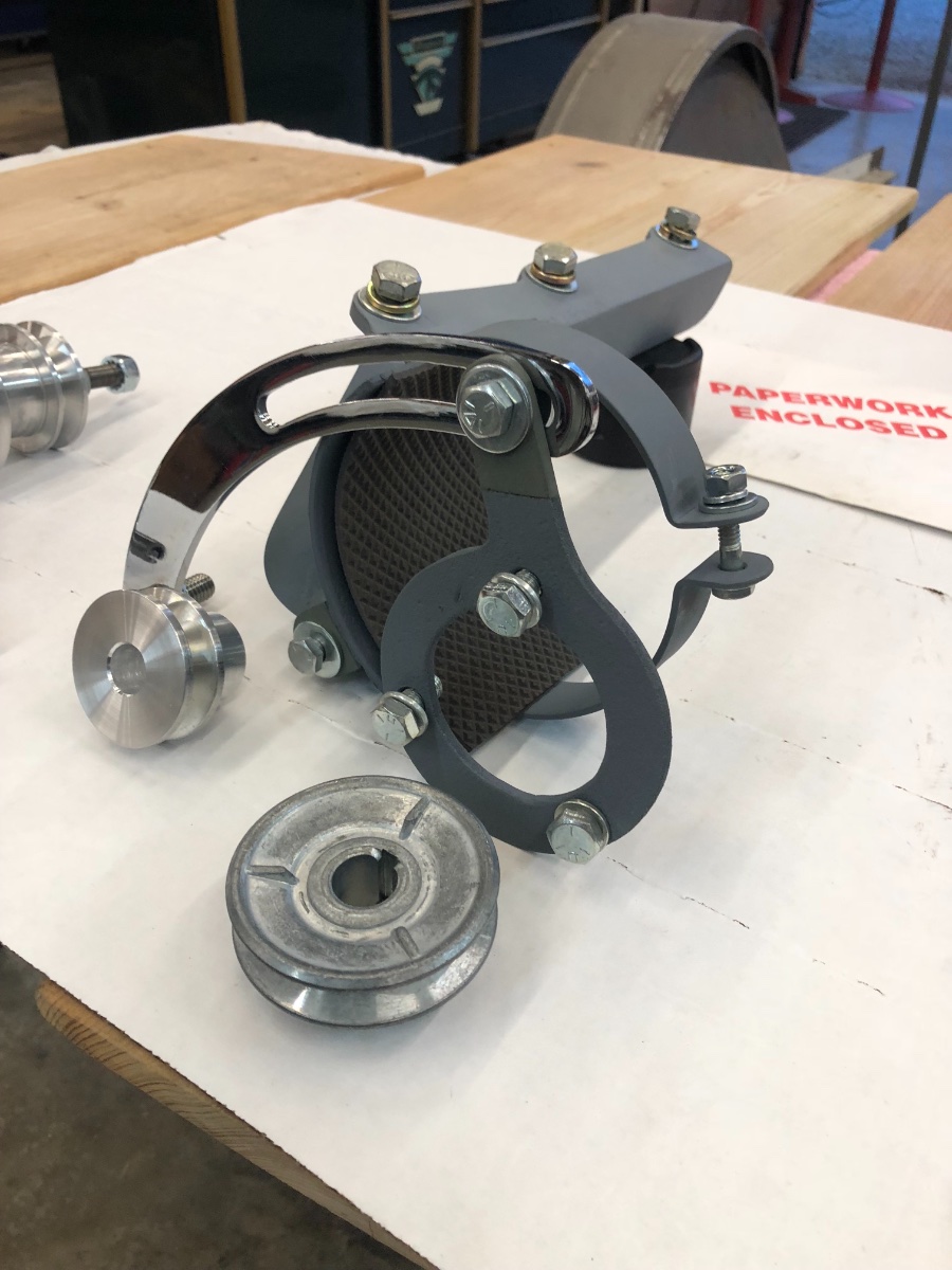

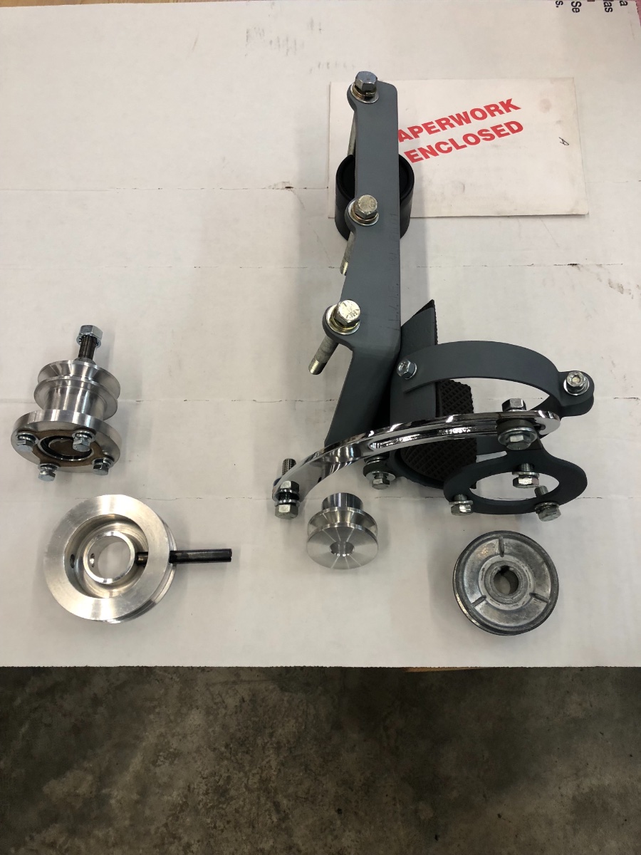

Re: What "Parts" would I need to install a starter on my 1915 Touring
If you wanted to add a generator to a non electric block, I have three of these available. Just bolts on.
Hope this Helps,
Hank
Hope this Helps,
Hank
