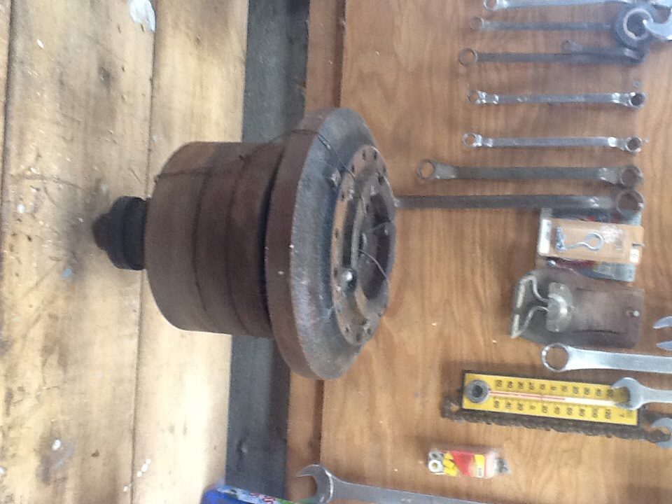

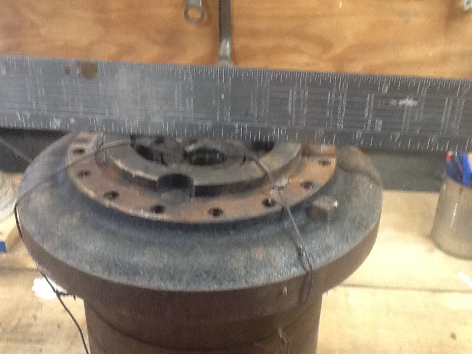

Chris I have a cut down fly wheel in the barn. I will try and get some photos and measurement and post them later today.
Fitz
Fitz

Re: Where & how much to lighten flywheel?
Here are two photo of my cut down flywheel. The diameter of the flywheel is about 10".
Fitz
Fitz
I LIKE IT!!!
But... do you have pics of the cut down magneto to go with it???
Kevin this all got when I bought my speedster.
Fitz
Fitz
Thanks for those pics Ralph. That is quite the flywheel — gonna be tough to mount my magnets though...
