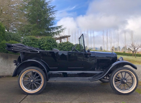

I have a question regarding "numbers-matching" cars. Here is the situation:
I purchased a nice '26 Touring car. It's an older restoration that shows a little age here and there, but is very straight and wearing shiny black paint that presents really well. It's just a very solid and honest car that has spent it's life with a series of long-term, caring owners. Through the process of inspecting the numbers on the car vs the number on the title, I discovered that the chassis number and the engine number match one another (and the title of course)
I guess my question is, in 2020, almost 100 years after the fact, is it as rare/odd as I think it is that this car still has it's original engine and chassis? It just seems like over that period of time, so many things could have happened that would have resulted in the engine being replaced, or similar. After all, for a long time, these were "just cars", tools really.
Are there a lot of cars like this still floating around/available today? And does "numbers matching" impact the value of a Model T in any real way? (I will be selling the car) Or is it more a matter of "oh that's neat that those match" and that's about it?
Are there a lot of guys with similar cars here on this site?
I'm mostly just curious as I don't "live" specifically in the Model T world. I have had a few, but am mostly interested in early V8 stuff, especially 36 Ford. I'm still learning the nuances of the world of Model T's as I go along, there certainly is a lot to know.
For reference, here is the car I purchased, hope you like it:

Model Ts are not Corvettes. The only matching numbers need to be the title and either a DMV-applied VIN, or the engine. My opinion, and it is only an opinion, is that matching numbers on a T lends very little value. Earlier cars in facr, had no frame number, so the "matching numbers" thing is moot. Yes, lots of cars got engine swaps, but remember, there were 15 million made. Some just came through intact. Also consider that by the time this car was made, it was extremely behind the automotive curve and obsolete the day it was designed. I think an awful lot of the later cars did not necessarily see the service necessary to wear out an engine to destruction. Yours is a fortunate survivor that has been loved and taken care of for its life and I expect that will continue.
That is a very nice looking car. Welcome to the hobby.
