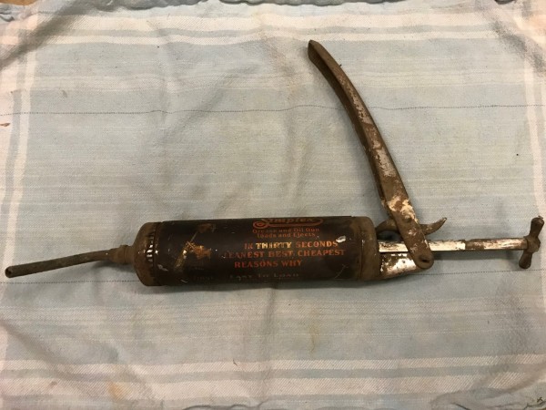

The type that would be common to T era would have the screw type plunger and non flexible tube. While some have updated some of their grease fittings to Alemite, they would not be correct for Model T's.

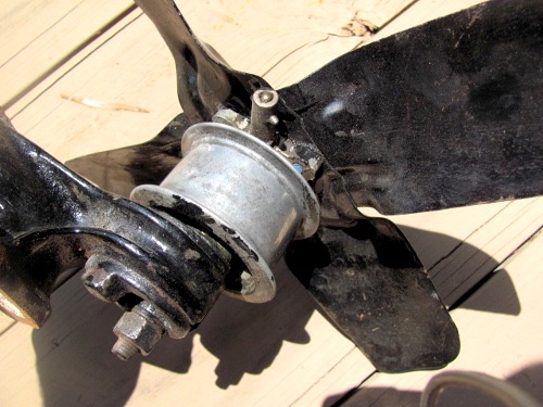

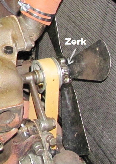

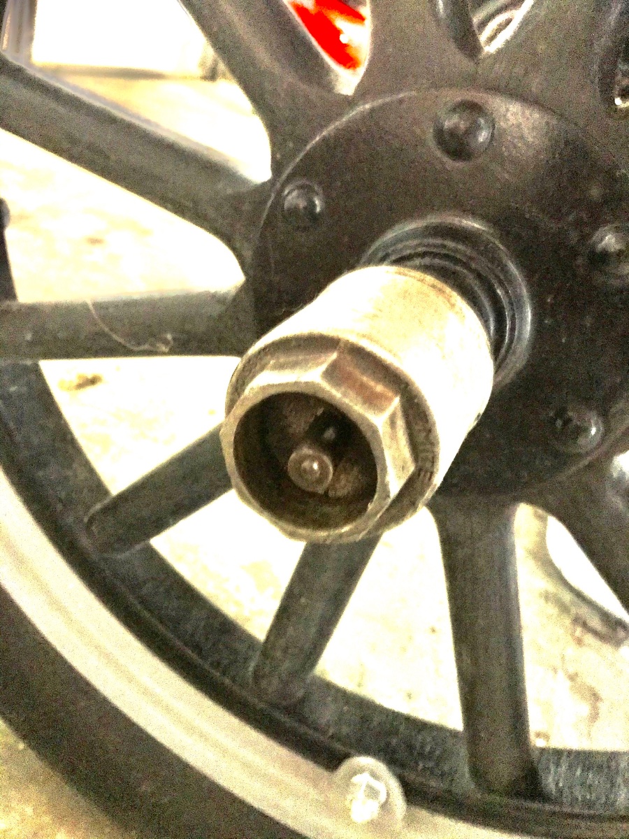

Some T's were retro fitted with Alemite pin type, during the period of hand grease guns, example is this fan pulley hub!
Then today the more modern style Zerk can serve this spot as well.

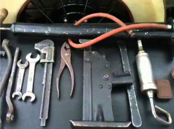

Thanks, Dan, Almost every T tool kit that I see has a grease gun, so I thought they were standard, or at least, optional equipment. I knew Ford used flip up oil cups on everything, so I should have realized that they was no need for a grease gun.

Terry
The A kits came with the grease gun, this kit is appropriate for an 1928 Model A

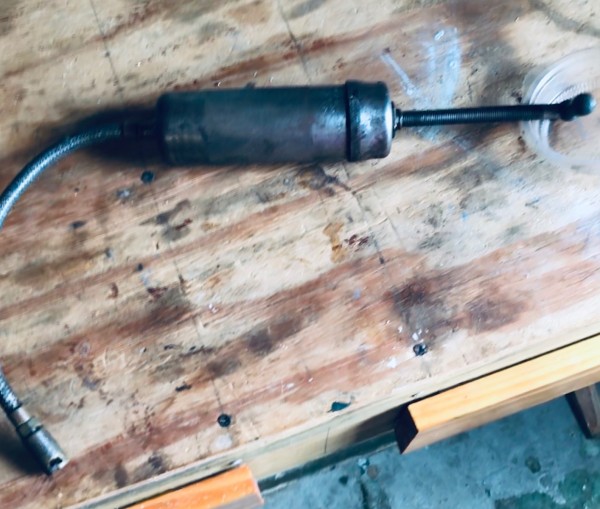

As an example....my ‘19 hack came to me with Alemite aluminum aftermarket hub caps on fronts.
While I’d agree that the screw type squirt gun is maybe more period correct, my choice is the screw type with braided feed line...to me it’s just way cool!
