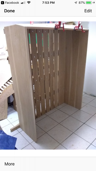

I am building a 15 model T based ALF fire truck and the bed is made of white oak. I was told today that white oak is difficult to get paint to adhere too. Any truth to this? Any one have experience painting white oak?This is a picture of the hose bed on it end. Thanks!

It should take paint fine. Start with a good primer.
